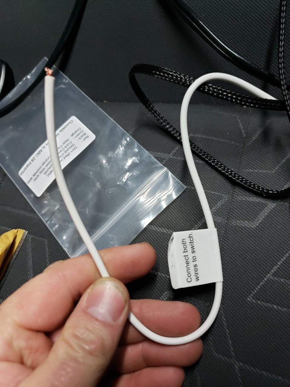

    Need help so I have the anytime back up camera and got most of it hooked up but my kit came with a thick white wire that on one side says nav and on the other side connect both wires to switch what switch

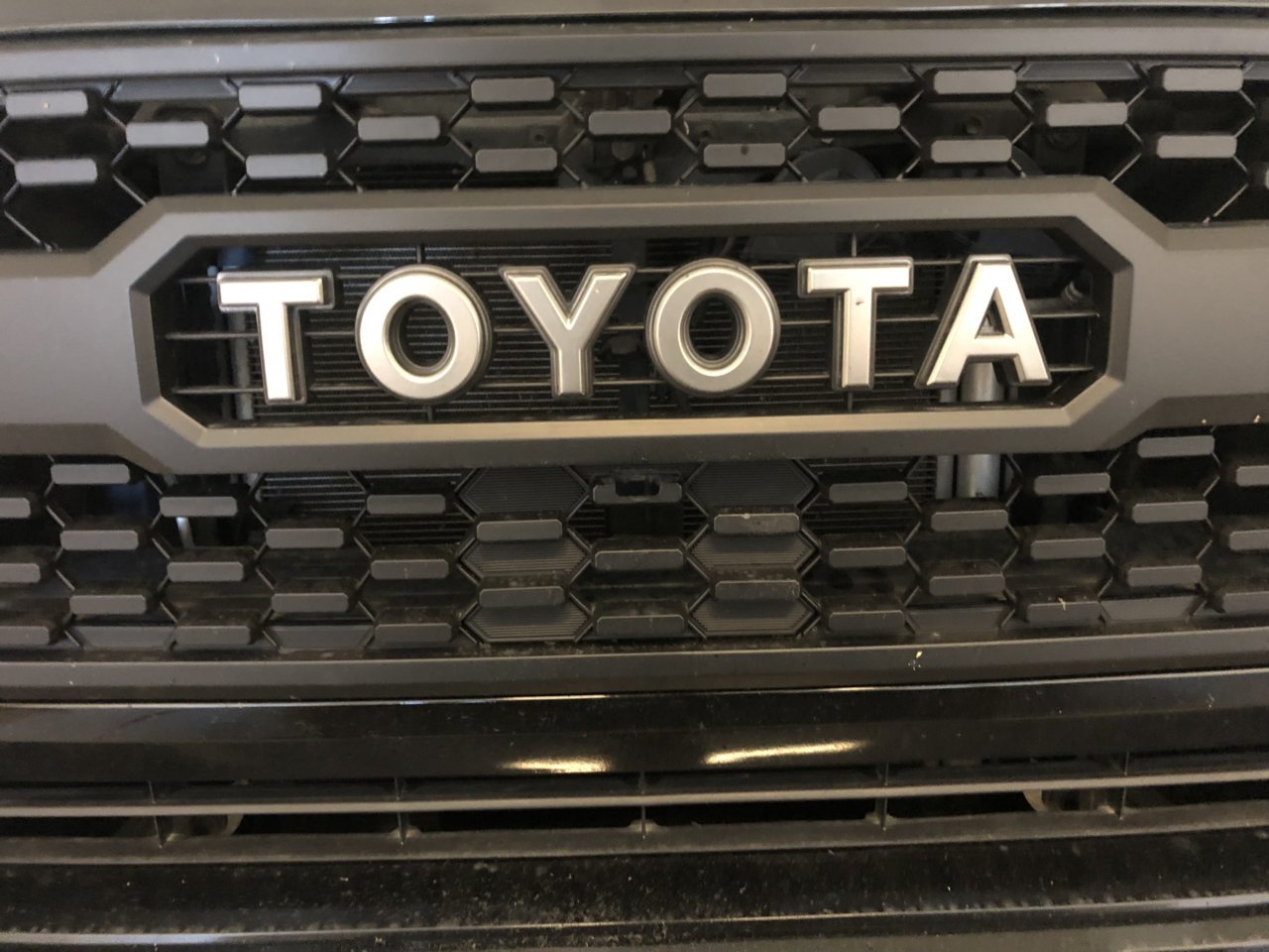

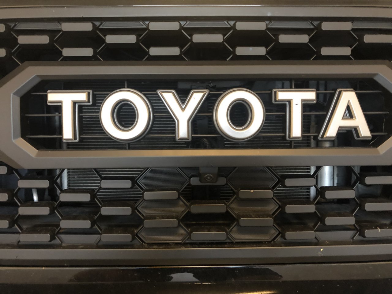

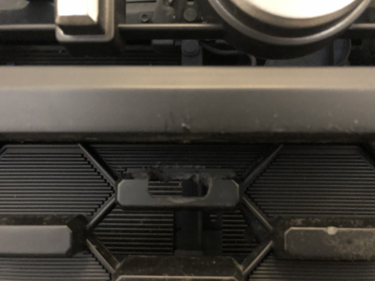

    Got mine installed today! As others have stated, getting the wire through the firewall was a real bitch. Tight working area and you just need to be pretty aggressive with it. Also stole some inspiration from a fellow member as my OCD made me take a dremmel to the TRD pro grill to occomidate the front camera in the center. Couldn’t live with installing it off-center lol. Since the grille was only $75, this gave me more confidence. Also could have just bought a flush radar sensor cover, but that’s less fun.

    Looks good but now it makes me wonder where people are putting the camera with the sensor plate. I'm one that has to have it perfect. Lol

    If you have a sensor plate, I bet it can go over it without affecting the sensor.

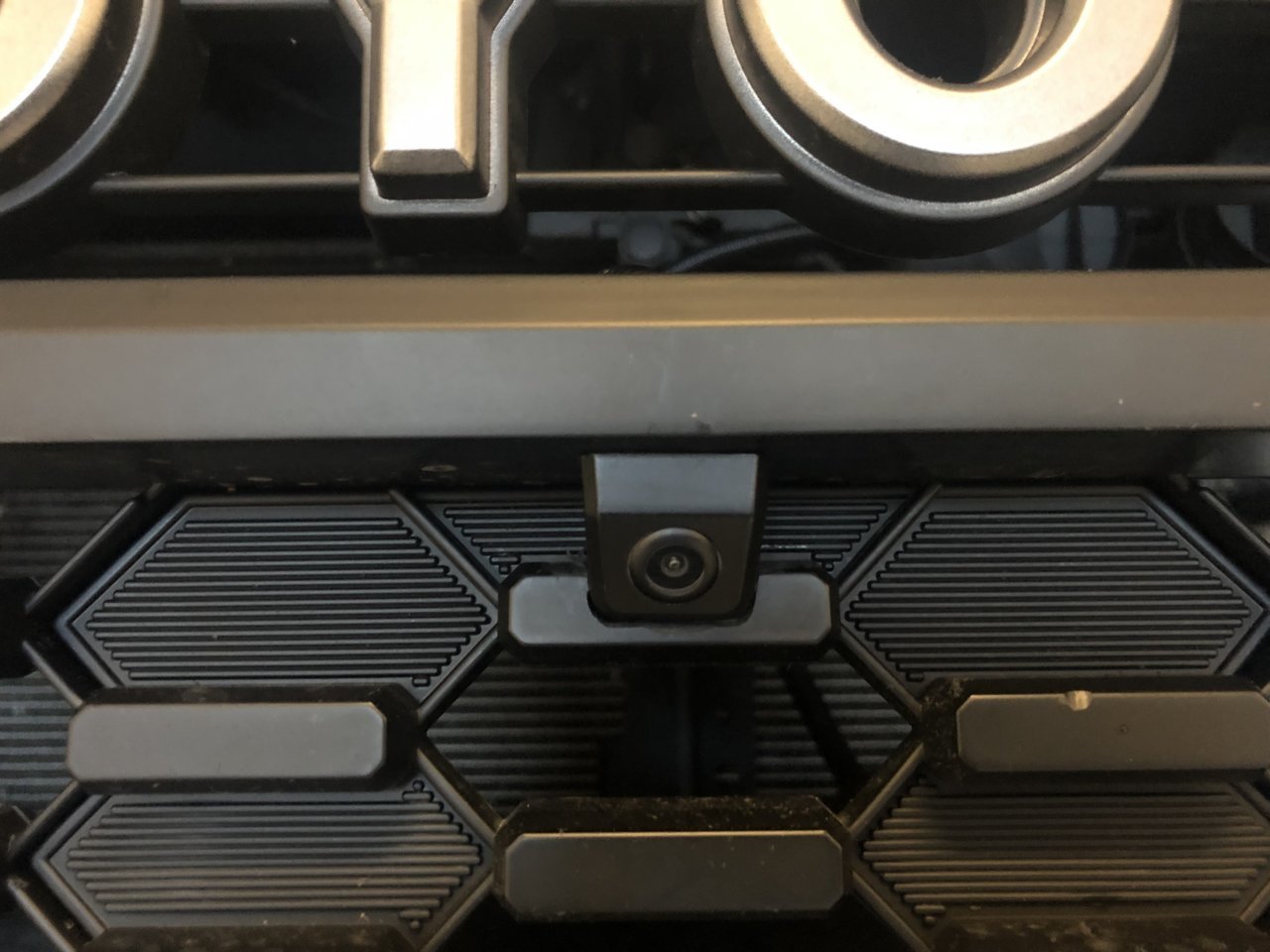

    2018 TRDOR Cement DCSB. 1980 FJ40. 1978 FJ40
    This is what I did. Works fine, no issues.

  17. Apr 8, 2019 at 11:56 AM
    #1137
    porterx
    porterx Well-Known Member
    Dec 3, 2018
    #274643
    389
    Can you post a pick of the camera? TIA.

    #1138
    cruiserhead
    cruiserhead Well-Known Member
    Mar 6, 2017
    #212467
    536
    Curtice
    Sure. Won’t be for a day or two. Out of town.

    #1140
    cruiserhead
    Mar 6, 2017
    #212467
    536
    Curtice
    Here you go.
