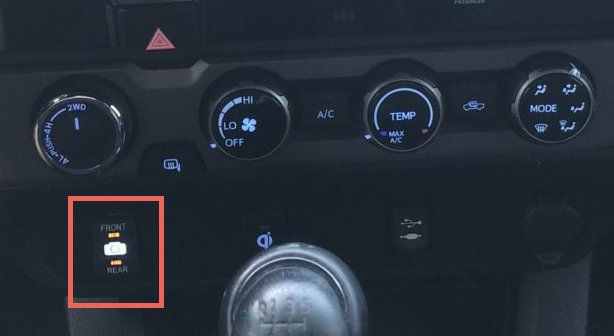

    Anyone know how to dim the camera switch when the lights aren't on? It's always backlit. (I know the lights are on in the pic)

    I dont think you can. That particular switch is connected straight to 12v power and not to an existing parking light circuit. I think its even on during the day.

    You can get some switches that have separate illumination control, but they will still light up whenever you go into reverse.

    Connect the ground wire of the switch to dimmer ground in the dash. The switch has a resistor built in that sets max brightness so if you don't want to mess with the dash wiring you could either swap that resistor out or put another 1/4w 10k inline on red2 or black.

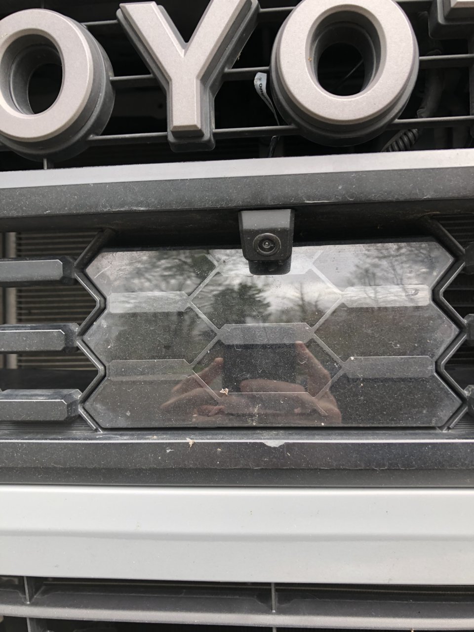

    What camera did you use for this setup? Pic?
    porterx[QUOTED] likes this.
  20. Apr 14, 2019 at 11:46 AM
    #1160
    porterx
    porterx Well-Known Member
    Dec 3, 2018
    #274643
    296
    I think it was the Car Rover but Amazon has quit selling it. Just get one that mounts like you want and has the yellow rca video out and + and - power wires out. And get a decent resolution. Mine is either 420 or 520 lines of resolution and it's fine. If the wiring isn't long enough, you can always extend them. I had to extend my power wires.
    This is the style of camera I have.
    https://www.amazon.com/dp/B018800TR2
