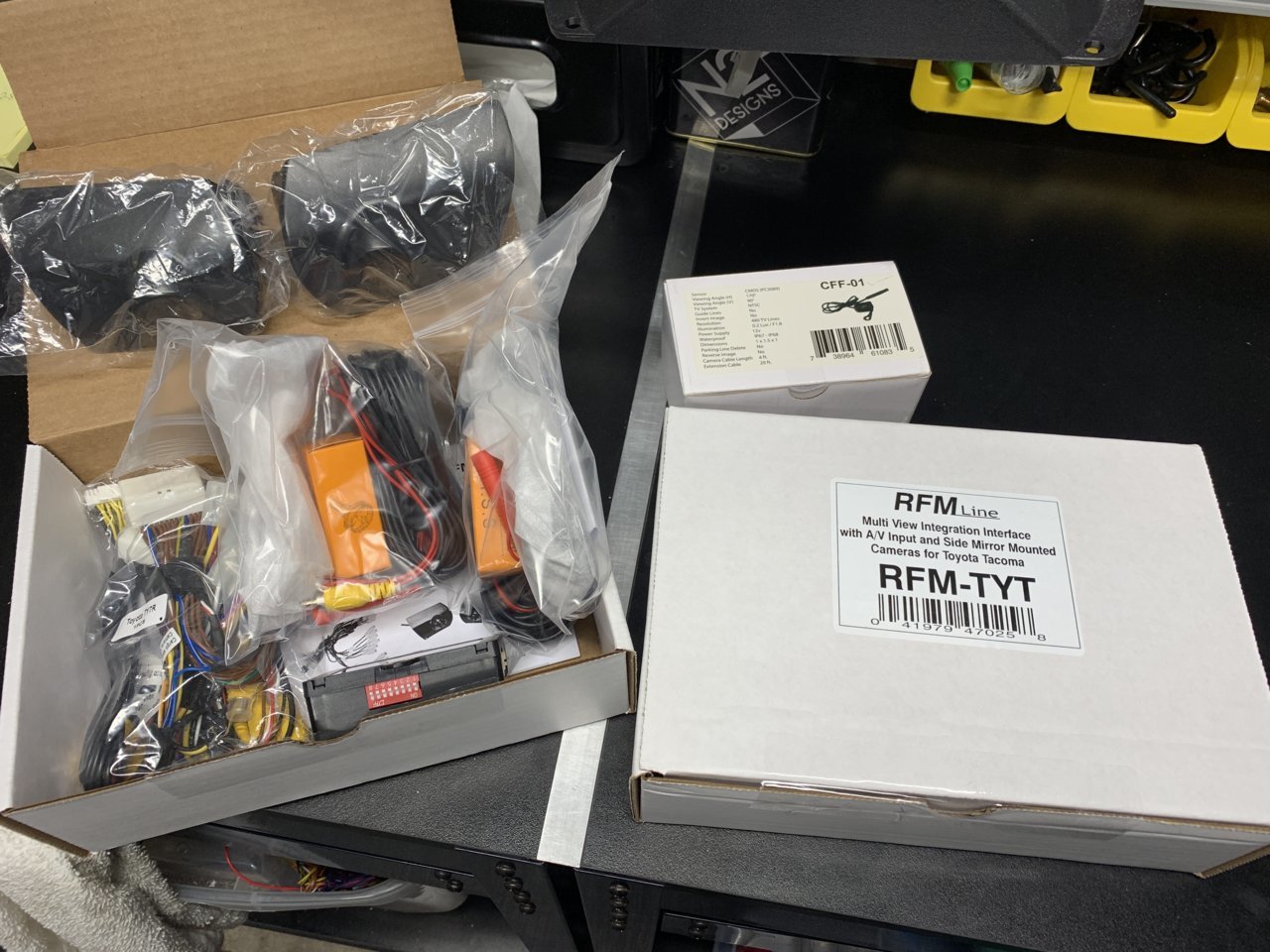

    I'm a dealer for CRUX. I can get these at a lower price than any online advertised. I personally have two on the way, one for me, one for another forum member. PM me if interested!

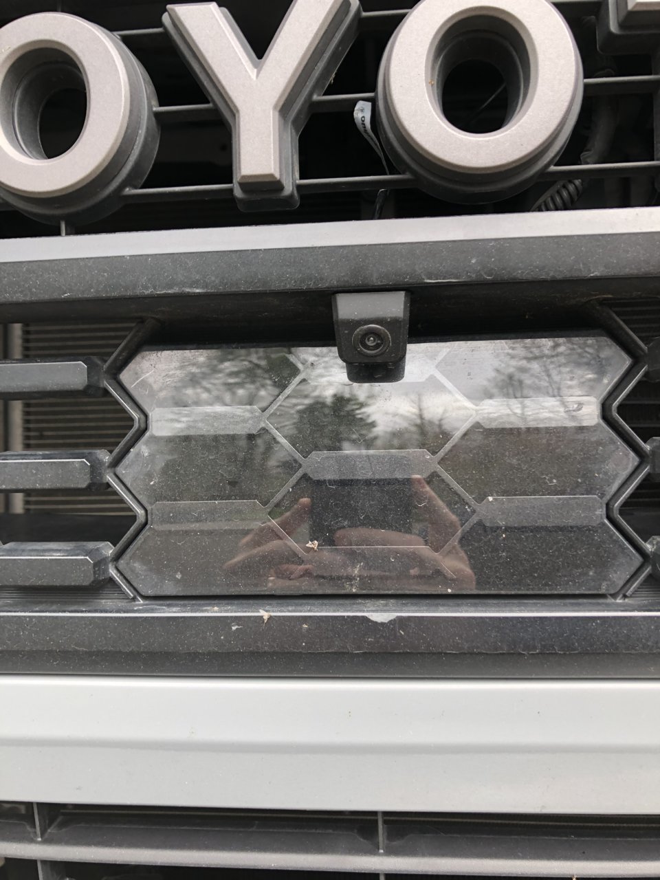

    Oops just realized you said stock. I’ll leave the pic anyway in case it helps someone.

    I have access as a dealer but since I focus on remote starters and automation & control via smart phone, I don’t have it listed on my website, it’s a part of the secret menu of all things tech and electronics I have access to as a authorized dealer for tech products...if enough interest I may list it on our website but it would be a non stock item, special order only so lead time would be about a week if in stock at the warehouse. $399

    I don’t have the anytime kit, but I think it’s the same sized camera. Install requires a dremel to make an opening big enough on chicken wire to fit the camera. Only additional supplies are a bit of aluminum sheet and epoxy.
