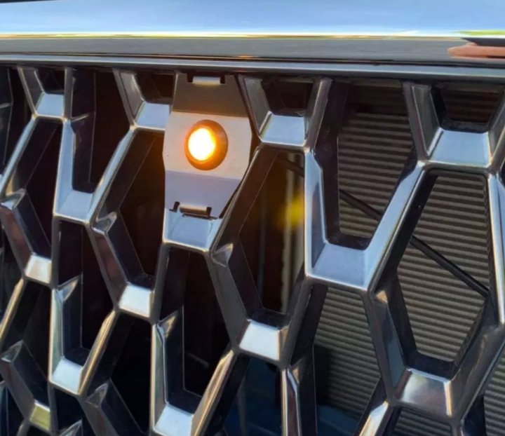

    using this camera: https://www.amazon.com/NATIKA-Backu...ronics&sprefix=natika+,electronics,152&sr=1-3
    the camera has 3 wires that you can leave or snip. one flips the image for front vs. backup cam, one keeps/removes the grid line, one flips the mounting from vertical vs. horizontal.
    this was my first attempt (ended up buying another grill and starting over), but it will give you an idea of what i did. the grill i used has a bit more of the "chicken wire" dremeled out in the front, so the plate sits a little more forward and is a bit more imbedded in the grill.
    if i could do it again, i'd make the plate a little bigger and mount it a bit higher up. i was a little concerned about having to take too much material out of the grill, but i don't think it would have mattered considering the amount of epoxy i used to fill in the back of the grill.

    Yotaleds.com has some brackets for this grill & the Pro grill to mount LED's that are similar to this. Think I'm gonna contact them to see if I can get just the brackets only to mount a camera. Here's a pic from their site

    my first mock up was a similar mount on the face of the grill, but i didn't like how much the camera stuck out.

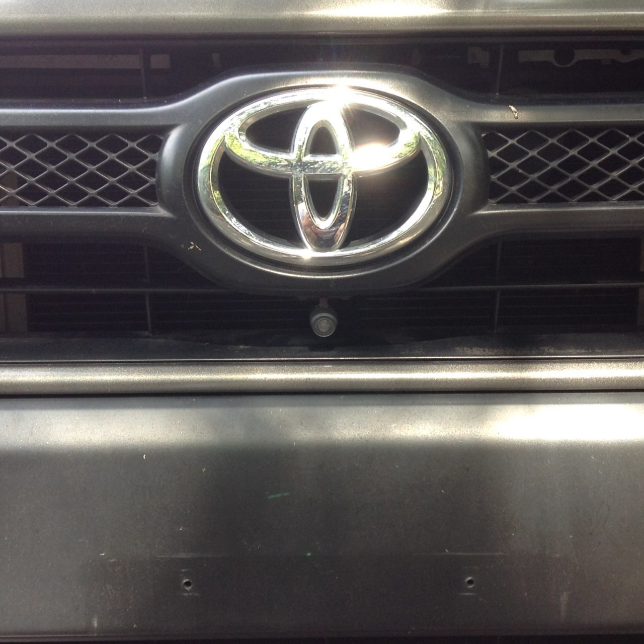

    Anytimebackupcamera refunded me $19 for the camera. So I'm in the market for and aftermarket camera. On that note I'm also curious where folks have mounted there's with the CBI bumper with front bar? This is my trucks https://imgur.com/a/XoTWEFW and with the camera that comes with it I have it mounted just below the Toyota on the pro grill but bc of the camera angle and the front bar on the bumper I am missing about 20% of the top of the screen which looks outward. I would like to have a camera that looks more out as opposed to down if possible.

    do u have a pic of where you mounted it?

    Not until tomorrow morning I don't. I'm doing a satoshi mod with abs hex grill material so it wil end up being the upper version of the mount in a centered hex that's been filled in with abs but for now it's the lower one set just off center because of the 2nd gen grill has a vert dead center. Still a long ways from installing the new grill, have to learn how to heat bend abs.
