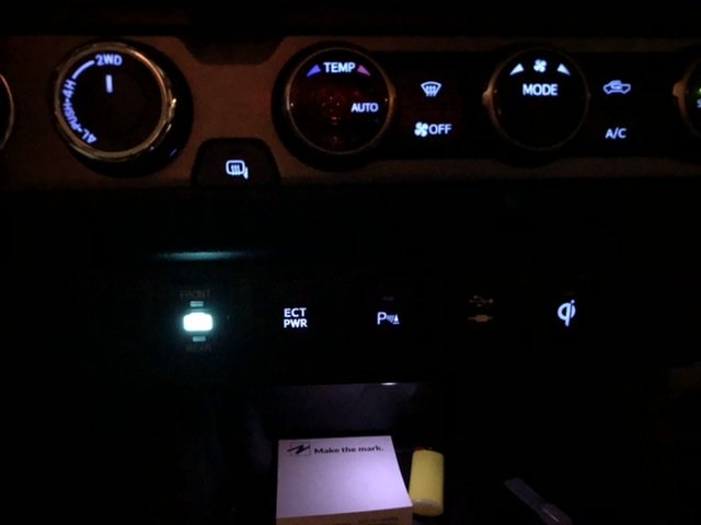

    Anyone find a fix for the discoloration of the switch light?

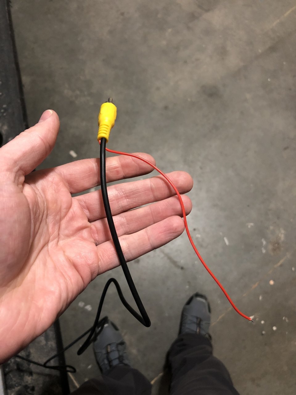

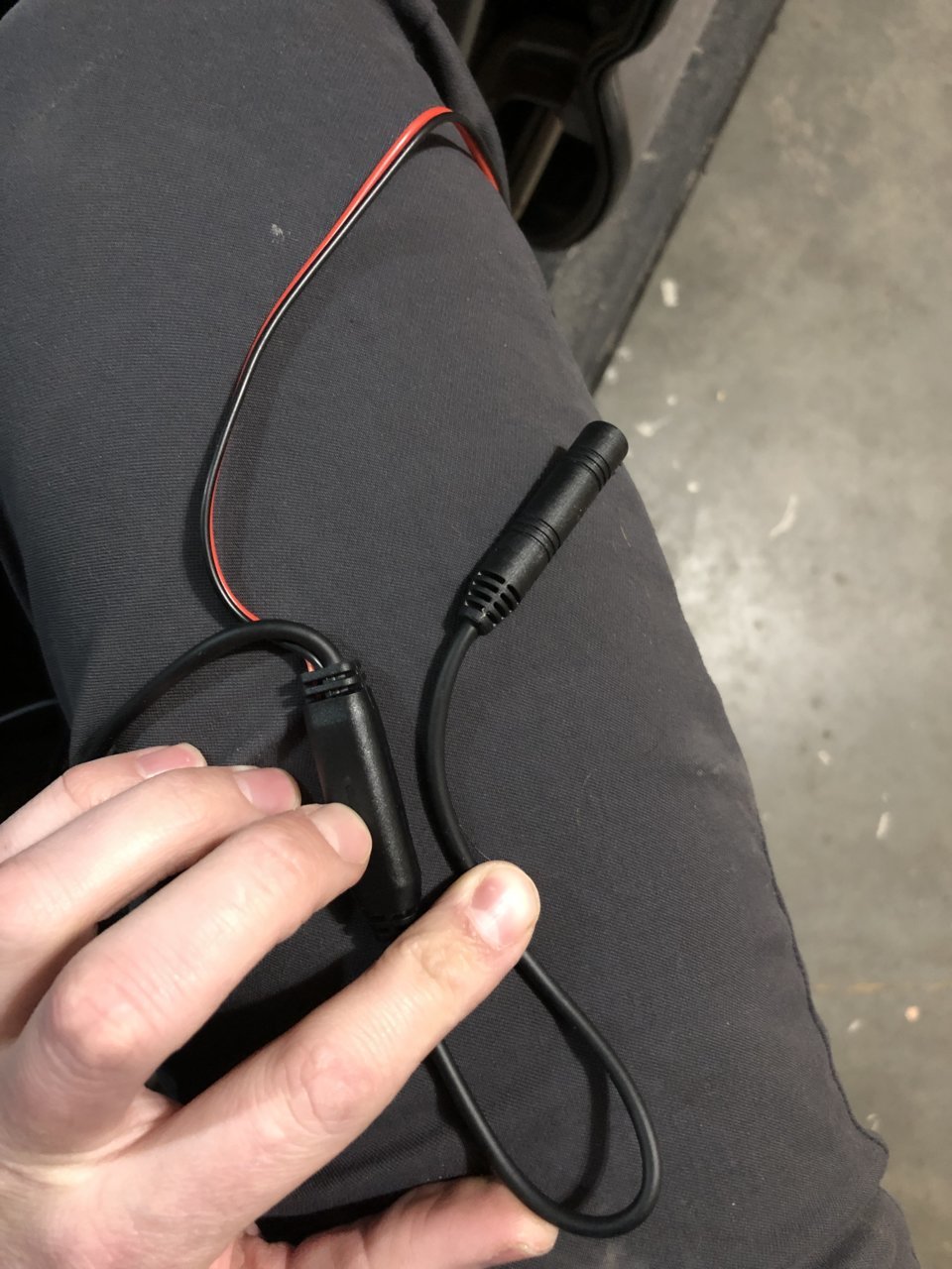

    I got the anytimebackupcamera kit without camera. Within the front camera and I am a little confused on where to source power. I have the natika Amazon camera. At the RCA male end of the camera line there is a little red wire that comes out of it. Or at the female end where it plugs into the front cam there are two wires. One black the other red. Can the red wires be used interchangeably?

    And also I power source the front camera off the back of the switch?

    Got it all figured out. I guess this kit the anytimebackupcamera Front and rear only works when the engine is running. If truck is on with no engine then it will only display the rear camera. If truck has engine going then it will display the front camera and rear camera according to the switch. I spent to much time double checking all the wiring feeling defeated and went to move the truck and tried it out again with engine running this time to find it working. Felt pretty stupid considering I neglected my family tonight chasing correct wiring.

    Totally get it. I think that would juice it too much. I powered mine using a piggy back fuse tap and connecting into the fuse box in the cab, but you could totally just tap it into the fuse box in the engine compartment.
