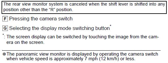

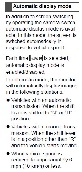

    If you read the owner's manual, you'll get a better understanding of the camera view requirements n settings. An example is that even if you select auto view, if you increase speed more than 12 mph then you loose front camera.

    That makes sense. It does drop the front camera (and the side/rear camera) in "view button" mode after I reach a speed over 12 mph like you stated. I'll hang back and see if someone with more (better) electrical knowledge than me to come along and find a solution to this. Thank you for getting back with me and helping me understand.

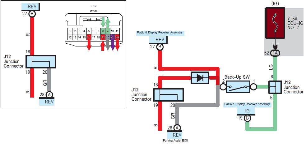

    This what you have on the 2020...
    And could do yourself...

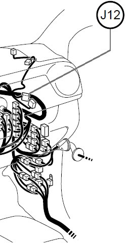

    Remove Negative terminal of the vehicle battery and wait a few...
    Identify the connector. (J12) Under passenger's dash tweeter. But better to access it removing the glovebox.
    Identify the wire location and color. Red slot 16 and Dark Gray slot 20
    Cut, strip, crimp matching connectors on either ends. x2
    Identify fused power(J12) pin 5 or 9. T-tap it.
    Get diode and a on-off switch. Follow diagram...
    Or wait for a Youtube video....:D
