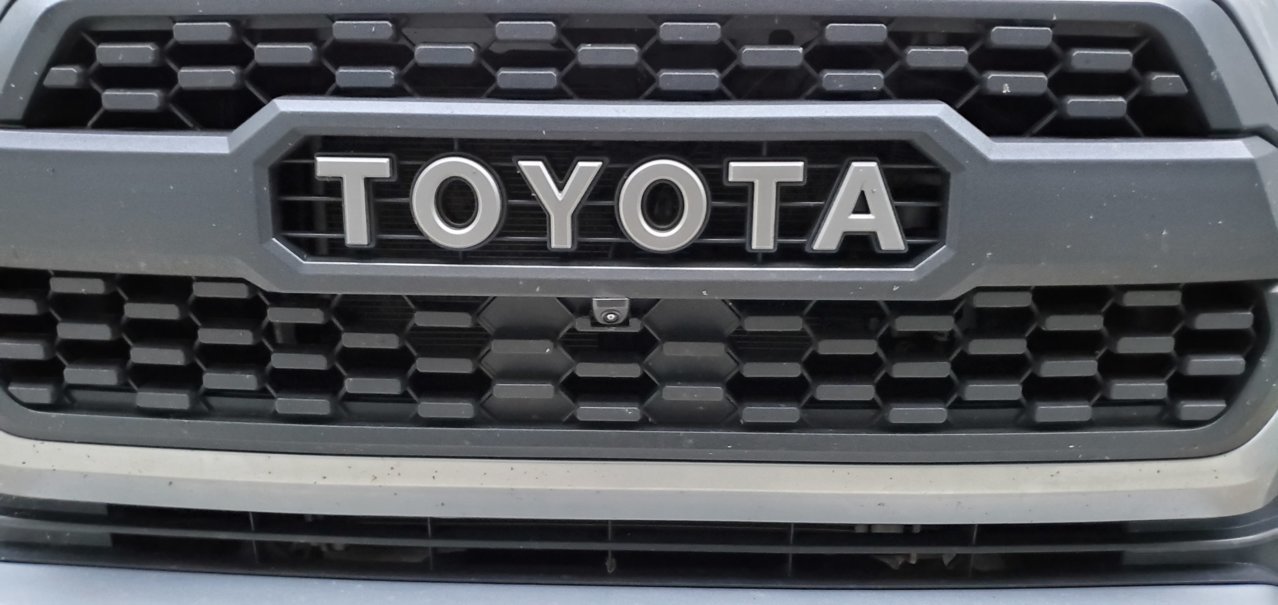

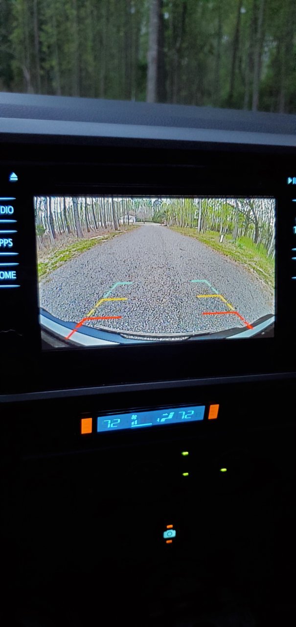

    After more than half a year of sitting on the workbench shelf, I got the harness and front camera mounted and setup...20200412_193826.jpg 20200412_193643.jpg
