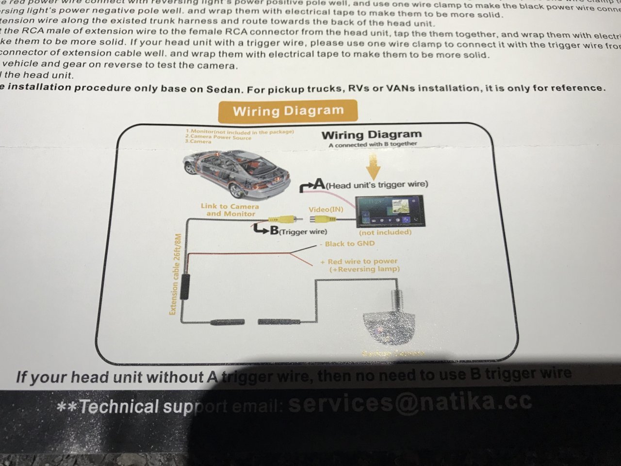

    I can’t get my front camera to work, just a black screen. Do I need to connect 12V to the red wire that’s bundled with the front camera Yellow RCA? I thought that wasn’t used.

    Anyone have a picture of where the grey and Blue wires go on the switch plug? I de-pinned the connector thinking they weren’t used... only to find out that they are used. The instructions on the anytime camera website suck.

    Natika calls that red wire the “trigger wire”. I guess I just need to know where the trigger wire connects

    Why does Natika call this red wire the “trigger wire” it doesn’t say in the Natika instructions to connect that red wire to power...

    It seems all the cameras are coming with the option to use the red wire embedded in the video cable to power the camera. Calling it a "trigger" is just the term they use instead of "power" or "+" feed.

    I don’t know, definitely doesn’t look like a power wire in the instructions... are you positive?

    It is either to feed power to the camera.
    Yes, diagram is confusing. I happen to have a camera on my desk. It is not a Natika but I think they all work on the same principal to feed power to them.
    I assume you are running an aftermarket HU then? Does the HU have a trigger wire for adding a front camera or are you powering directly so the camera remains on at all times?
