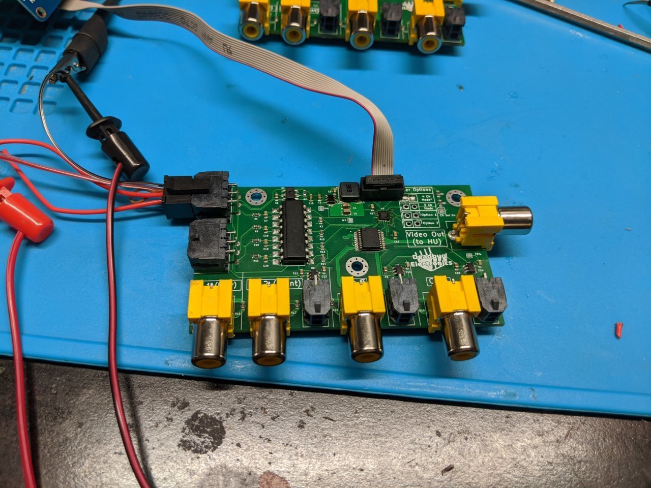

    I'm bench testing the camera right now that I have for the back of my camper that will be connected to my factory HU through utilizing the same ABC switch but with a video switcher in line. All the cameras I believe are wired the same.

    Yup. That is why I have bench tested this 4x camera input I'm working on before install.

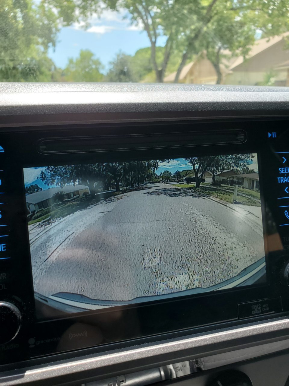

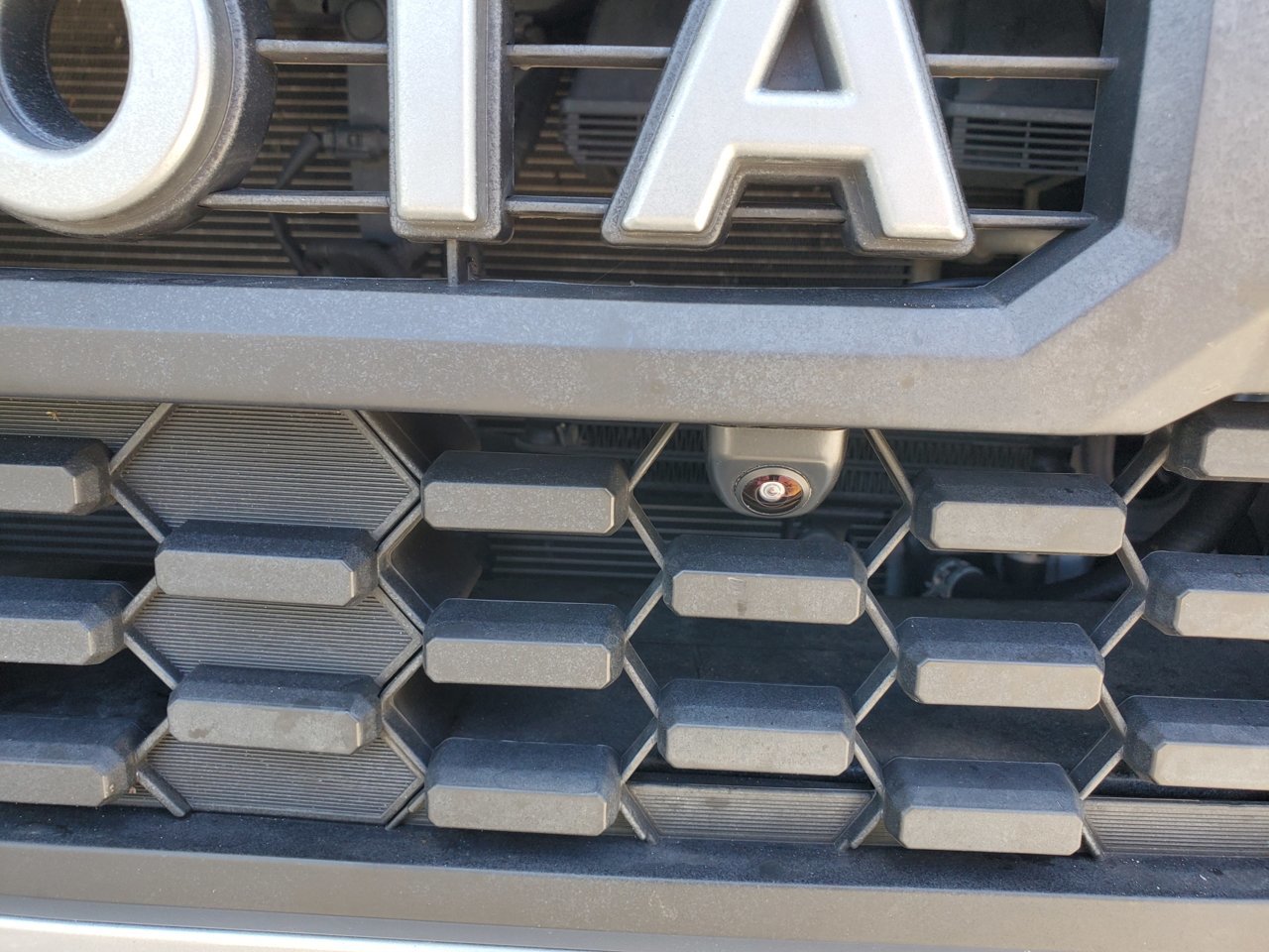

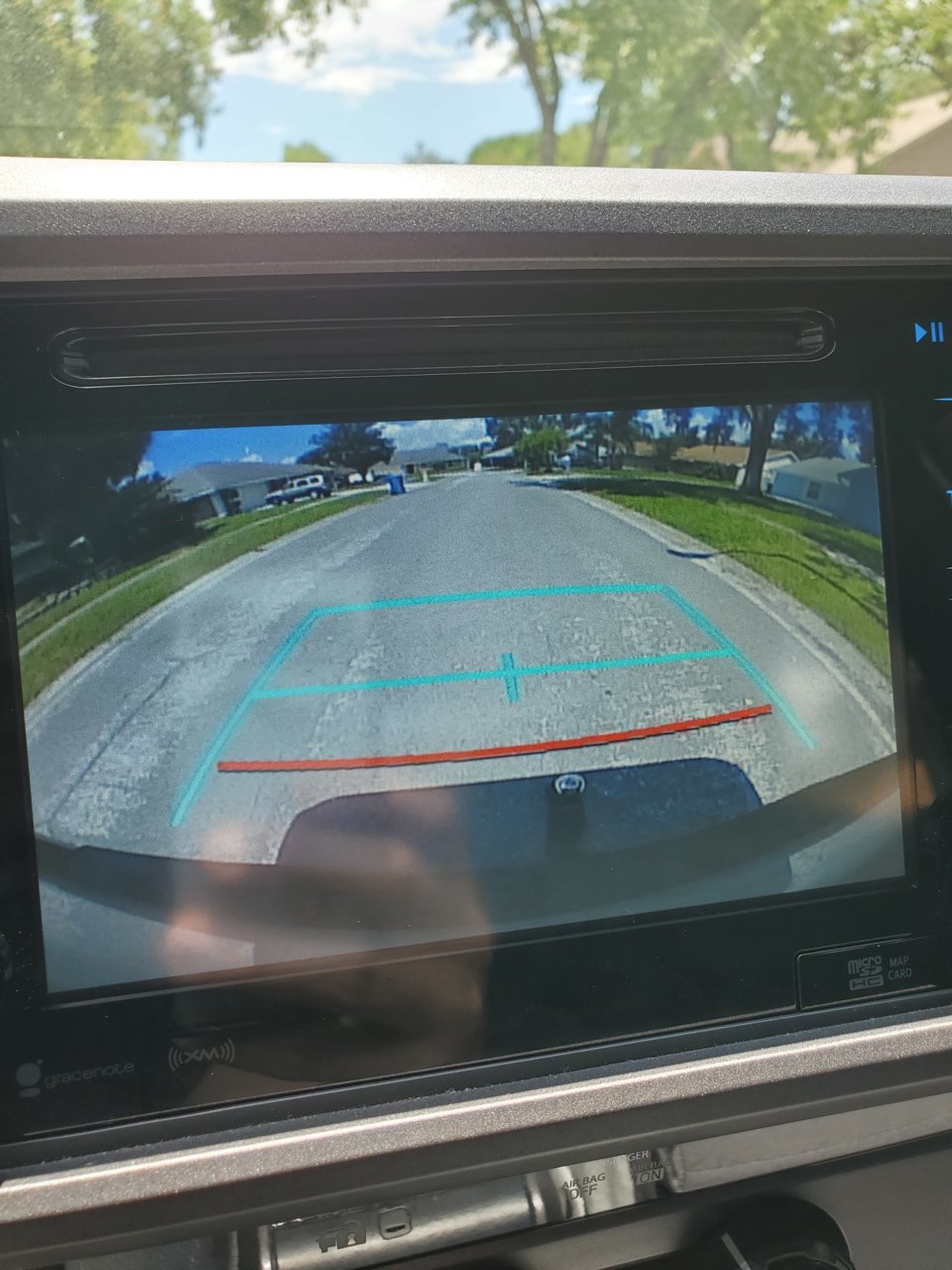

    I just finished installing the germes lab anytime front rear camera and all I can say its by far the most simple plug n play install I have ever done on any of my vehicle head units took me about 45min and thats installing the camera on my pro grille as well. I also went ahead and made my own NAV override switch to the #17 pin on the germes lab harness and works great :thumbsup:

    I don't see any pictures....
