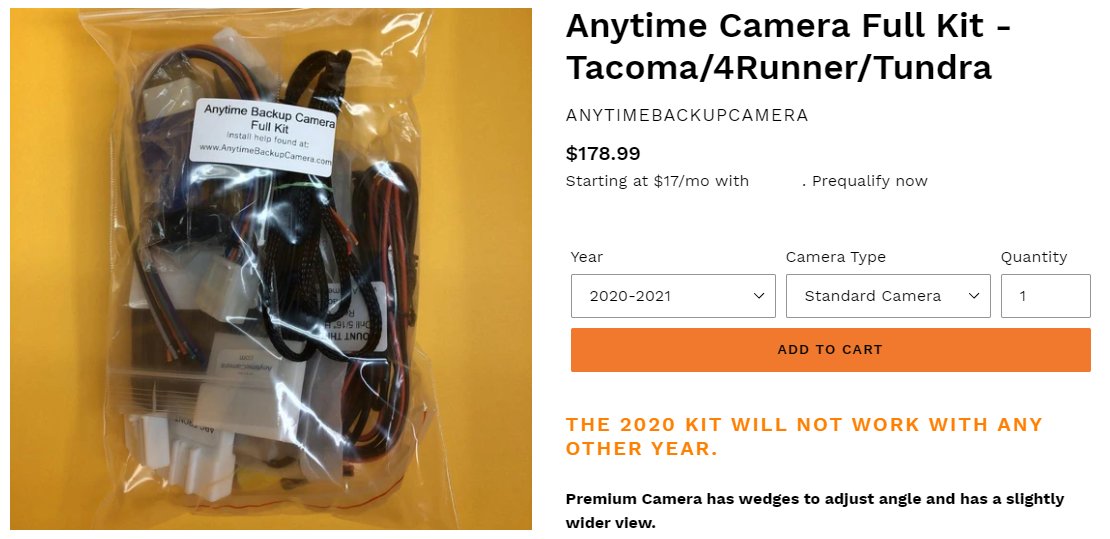

    Are these kits still for sale?

    I believe you can still get them HERE.
