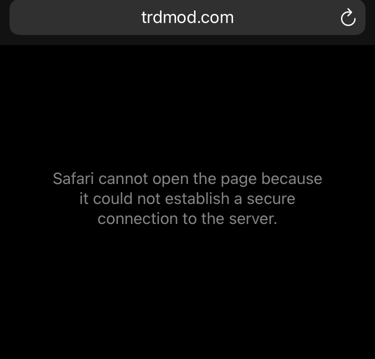

    links on page 1 don't work?
    Looking to add a front anytime camera to my 2018 and power/switch it with the Auxbeam 8 switch. Possible?

    Rear camera buy link is broken
