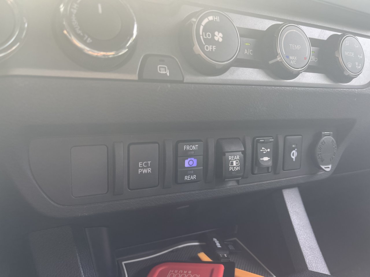

    Im trying to wire my camera but the switch shows the reverse camera when I press FRONT and REAR. Anyone know how to fix this? I bought it prewired

    Might have to swap around the yellow rca wires around .

    I fixed the issue. My switch wasn’t grounded LOL

    Does anyone know what wires I need to cut to disable the backlighting on the small style switch?
    * I have not tapped into the fuse box or into any factory wireharnesses

    Why do you want to cut the wire?

    I don't like how bright the backlighting is. I think it'll look nicer without the light indicators on the switch

    You could always put a resistor inline to reduce the light output.

    For the backlighting did you tap into the green + and tan - from a nearby factory switch? From what ive read thats the combo that will let you dim aftermarket switches same as factory

    I did not

    I just got my kit and will hopefully get it installed today or tomorrow. I’ll let you know how it goes if you want to hold off on cutting any wires. Maybe just put a small piece of tape over the switch for now.
    What’d you tap to get the backlighting?

    I didn't tap into anything to get the backlighting. I believe the power for the light comes from the adapter that plugs into the stereo.

    Got it installed yesterday and was able to get dimmable backlighting by connecting blue + and grey - from camera switch to green + and tan - on any nearby factory switch (tried both ETC and Qi switches). It was hot as hell in my garage though so i just tested this by jamming the wires into the back of the connectors. I have an ECT always-on mod and plan on splicing into that harness as a more permanent solution.
    What are the blue and grey wires from your switch connected to?

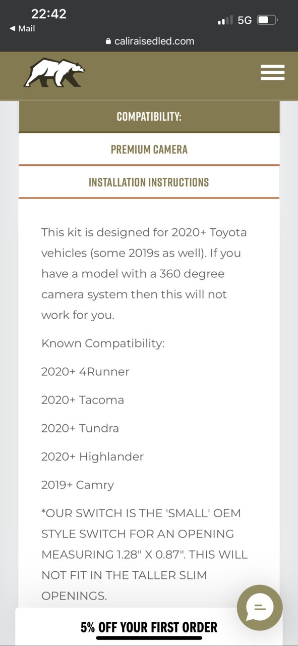

    I am interested in this kit but I have a couple questions
    Will this work with my OEM front and rear camera system?
    My truck has the push button to activate the front camera temporarily, but it shuts off after I hit like 10 km/hr. How does this work with the anytime camera system?

    Hey! I came across this kit on the first page of this massive thread. Looking to get the rear view only kit. I tried the link from the OP and it didn’t work. Are people still ordering from the OP? If so, where do I go to get the kit?
  18. Jul 12, 2022 at 9:57 PM
    #1718
    mic_sierra
    mic_sierra Toshiba HDDVD is the future
    Nov 30, 2021
    #383480
    1,107
    Elsewhere
    '21 DCSB TRD Sport 4x4 Auto
    Looks like the trdmod domain is parked on GoDaddy; not sure if OP sold his design to someone and is collecting a royalty or what but you can find the kits over at Cali Raised LED.

    Found this on the Caliraised website for anyone having the same question in regards to OEM panoramic camera systems.
    Bummer
