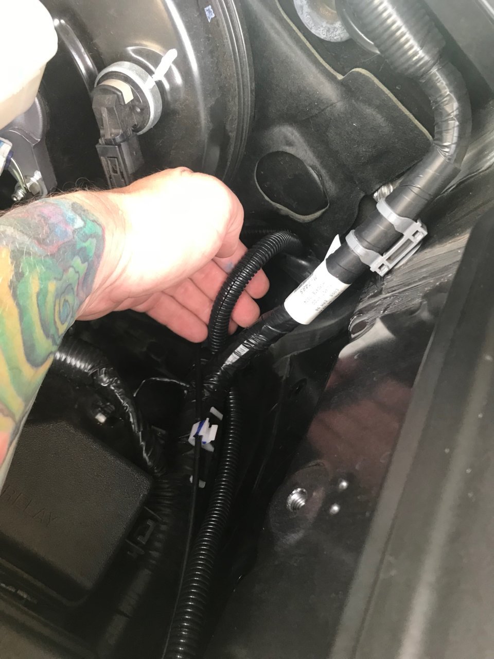

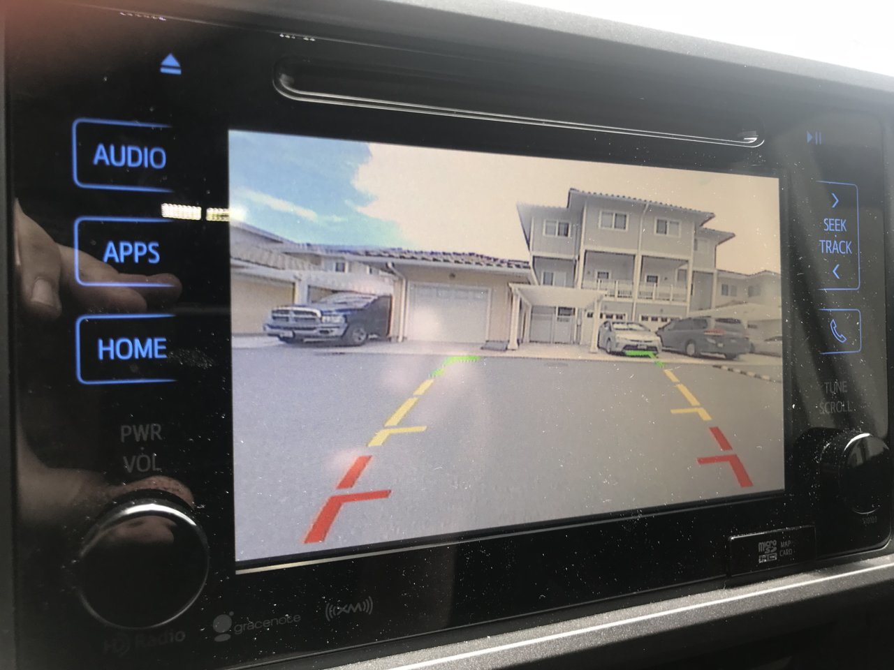

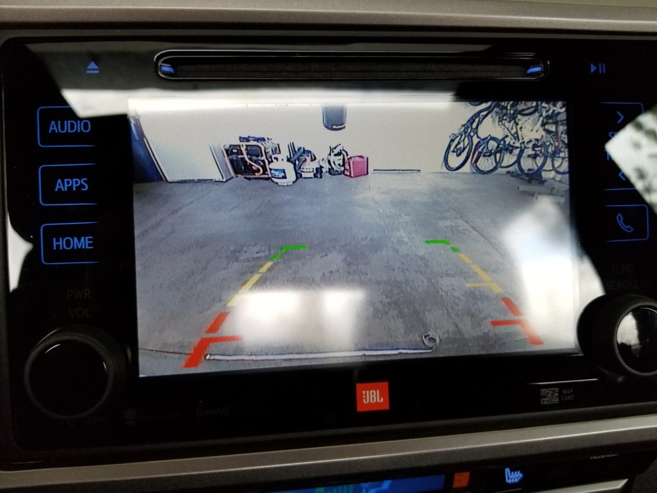

    What to say thanks to JJ for making a great product he was very helpful and was able to answer all of my questions before i started the install.
    The install went very smooth and was easy to do. I decided to put the camera in the grille and went with the green, yellow and red lines on the display for now, if i decide not use them anymore i just have to reconnect the green wire on the camera and the lines disappear. The wires were ran through the fire wall on the drivers side where there is a rubber grommet you just push it out of the way with a screw driver and the wires slide right into the cab. I bought 10ft of black wire conduit (I also ran a little bit in the rubber grommet to prevent any wire chaffing) for under the hood to hide the wires for a more factory look in the engine compartment.
    Over all I am very happy with this setup.
    Thanks again JJ.
