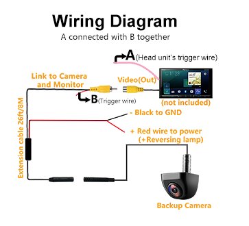

    I was having the flashing/flickering/black screen for a while. Since I'm in AZ, I thought it was due to heat. My fix was the ground. Rear cam was using the ground from the OEM backup camera plug. When I moved it to chassis ground, the flicker went away. The front camera ground wasn't even connected and it would work most of the time. Put that on the chassis ground and it is good now too.

    Can you send a image of the ground your talking about?

    It should be coming off the camera side of the cable:
    Both of my cameras use the trigger wires for power. Black to chassis grounds and then the red wires are capped.

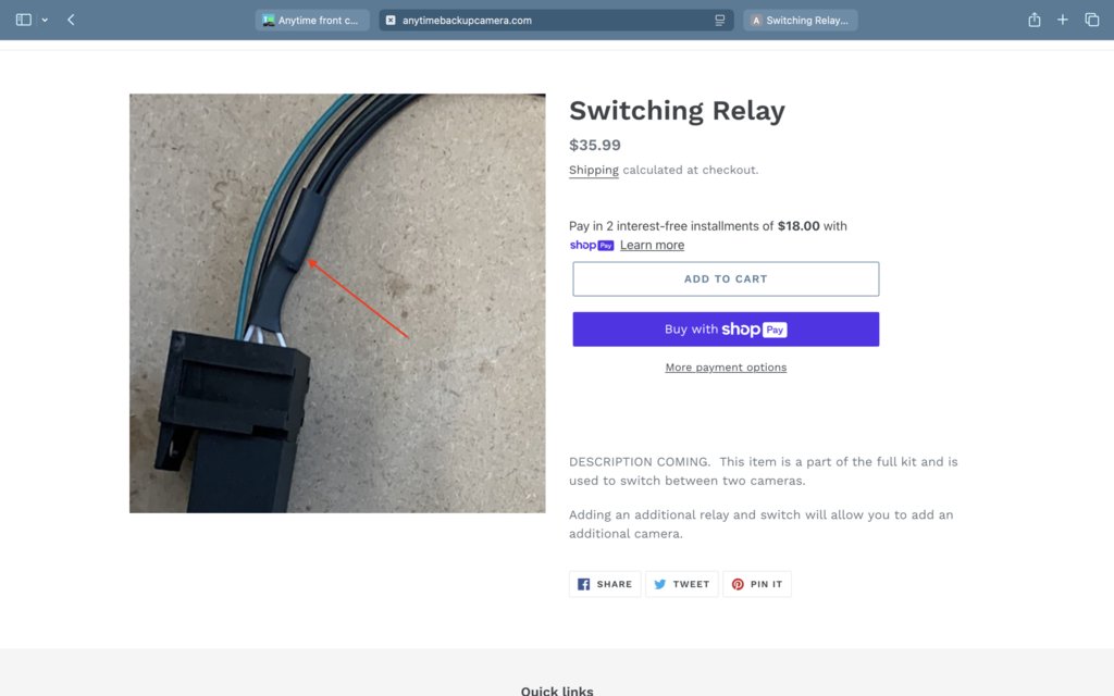

  18. Jul 5, 2025 at 3:00 PM

    The grounds under this shrink tube weren't isolated... That was my issue, and the new switch relay fixed it

    Doesn’t that qualify as a product "defect" and warrant a free replacement from the vendor?

    Exactly. Idk who makes the kits, im guessing the owner(small company)After reaching out to the company, a couple times, I gave up. He had no clue what the problem was after speaking to him over the phone, I think he was the owner and was New york number... this was a few years back. I just didn't wanna deal with it anymore and had a week long trip coming up. I got a couple spare parts though! lol :sadviolin:
