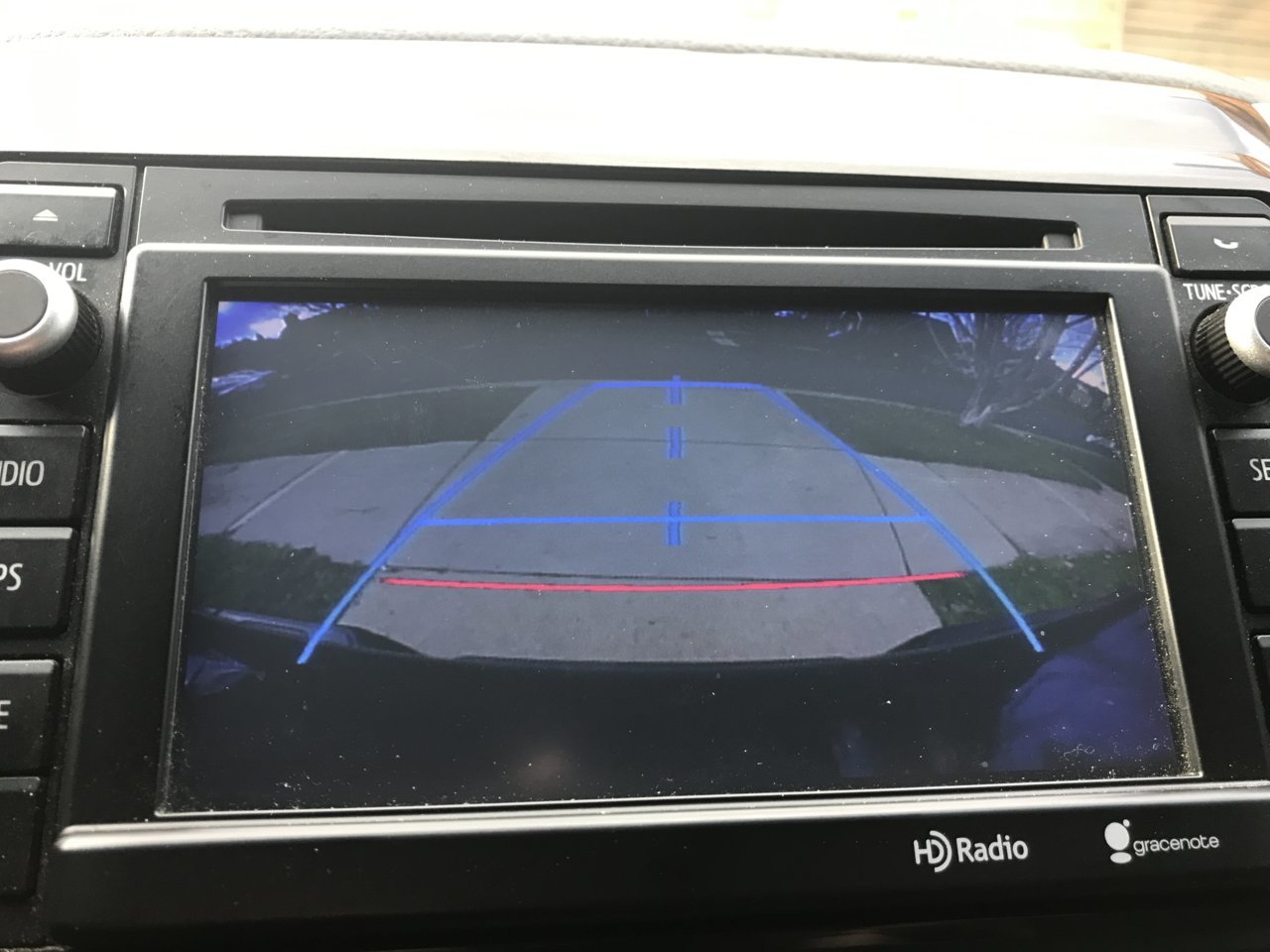

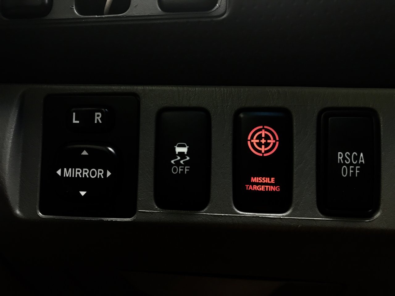

    Ordered a custom switch for the mod and stoked with the finished product. A bit of a James Bond fan...
    With the Softopper on the rear camera is a nice option when in the highway in addition to the mirrors.

    Looks good man. I like the custom switch.
