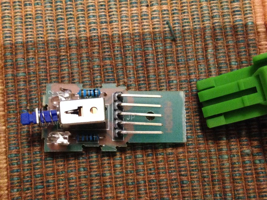

    A switch I ordered for another project arrived today in a tire flattened pouch. Having opened up the remains it might be possible to create a pcb with two surface mounted switches. The plug pins are just standard .1" right angle pin headers and the only other parts are two led/resistor combos for the illumination. Someone with eagle cad and an Oshpark account could/might do this. Then it's just converting the switch cover to a rocker.
  15. Apr 23, 2018 at 8:42 PM

    That’s possible. I asked one vendor to make me two push button SPST switches small enough to fit the same size as the cubby switch. So each switch would have been about 18mmx10mm. They told me no.

    Here's the pcb39D3F0E9-0C61-4C6F-AAFB-5C5636FA2D35_zps_fa304e35285f1cade26cdfc4aa20270941b8fa72.jpg as you can see it's a pretty simple one that uses readily available thru hole components. Even the plug pins are just pin headers.

    I've been on other forums where members created a new pcb design and a vendor took care of production.
