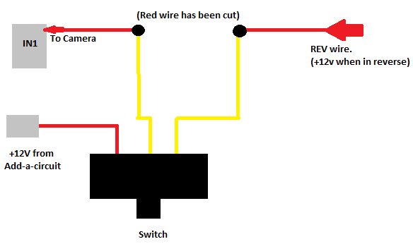

    So, just to confirm, on my 2014 with factory touchscreen HU has the connection behind the glovebox as shown in the 12-15 Gen 2 pdf? I've tested that connection and it is 12v on with reverse so I should be good to go using that connection correct?
    From there, the pdf directions are pretty clear and basically match this simplified drawing....

    Make sense but I never hooked mine up so I cant confirm.
