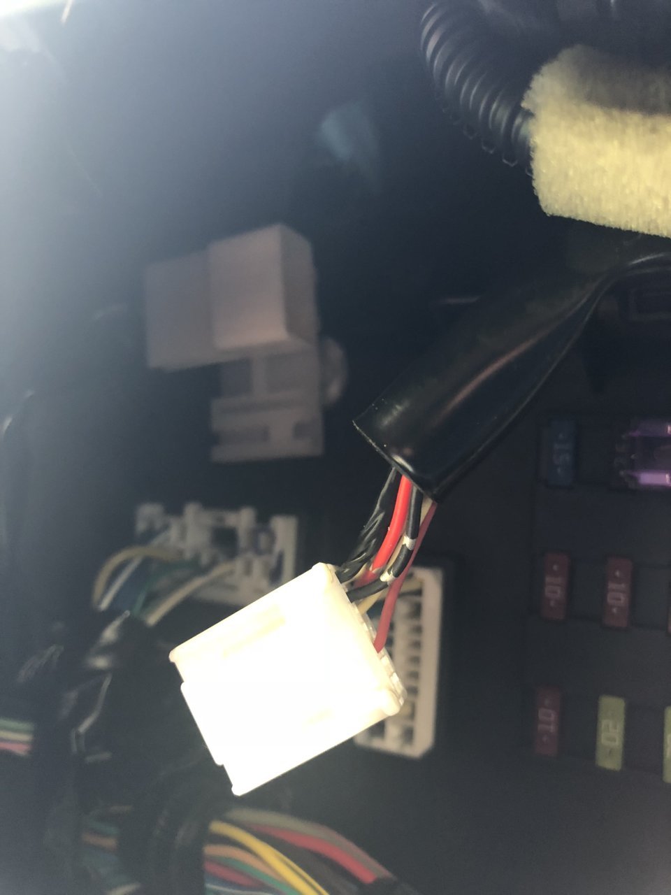

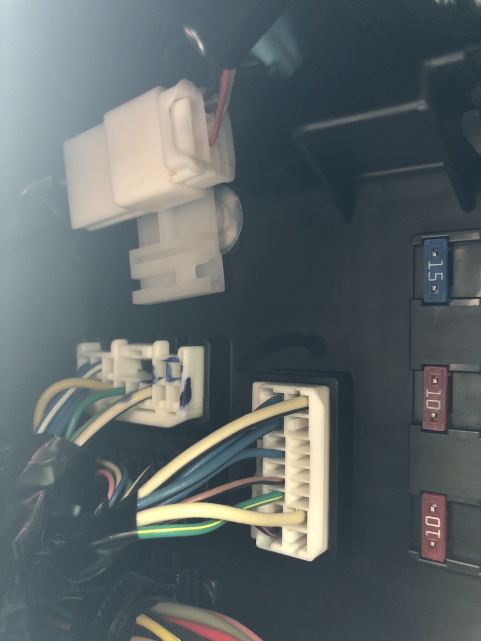

    600E2C52-7A56-422C-8144-90E582447F25.jpg 444FE549-E78B-4FA7-B62A-8FA131B1D284.jpg need some help finding the IN1 connector its not behind the driver coin tray like in most post I see.. JJ can you shed some light on this? This is the same connector (plugger&unplugged) when I unplug it and put truck in reverse the camera still comes up so I’m guessing this is not my IN1?
