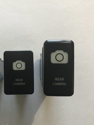

    How would you wire a switch like this with that kit stated above?[​IMG]

    It’s super easy I have a video I posted on YouTube showing how

    Dude you F'ing rock exactly what I needed so it just two wire from the kit than a ground is all I need to wire up.

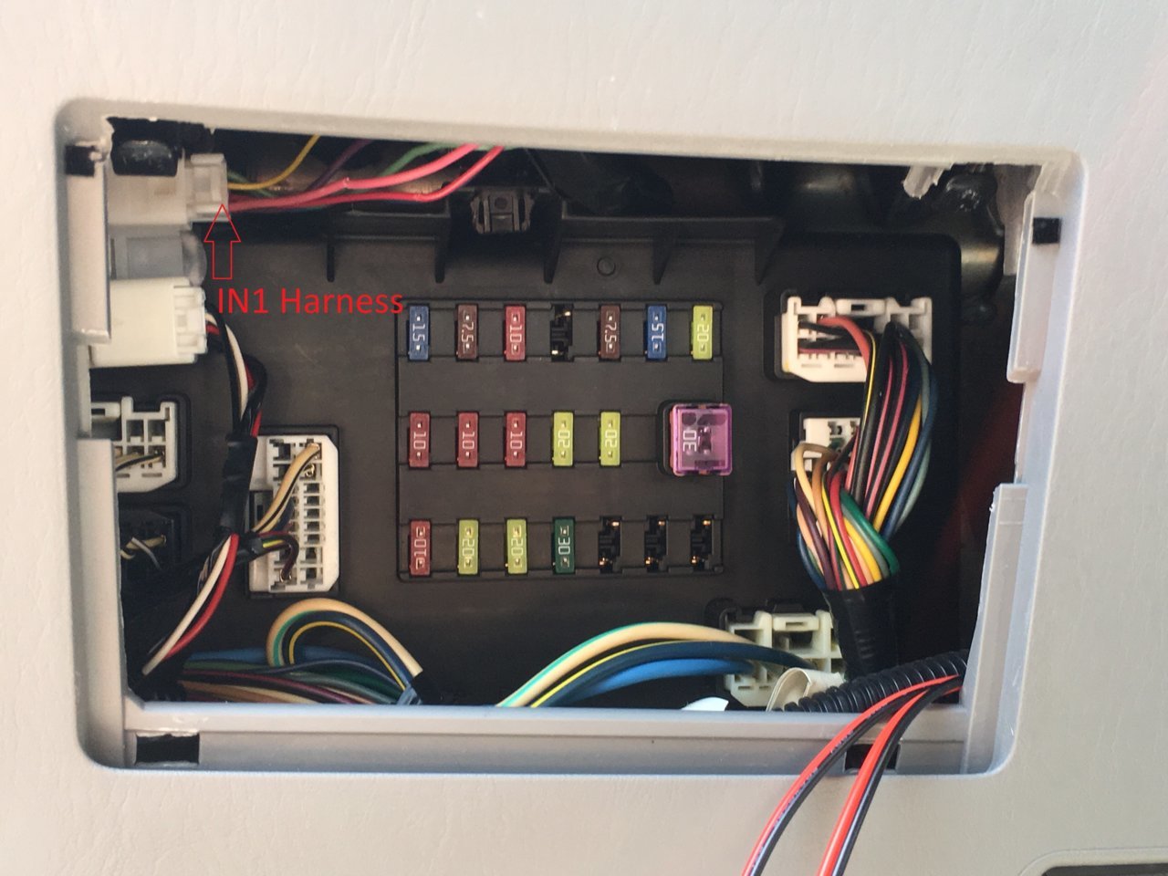

    Working on this mod right now for my 2010 OR with camera in the rear view...
    I'm stuck in one spot - trying to find the best ground to tap into. I've been poking around the fuse panel area and I think the harness just below my IN1 harness might work:

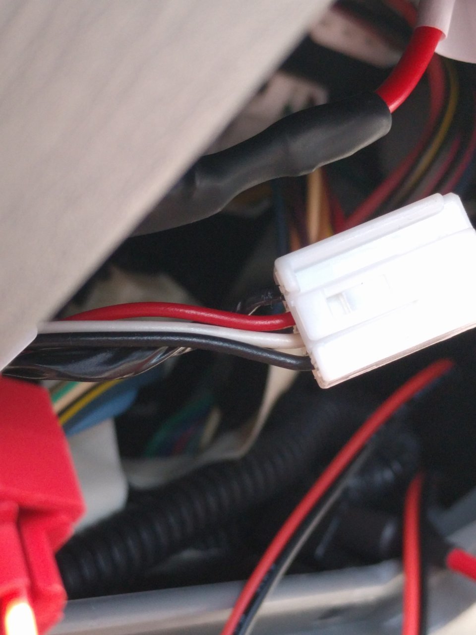

    Closer view with the lower harness unplugged:
    I'm thinking the black line would be a ground to tap into, but I'm just not sure of the best way to verify (or if somebody could just give me a "YES" from personal experience that would be awesome). Any suggestions? I'm clearly not a pro at wiring mods...I've got a multi meter but I'm not sure of the best way to test this.
    Thanks!

    If you pull the center console there's a ground lug on the frame below the AC controls to the right of the cubby. Another is behind the driver's side kick panel. Tan is ground on our 2nd gens.
