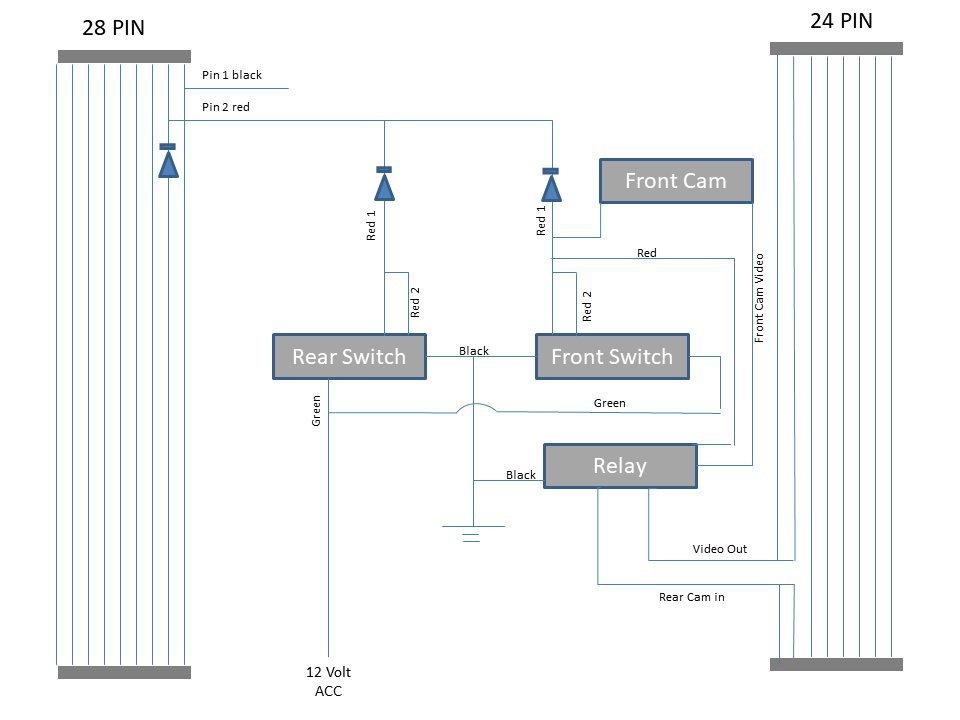

    Since he is MIA, can anyone send me a schematic?
    Edit: I should clarify, i have the rearview mirror camera, not the headunit camera.
    I imagine a screen is a screen , headunit, or mirror. ..

    My understanding per the original seller is that the wiring is different. I may be wrong.

    Whatever, that's the included schematic. ..
    Sorry I bothered. ...

    Do you still have the cables for a 2014 Tacoma? I want to install the switch under the HVAC in the center console...

    I think you have a different harness than the one JJ used to sell so that info might be in a different thread.
    Mine connects behind the head unit instead. Maybe a diode betwen the red#1 splice and the factory harmess clip? Your switch feeds 12V to the splice but maybe it should only be allowed to go one way.

    I have this version. I was sent a second when I thought the first was broken. I think all I did was reverse the connection due to the diodes. Sorry if that isn't a lot of help but it was a while ago.

    i have the version that goes behind the glove box with a splice. i got it from this thread. i think i do need a diode though or check the supplied Y at least to verify which way it is
    thanks. i was figuring it was diode related somehow. ill take a look at it more. thats the trans ecu isnt it where the red wire is connected to the plug? im guessing the diode needs to be on that side so it doesnt get fed 12v with the switch

    Yeah, I either read the direction wrong or they are backwards. Either way it works great once you figure out the correct order. Really happy I received this version before he stopped making them.

    im guessing the diode just isnt working/there. the voltage either needs to go into the computer or "out" from it. it would make more sense that it goes out and the computer supplies it normally. ill see what happens when i get home

    well i just have a bad diode apparently and the y harness was labeled wrong. i took it apart and found which lead the switch needs to supply power to the rev camera. so voltage does come from the ecu and the switch now
