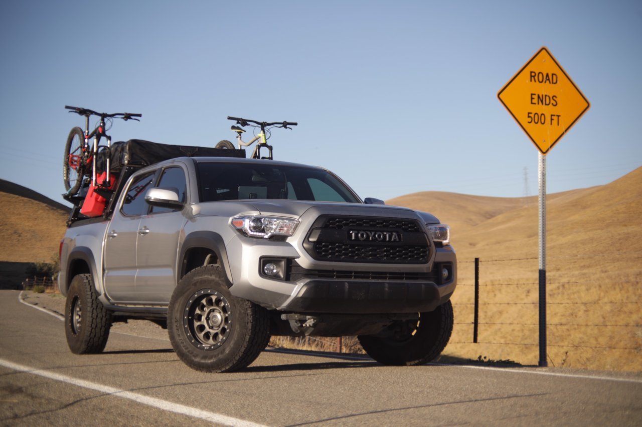

    Just did a rig walk around with Michael from Overland Bound today on a DD that converts to an overland rig. I discussed this mod and how I like to use it. The video will post Sunday night on Overland Bound’s YouTube channel 081BF7F4-A98C-4A31-AA66-82AA1DEF8E51.jpg
