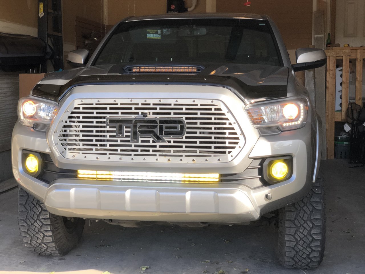

    I got a flat grill (300 industries) and i put mine above center. I can still see the bumper78A02CCE-BF6E-46F2-B519-D0387DBB80F1.jpg
    Papadave418[OP] and payrow like this.
