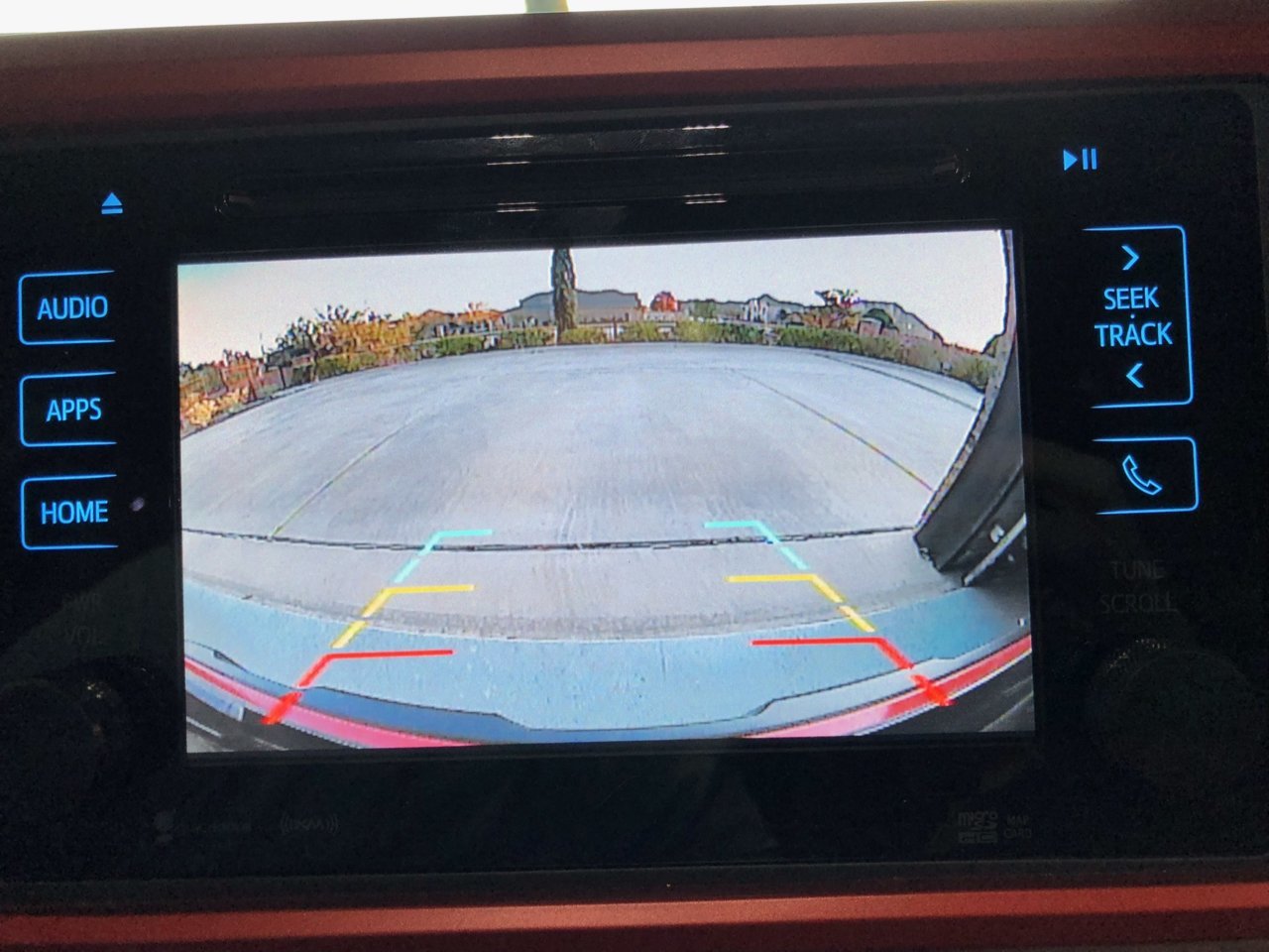

    Anyone else has this problem? My Yimu camera image also looks black and white.
  11. Nov 18, 2018 at 11:19 AM
    #311
    tweet562
    tweet562 Well-Known Member
    Dec 14, 2016
    #204878
    131
    SoCal
    2017 TRD Sport 2WD
    TRD Pro Grill Nerf bars Bakflip MX4 Subaru tweeters Tailgate Pop&Lock OV tune SCS Ray10 17" Matte Black
    I figured out why the image looks black and white. It's because the setting was on PAL format, once i changed it to NTSC then it changed to color. Everything looks good. This project is done!!!

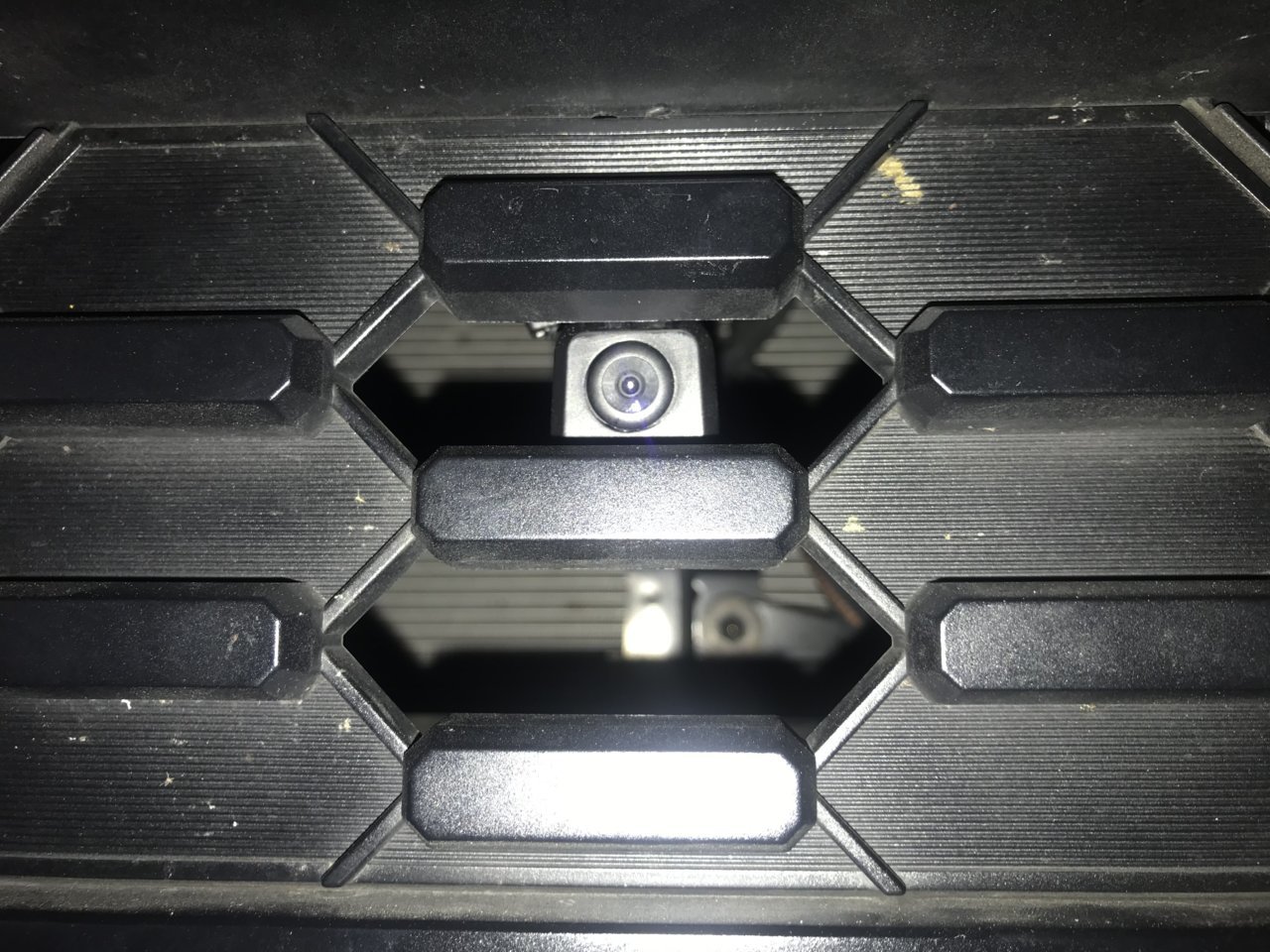

    Just curious, I tried to mount in the same spot but that put the rod right up against some TSS stuff and I couldn’t get the retaining nut on. Did you run across the same thing?

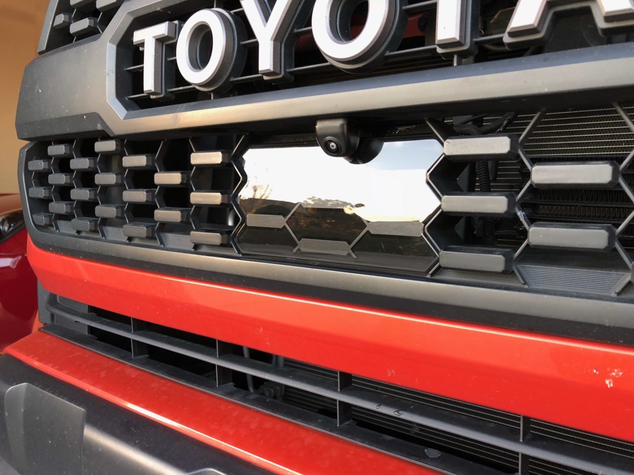

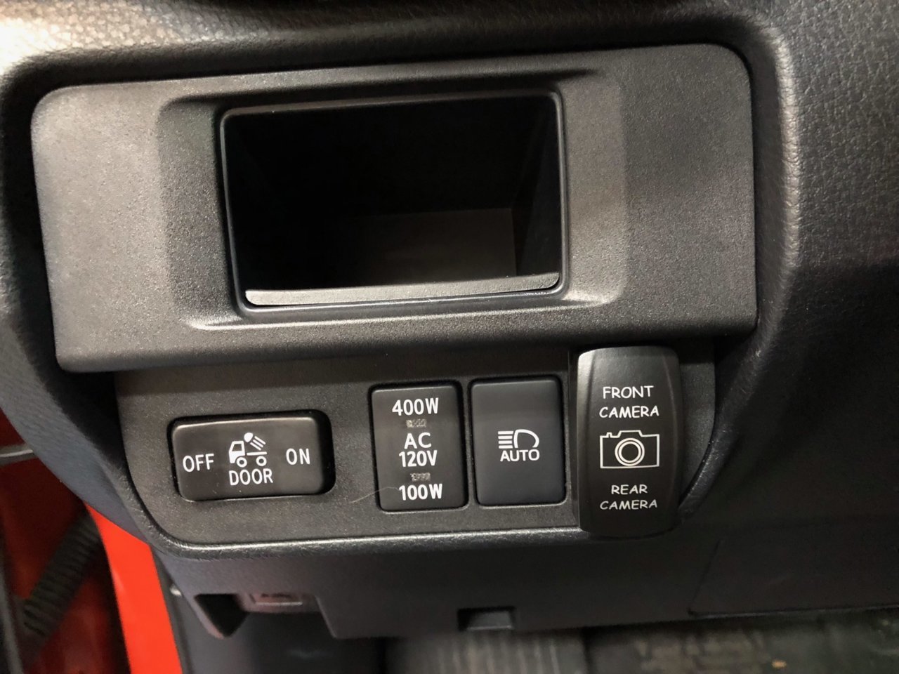

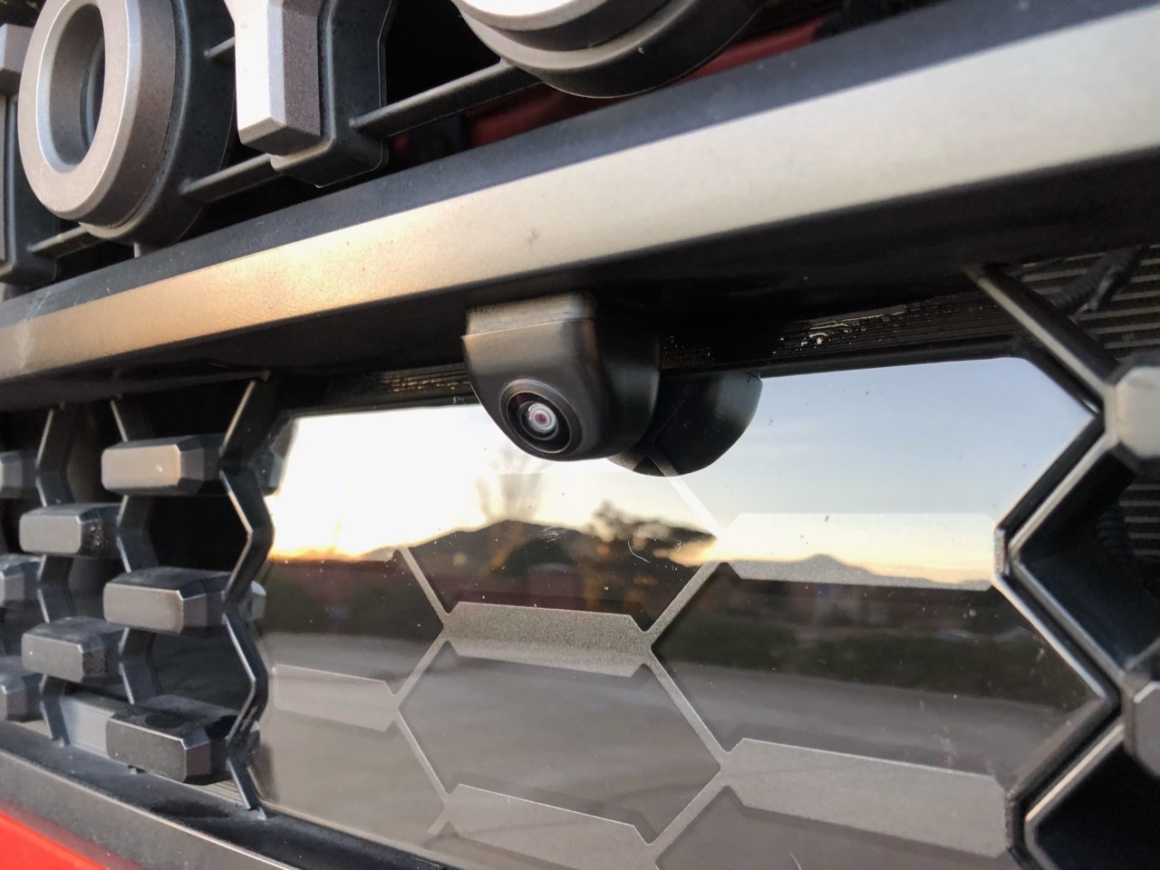

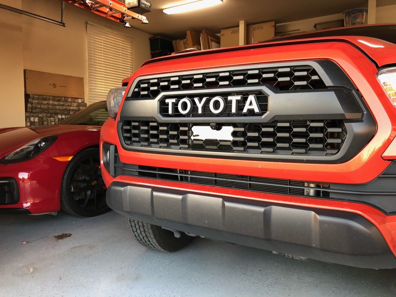

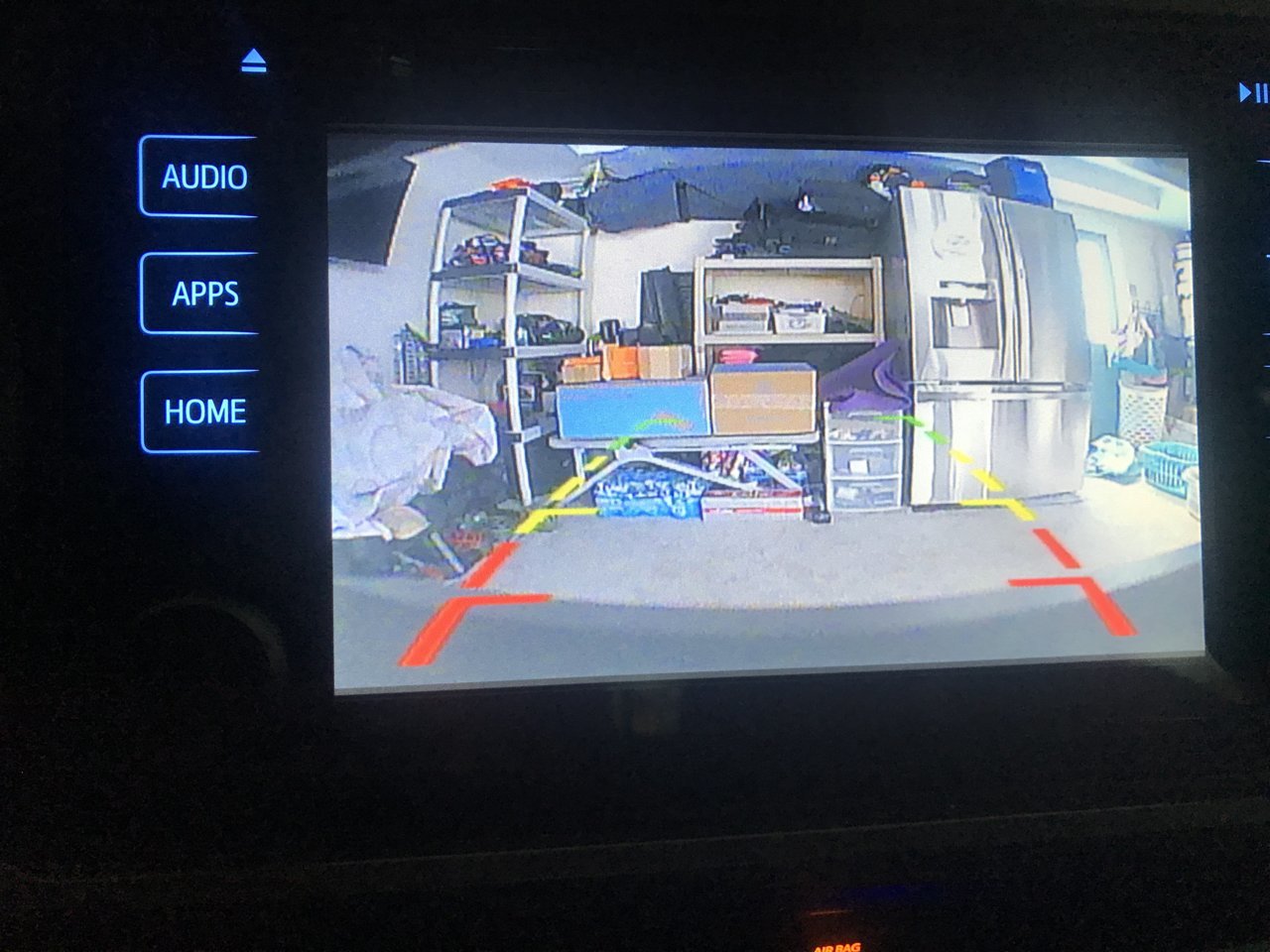

    https://www.amazon.com/NATIKA-Backu...43016375&sr=1-4&keywords=natika+backup+camera044A8A8E-8DB8-4589-89DE-718B941F2D33.jpg Okay, finally getting around to posting some pics of my install. Camera has been in for over a month, but I’ve been needing to tidy up some stuff. What I learned:
    • I’m slower than everyone else
    • I’m OCD until I run out of patience and then it’s Gitter Done
    • Brian was great, I seemed to have a snag in my setup and couldn’t get it to work and he sent me a replacement pronto.... worked like a charm
    • When filing your opening for the AOB DPDT switch, don’t let your wife take the dremel to a dog show or you’ll end up using a hand rasp
    • There are tons of cameras out there, I ordered two different ones and kept the one with the best picture quality.... actually, still have the other too
    • Measure twice, cut once also works for measure twice drill once
    I have an OEM Pro grille on my OR, and I have the TSS bezel. I centered my camera but then couldn’t get the retaining nut on because it was flush up against the TSS housing. I ended up having to move it offcenter a bit.... more than necessary because of the ‘Doh!’ hole.
    FWIW, the camera I got seems to have a really clear picture and decent night performance.
    In the end I ended up with the full kit, a front camera, the AOB DPDT lit when active, but I haven’t installed the Nav override. Perhaps at some point if i find a need. More pics below.
