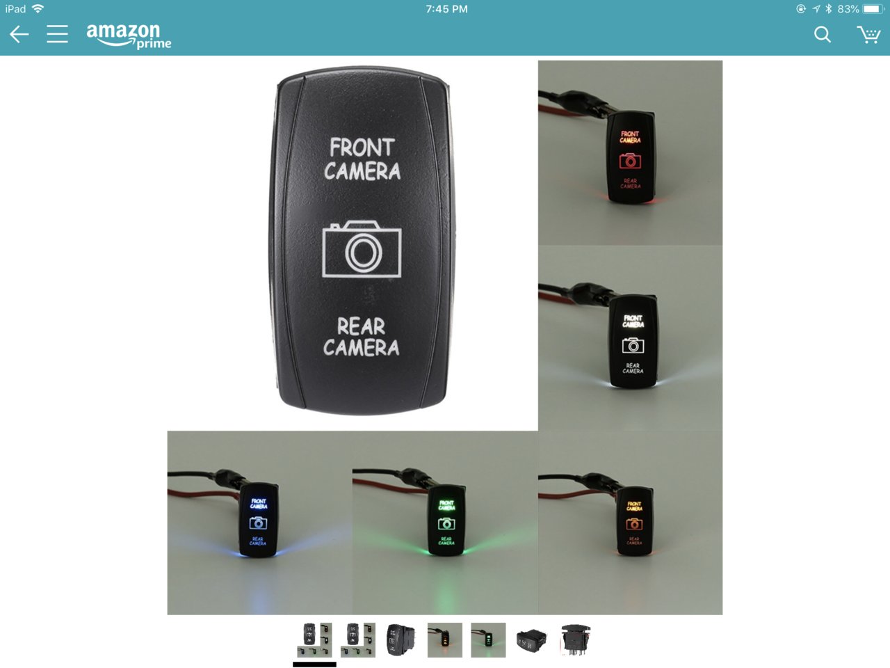

    This might be the same switch?
    CALAP-STORE - Universal Car 12V 7 Pins FRONT CAMERA REAR CAMERA Switch LED DPDT ON-OFF-ON Rocker Switch RV Boat https://www.amazon.com/dp/B07FTB7J7Z/ref=cm_sw_r_cp_tai_tKiLBbHYMKH6D

    It looks about the same as the one I got. But not really sure.

    Its 5cm x 2.5 cm

    That’s the same size as the aironboard.com one. Looks like the same one to me

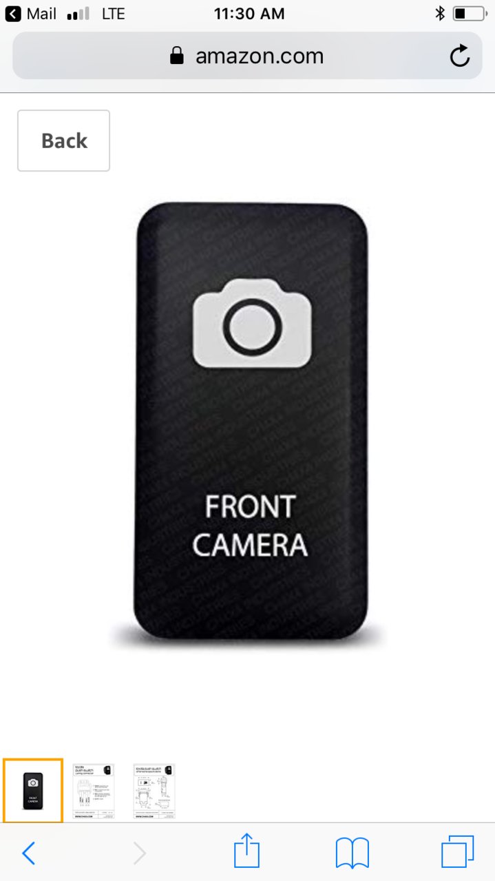

    My guess is you can wire up just the front camera switch. You need the full kit as the basic one is the rear camera override. The full kit includes the front harness that then taps into the rear override to input the front camera source. When the switch is off the screen behaves normally and will only display the rear camera in reverse. When you select the front camera it pops on, so one switch should work.
    I believe this is the OEM size for Tacoma’s, but I didn’t use this switch.
    https://www.amazon.com/CH4x4-Toyota-Switch-Camera-Symbol/dp/B06Y4FSL6Z
