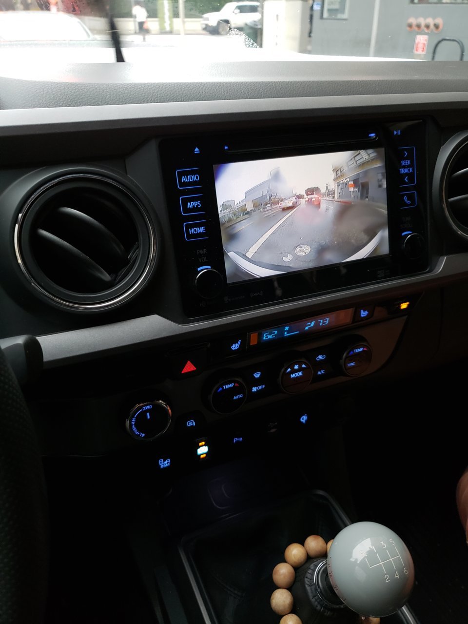

    I went with a $25, 180deg cam on ebay. Took like 3wks to get to SoCal tho. But so far been happy with the quality and the extra wide range, am able to see corner to corner and fwd at the same view.

    Damn that is definitely a better range than the 150 degree one I have. I'm anticipating mainly only using it for parking, but I may get a wider range camera down the line.

    Nice picture. Not a big fan of too much 'fisheye' though. I use mine to see what's in front of me as I crest a steep hill of a trail, and know where to place my tires. I like the realistic view my camera provides.
