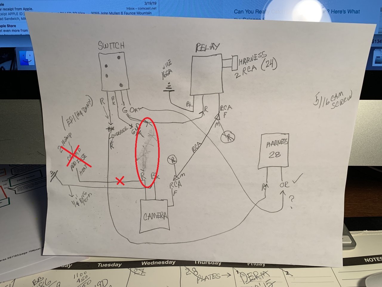

    This is the high tech drawing of how I think the kit I just recvd wires, if I followed Brians video, and his site info

    what do you think, am I missing anything ?

    If that is your front camera in the lower part of the schematic, then it will be powered up whenever the truck is on. Not necessarily a bad thing and one way of installing this mod..
    But, by keeping what I have circled and deleting what I have 'X''ed out, the front camera will only be powered when selected by the switch.
    Just a suggestion and how I configured my install.
    Papadave418[OP] likes this.

    that is the front camera, so if I run camera red to switch green(splice) the cam will be powered, assuming by red from relay ? this would be easier actually than messing with the fuse, but my switch only has four pins where yours has 6 no

    Yes, my switch has 6 terminals. Not sure what type of switch is in your kit and I am not sure the colors of the wires. Its been awhile since I installed the kit.
    But, if Papadave418 likes your post above, then you're probably on the right track.
    My schematic:

    I used your diagram and everything works as it should. I wanted to put and inline fuse on the front camera power wire but didn’t because the wire is way smaller gauge than the wires the fuse holder I had.

    I have a blue sea fuse block but mine is always live so I wired the front camera like n6vmo to only get power when the front camera switch is in the on position. I might still wire it the the fuse block later so I can put a fuse on it.
