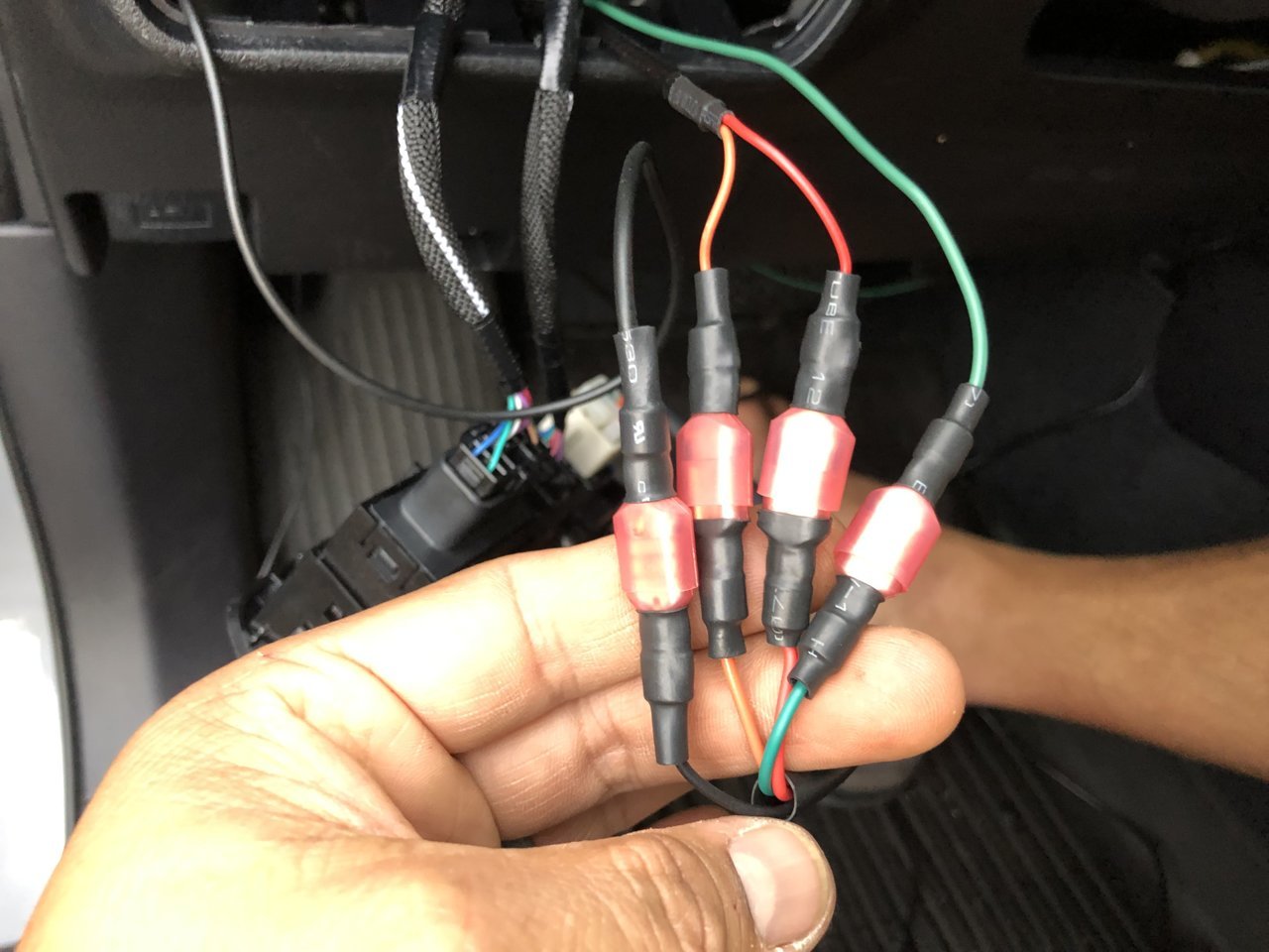

    Did my install recently (got my info from this thread):
    Rear camera harness: connect the orange wire to an open switchpro slot. Disregard the red wire as it is a live 12v wire. Switchpro will now provide the 12v.
    Front camera relay harness: connect the green wire to a second switchpro slot along with the positive wire from the front camera. Ground the black wire from the relay. Also ground the camera. Connect video feed from front camera to the relay.
    On the switchpro, make the front camera the master button and the rear camera a slave.

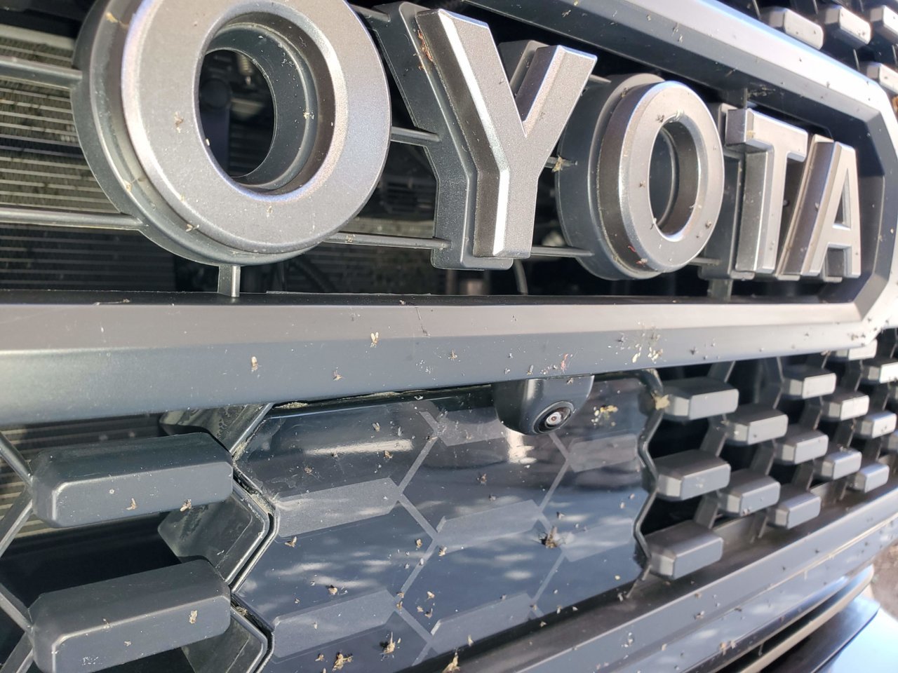

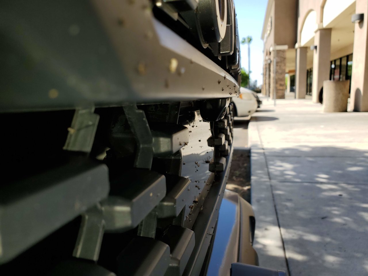

    How far does this camera stick out of the pro grill, I know some cameras mounted on the pro grill don't sit flush.

    Not too bad. Thanks for the picture reference!

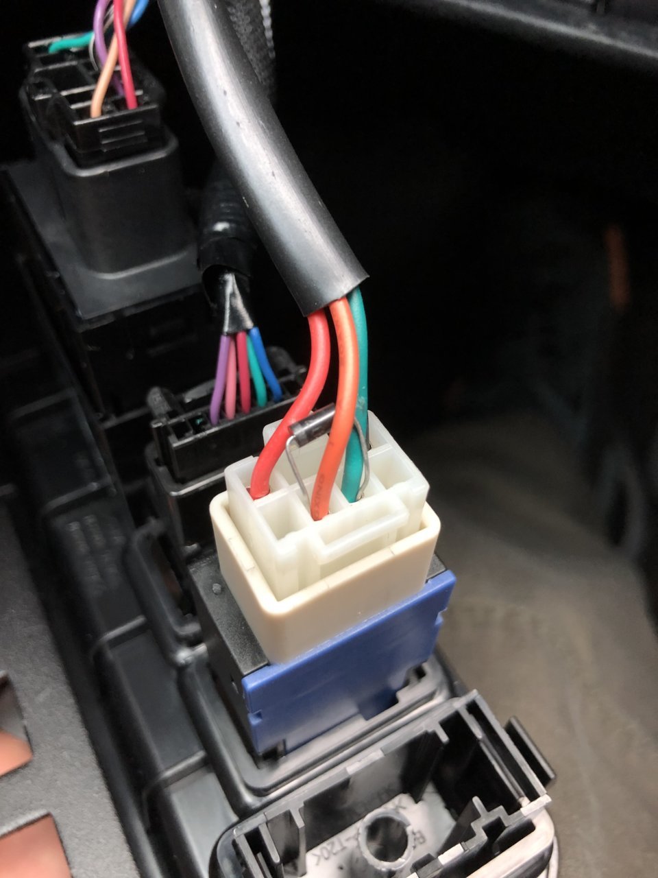

    Need some help from the TW smart people:
    Hooked up my Anytime Backup Camera (ABC), and when I put my car into Reverse (switch is in the middle position), the front camera comes on...
    When I push the “Front” button on the switch, the back camera comes on...
    When I push the “Back” button on the switch, the front camera comes on...
    I can push the from or back camera anytime when I’m driving to engage the cameras and they come up, it’s just backwards on the switch (Front is Back, Back is Front). But leaving it in the middle position (nothing selected) the normal radio screen is there like how it should be, but when i put it into reverse, I get the front camera...
    I’m not electronically inclined so any help to resolve this would be greatly appreciated...
    https://youtu.be/wUrv0GKTE7o
    Here’s how the switch was wired up... there weren’t any directions and all the videos I watched on YouTube didn’t have the same color wires as I do... Or at least I couldn’t find any...
    I did notice that the switch had a diode jumping between the Green and Orange wires... I didn’t pull that out, figure if it came like that, it was meant to be there...
    Tried emailing the company, but haven’t gotten a reply yet... Hoping the TW community can help...

    Your RCA cables are probably hooked up incorrectly. I had a very similar problem when doing my install. Take a look at the instructions and make sure you have those RCA's hooked up properly.

    There is only one way that they can connect. The RCA from the Camera plugs into the RCA connection with the "Sharpie Mark" on it. The other 2 can only plug in one way as coming out of the HU they are Male and Female...
    I could be wrong, but I unplugged everything and looked at what was in front of me and this was the only way it all went together... Unless the "sharpie mark" was marked on the wrong RCA? I didn't try that as all the videos I watched said to plug the camera into that one...

    You were 100% correct sir! Thank you! I appreciate your time and expertise!

    Pretty sure that's a diode, not a resistor, in the switch harness. Permits the electrical signal to travel in one direction only.
