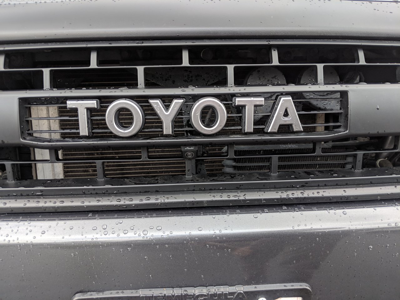

    Been following this thread. So, I did the pre-order for the Anytime backup camera "Full Kit". just received it looks cool the way its broken down into modules. One item that doesn't match the Anytime backup camera web page is the camera I received in my kit. There are no white,green wires to cut when orientating camera on the grill. so before I install I was trying to figure does camera "hang" or "sit" on the structure to get the Positive view and I guess no option to remove the lines displayed. Anyone else get a camera with no green or white wires?

    received an email from AnyTime Backup Camera. Brian said, no more cutting wires already setup as a front facing camera. guess no more lines either, kinda wanted them since this was more for garage parking.
    Just finished intial install everything works as advertised. taped camera to grill just below tss/toyota emblem, I'll stow the loose ends and do the camera mount in morning. camera orientation is with the threaded stem pointing up.
