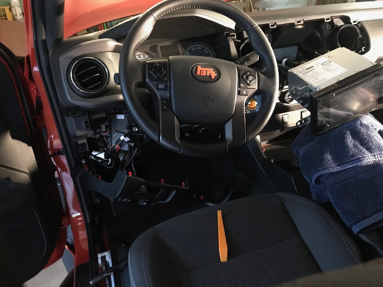

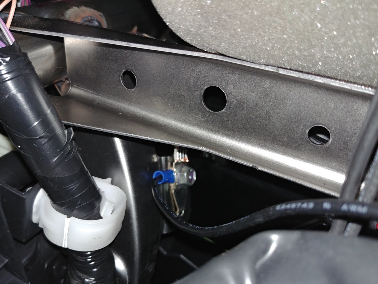

    15799B62-710A-4A4C-BC9B-78093B62B779.jpg CF3A0A24-0624-4B0B-AEDE-7A393FA8FEFA.jpg 71E37308-EB26-4B00-9FF3-0398B30397E0.jpg 477EEFAE-51F5-4E63-ABC2-9CD5470701A4.jpg A42AF7C8-5ECB-4972-9046-D606D26518A1.jpg
    This quick mod installation gave me fits. Sometimes I can’t wrap my dumb brain around the simplest of fixes. Long story short, after a week I revisited this project. I removed the trim piece around/below the steering wheel and immediately noticed what was giving me a headache. There was a poor wire connection going to the camera switch. Fixing the connection, everything thing works as it should. Sometimes the simple things aren’t so simple :annoyed::facepalm::frusty:
