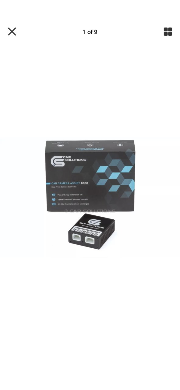

    There is this. I believe you can scroll your front/back cameras via your factory steering wheel controls. No idea how it’s installed or if it’s any good.
    https://m.ebay.com/itm/RFCC-TTG2-Ca...System-for-Toyota-Touch-2-Entune/263686023656

    it's pretty good. completely plug and play (no cutting or splicing). if you're not installing a front camera for offloading, it's probably the better/easier option as the camera only stays on for 30 seconds before it goes back to the radio display.
    edit: actually, holding the up button until it beeps will keep the camera on. so, this is probably the best option for a front camera.

    On that version can you make it stay on longer? When I drove Death Valley on some of the harder trails I had my front camera on for hours

    ICU1
    ICU1 Well-Known Member
    Sep 3, 2016
    #196340
    4,531
    Buy this. Uses radio control buttons on steering wheel. Plug in play. No added wiring needed.

    Out of the box, no; but I’m sure someone could hack into it to stay on longer. I think it’s more suited for people who want a front cam for parking or a quick check of their surroundings.
    If someone wants a front camera for off roading, I think a switched camera is better.

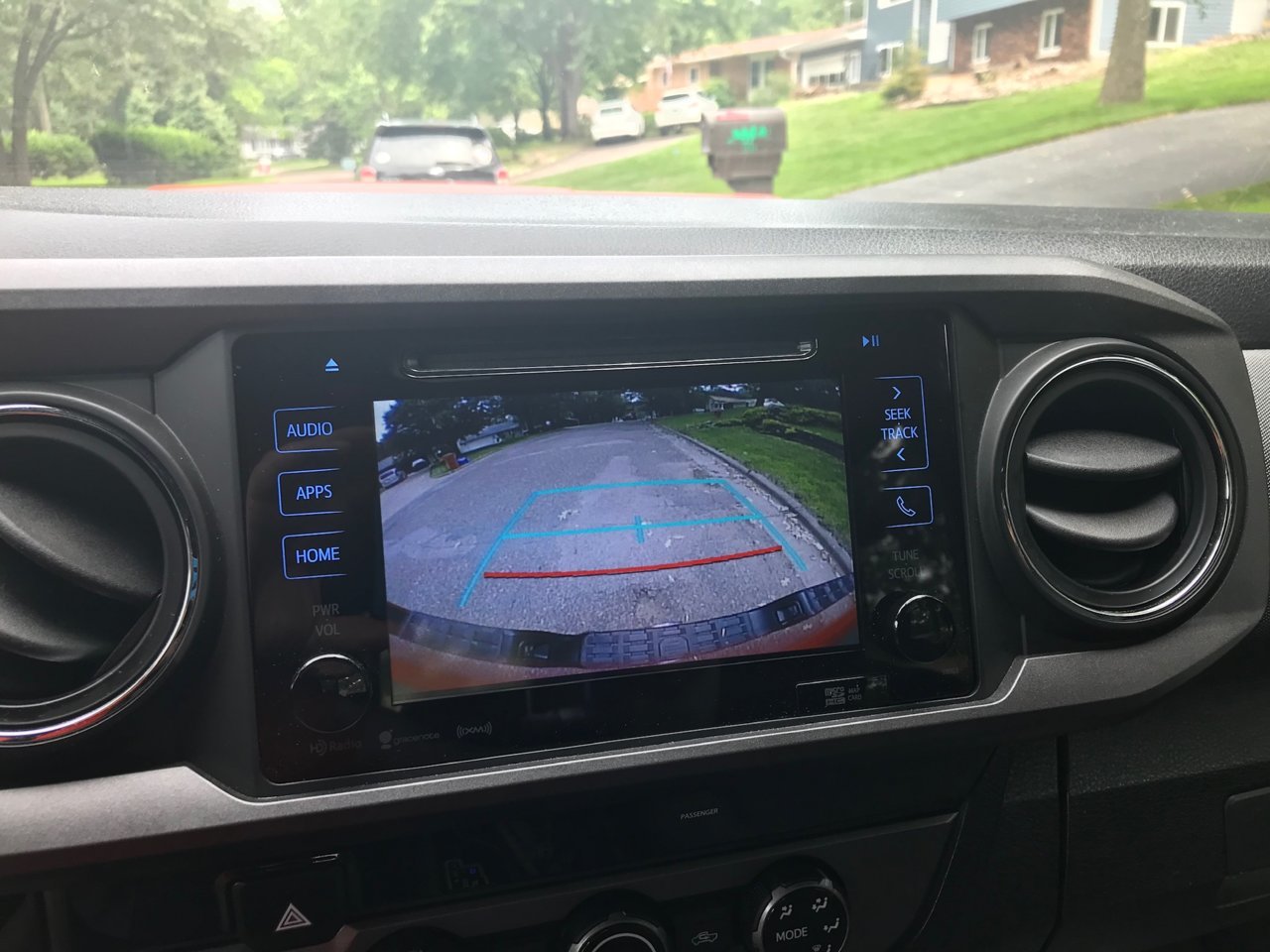

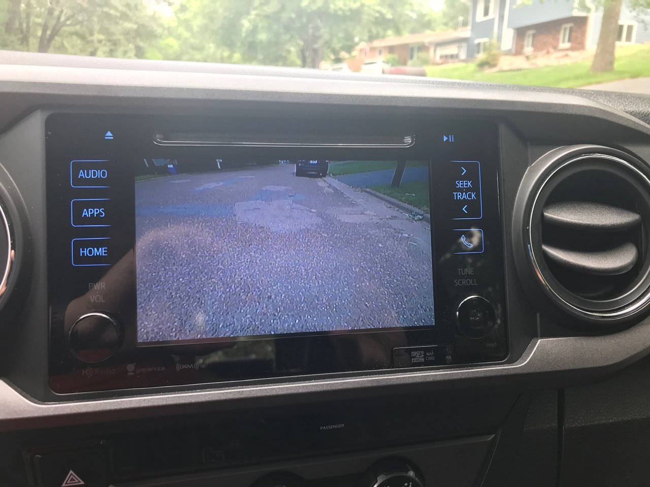

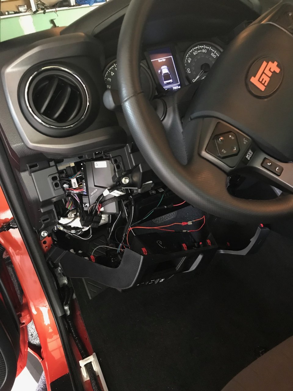

    After having my anytime backup camera full kit sitting in the drawer for about six months (it was my Christmas present from my wife), I finally installed it this week. Couple of minor notes on the installation, and my mistakes.
    First, I had assumed that the mounting tab on the relay was also a ground for the relay. Nope, checked continuity from tab to ground wire, nothing. My bad. But, in the process, I did find that the tab could be removed, making it easy to mount the tab to the truck, then slide the relay back onto the tab.
    Also, regarding grounds, I wired all my grounds to a common ground (except for the one from the camera). I terminated them into a crimp on ring. I originally tried to attach that to the chassis under the same screw that the relay was mounted with. The thickness of the crimp connector interfered with my socket, woudn't let me tighten down the screw completely. So, as most others have done, relay mounted on the passenger side chassis screw, grounds on the driver side.
    A couple of videos I have found on the installation show people connecting the front camera power into an add-a-fuse in the under-hood fuse box. But, a video from anytimebackupcamera.com used the little red pigtail wire on the video cable to connect power from the 12 volt wire on the relay. That is what I chose to do, and it seems to be working properly.
    https://www.anytimebackupcamera.com...-the-anytime-backup-and-front-camera-full-kit
    Major mistake I made, dropped a 10mm wrench inside the dashboard. Had to remove the lower center console to retrieve it. PITA!
    Soldered all my splices, then electric taped over solders. Probably should have used heat shrink over the solders, but my patience was wearing thin. :)
    Also, mounted the front/rear switch in the left had cubby using a panel from forty2skates via shapeways.
    https://www.shapeways.com/product/EWH4EQRKR/tacoma-switch-plate?optionId=59168918
    Also mounted a switch from AirOnBoard for the Navigation Override (I chose the flux capacitor switch). Haven't had a chance to try the NavOver yet to see if it works, or if I can go back to the future.

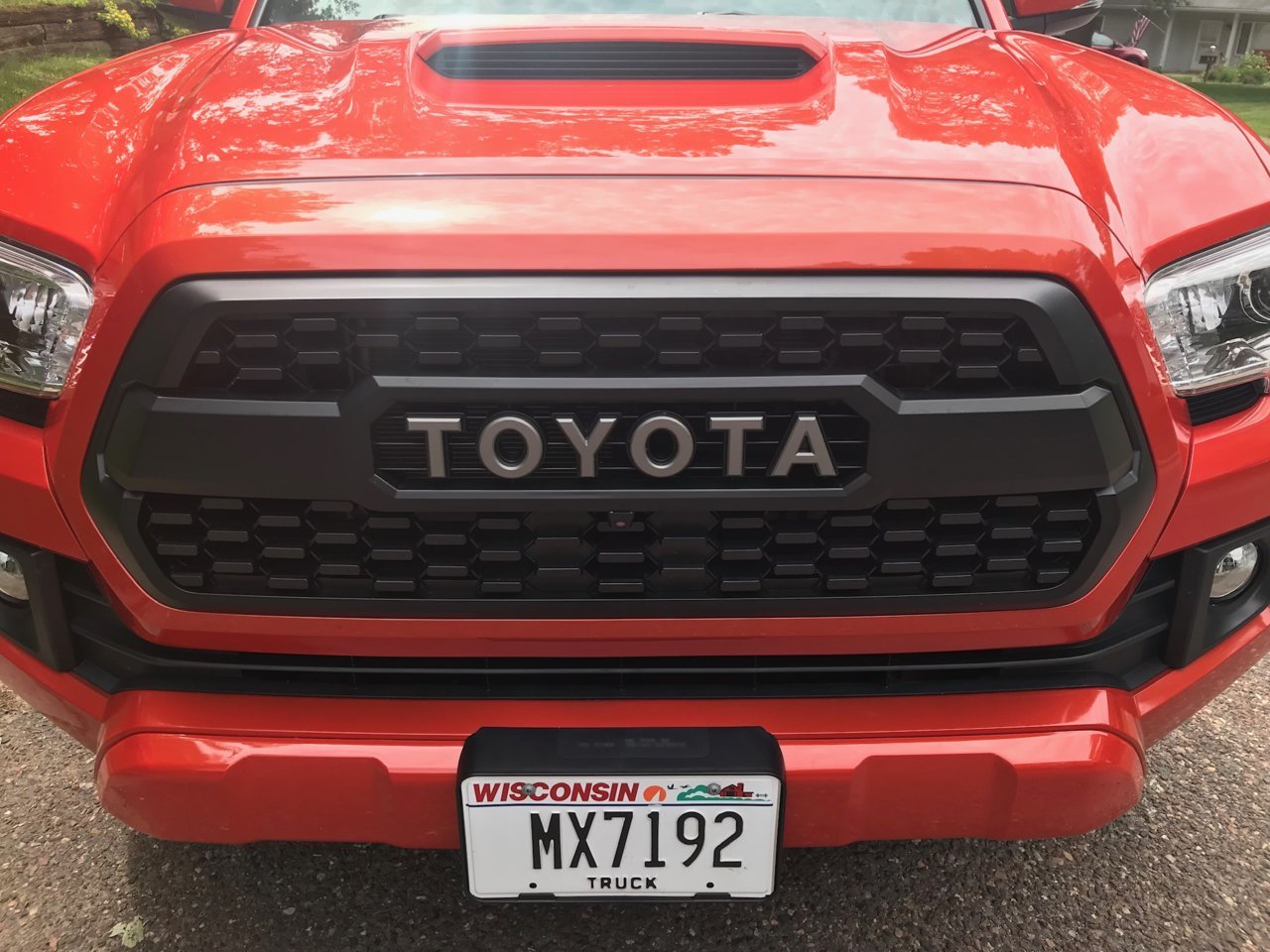

    Regarding the pry tools, I used a Natika front license plate frame camera, and it came with a pry tool. However, I found I didn't need it. One pull on the right end of the radio bezel and the whole thing came off. It might have been useful for remove the cubby bezel, but I had already removed that months ago (used my little pocket knife for a pry tool, worked fine for me but I don't recommend it).
