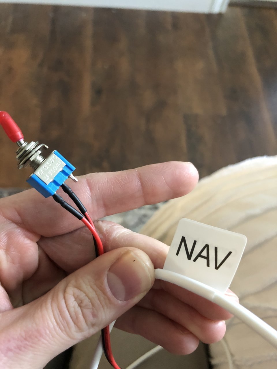

    Those who installed the nav override later, was it as simple as removing pin 17 from the harness and inserting the new override wiring in its place?

    Got my kit with nav override. It also came with an extra small switch and cable labeled NAV. I wasn’t aware of the need for an additional switch for the nav override. I’m thinking I can wire it without the switch but note sure.

    I got the kit without the override months ago then decided to get the override last week. It didn't come with instructions and there's none on the site. A search of this or the other thread didn't turn up any pictures, but I did see a diagram and mentions of splicing the switch into pin 17, the speed sensor wire. But the diagrams also mentioned cutting pin 15, the parking brake sensor wire. I'm guessing I only need to replace pin 17 but I'm not 100% sure; I've had to stop the truck, put it in P, then pull the parking brake to get Entune to turn babysitter mode off.
    Would you mind taking a picture of the whole harness to which that override is connected, with a close up on the plugs? I'd appreciate it!

    I will take some pics for ya. There is also this video
    https://m.youtube.com/watch?v=svDlxas0UGY
    Trying to take pics and can’t really get a good shot without confusing you. Video sums most of it up.

    You rock! That's the juicy details I was after.
