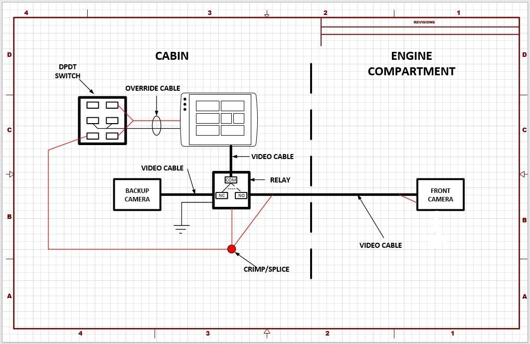

    I used the red tag wire coming out of the RCA cable to provide 12vdc when the relay is energized.

    Okay, spent some time, laid it out and worked through the thread and a couple videos, and got it figured out.
    I'm using the switchpros for a SPST function, and the red on the override harness (black on the older harnesses) will not be needed for one thing. In the way it is set up by anytimebackupcameras for using a DPDT switch (anytime front, anytime rear) it would be used to provide common ignition sourced 12v to the to the common on the switch, but as I'm using the SPro which will provide 12v when switched on, I'm good without the 12v common feed from the override harness / head unit.
    For the other, I see I will be powering camera from the switchpros output (12v when on) to the camera power cord. I will then use the RCA red tag wire at the camera to pigtail into this so that when I hit the switchpro to power the camera, this read wire at the RCA / in the RCA cord will also send 12v back to the cab area and be utilized to both energize the relay coil to switch the relay to the NO contacts for the front camera video feed, and also trigger the head unit to switch from normal nav screen to video (camera view).
    Thanks for the assist. Wasn't clear at first what I needed to do to wire this up differently than the DPDT switched anytime front AND anytime rear set up gave, but I got it once I had a few minutes to clear my head, lay it all out, and check continuity on a couple things.
