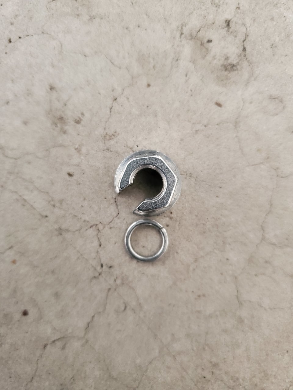

    Afternoon people :) Received my ABC and got everything installed but i have some issue.
    Im not sure how to tighten the nut that it came with, every time i tighten it it gets loose.
    Hope you guys can help me.

    I replied to your PM, but if anyone else has trouble try teflon tape! DO NOT try and crush the nut...or have a new nut and a hacksaw ready. :annoyed:
