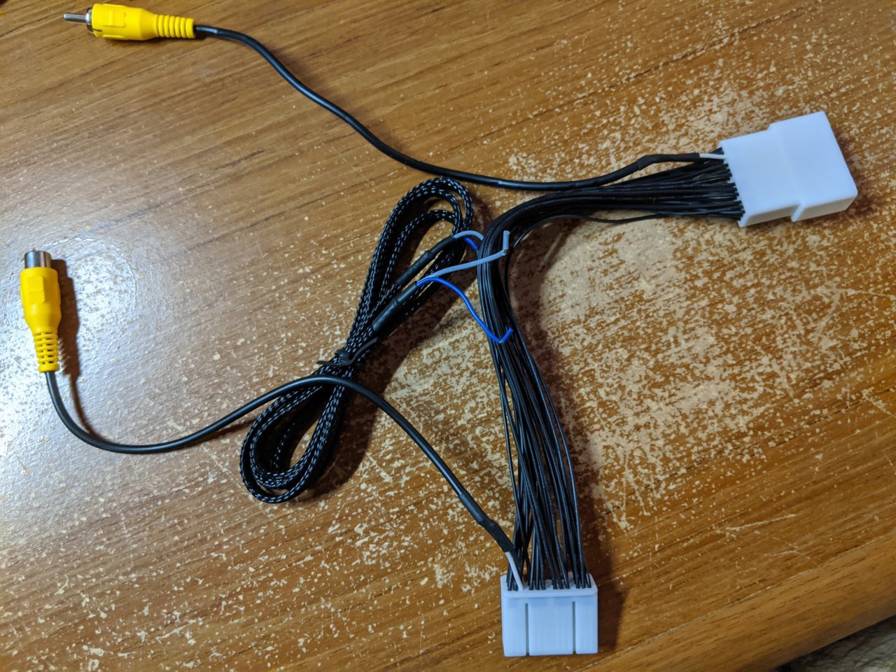

    Where ddid you attached the blue and gray wires from the 30 pin harness (the one with the yellow video cables)? I can't find any information on what to do with them.

    There should be blue and gray wires on the switch harness. Connect them together.

    He doesn't mention the blue and gray wire anywhere, but those are actually provided off one of the radio harnesses so you don't need to figure out illumination.

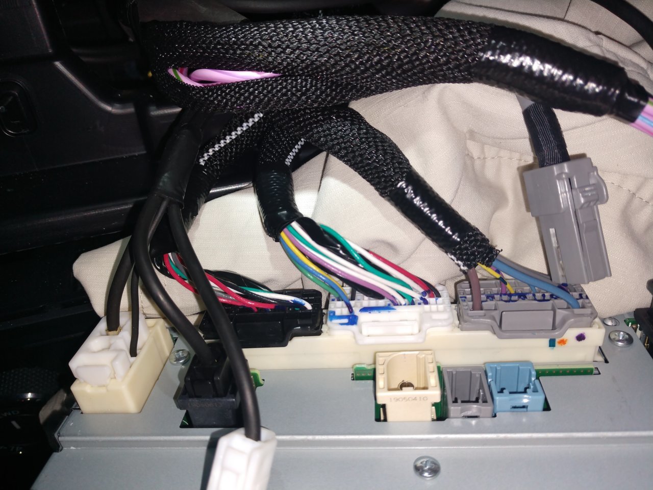

    So I just pulled my head unit off, and discovered that the 2020 connectors in the back do not look like all the videos I've seen, even the ones on the actual Anytime Backupcamera site. On my 2020, I have three of those 28 pin connectors in a row. I have a black one, a white one, and a gray one. I could try to make an educated guess which one goes where, but I really, REALLY don't want to fry my head unit. Can anyone who's put this kit in the 2020 chime in and help my dumb ass out please?
