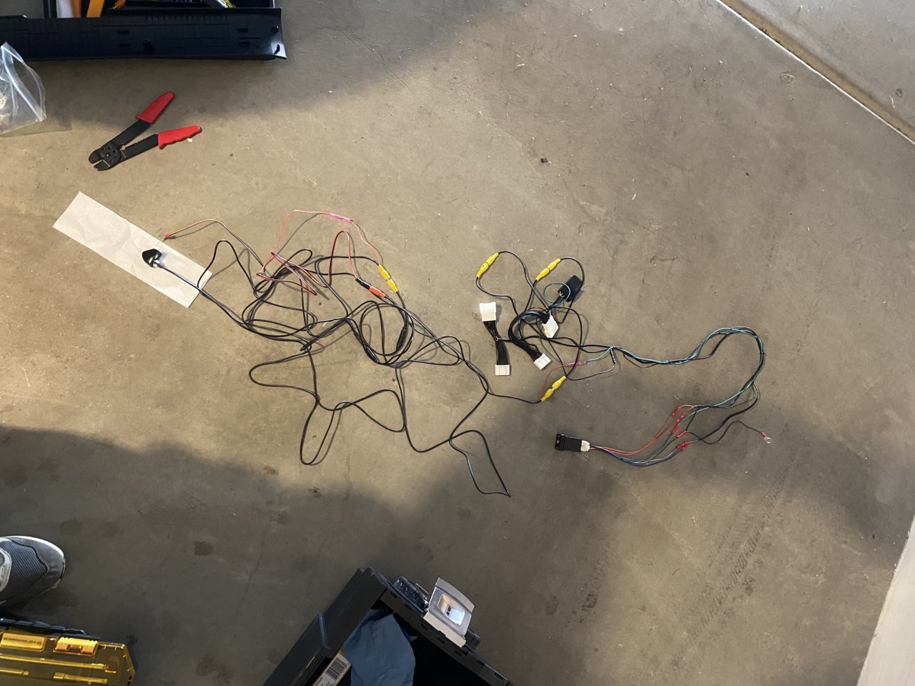

    when i do it that way my head unit won't even power on.....still nothing doing it the other way.....i appreciate everyones help on this! I have sent messages to them 2x through their site and they haven't responded so i guess i'm just going to do a chargeback and throw it in the corner for now

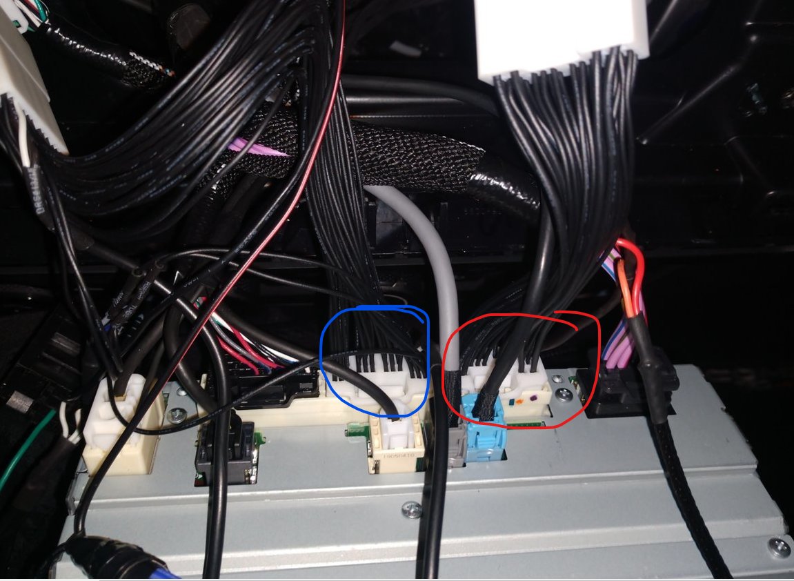

    Your wiring harnesses and attachment should look like this from the inside and have no loose wires (especially the 28-pin override harness... hanging wire should be pushed all the way back into its respective/assigned pin slot) and the ring terminals are attached to car metal body (e.g 10mm bolts on car body frame).
    Remember 28-pin override harness connects to the gray connector and 28-pin video harness goes to the white connector on the back of head unit.

    Not to be overly redundant, but to be sure, in at this picture, you DEFINITELY have the harness with the red and orange wires going to the plug with the red circle, and the one with the blue and grey wires going to the connector with the blue circle, and your head unit doesn't power up? The only thing I can think of is you got a bad wire harness, with a loose connection somewhere.
