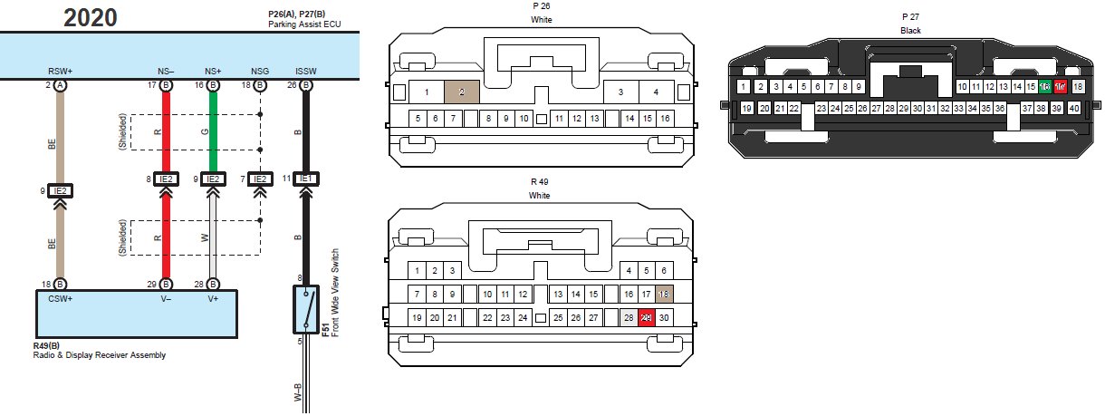

    Here's the whole thing. The camera only gets powered when you flip the switch, which also energizes the relay.
    And when you flip the switch to rear (without shifting into reverse), the orange HU wire gets held HIGH from pin 4 in the switch below. Note: Diode is reverse biased (or blocking).
    And when you flip the switch to front (without shifting into reverse), the orange HU wire gets held HIGH because now the diode is forward biased and allows current to flow from pin 5 to pin 4.
    NOTE: This is for the 2020 setup.

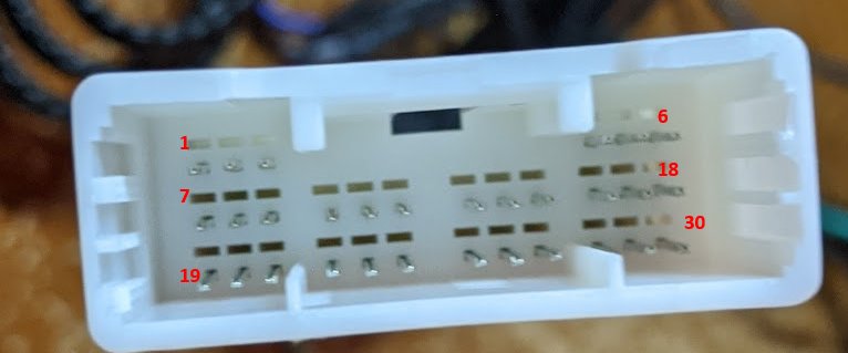

    After looking closer on the schematic, it shows that pins 9 & 10 on a 30 pin connector that does not exist on the Tacoma.
    And the video interrupt does not correlate to pin 12 (V+ on N26 -24 pin )

    So Front Cam (or other) is powered only when SPDT switch allows it. Fantastic. I had that hunch, due to cam staying ON always will heat n degrade it...

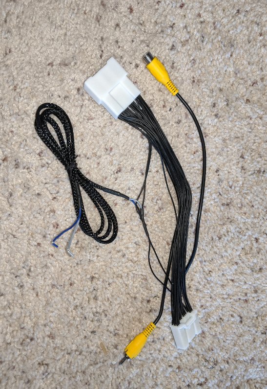

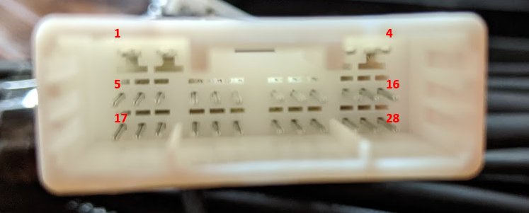

    What do you mean doesn't exist? On the ABC harness? Here's what I have
    And the pinout number convention I used. I couldn't find any part number for these connectors to find what the actual pinout convention is supposed to be, so I made my own.
    *EDIT* Removed attachments due to error
    Also as a note, I haven't installed this on my tacoma yet. I'm working on making an improvement on this design, soon to be ready.
    This is all information I gather from install instructions (from ABC or youtube).
    This is point in the video where he connects 2 greens and 1 red (for camera power) together.
    https://youtu.be/tTH6w7pColg?t=255

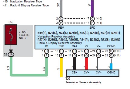

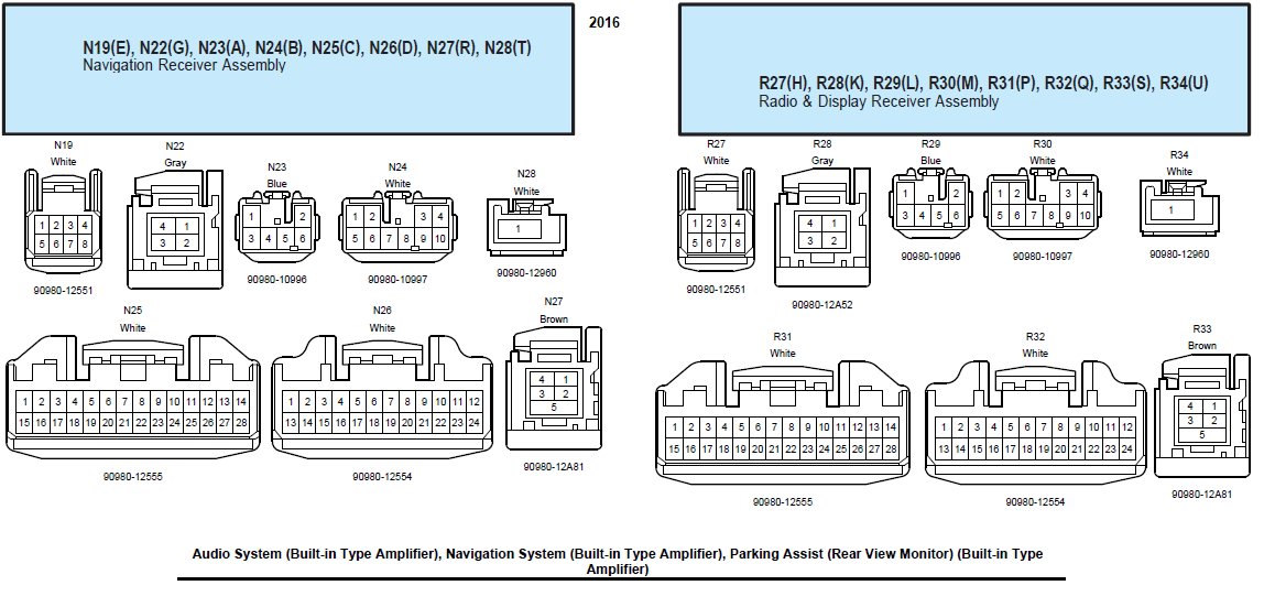

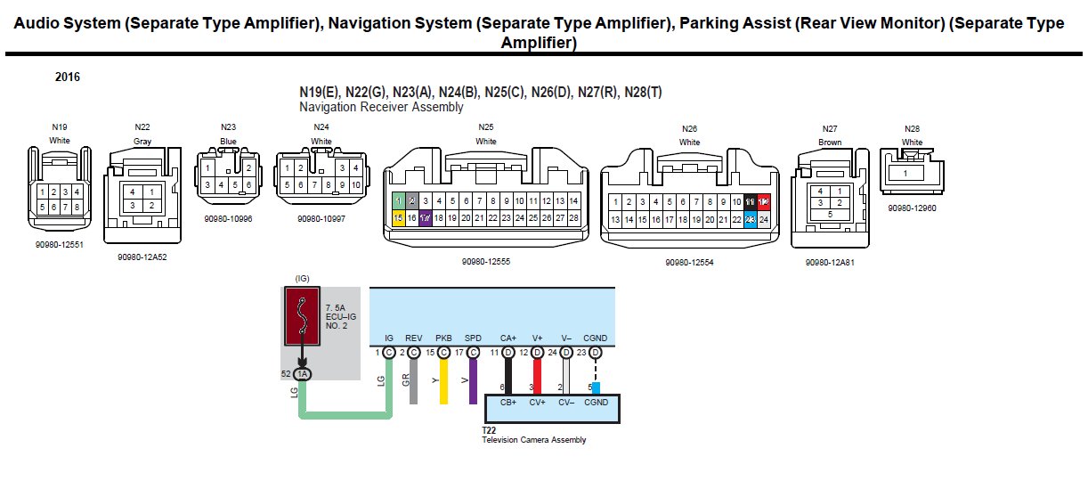

    Ahh, that might be where the confusion is. My setup is for the 2020, should have mentioned that earlier. The 2016-2019 have a different setup as shown in these images.

  10. Mar 3, 2020 at 6:20 PM
    #990
    empty_space
    empty_space Well-Known Member
    Dec 28, 2019
    #314493
    91
    That helps, thanks! Looks like I had my numbering scheme reversed. I was basing Pin 1 on the plug and not the receptacle.
  11. Mar 3, 2020 at 6:40 PM
    #991
    caribe makaira
    caribe makaira Well-Known Member
    Feb 13, 2011
    #51121
    11,789
    Caribbean, Puerto Rico
    05 PreRunner TRD Offroad AutoTrans
    Hood Struts, My version Fogs always ON, Map & Overhead Light Mod,
    The connectors are numbered as if looking into, not from behind...

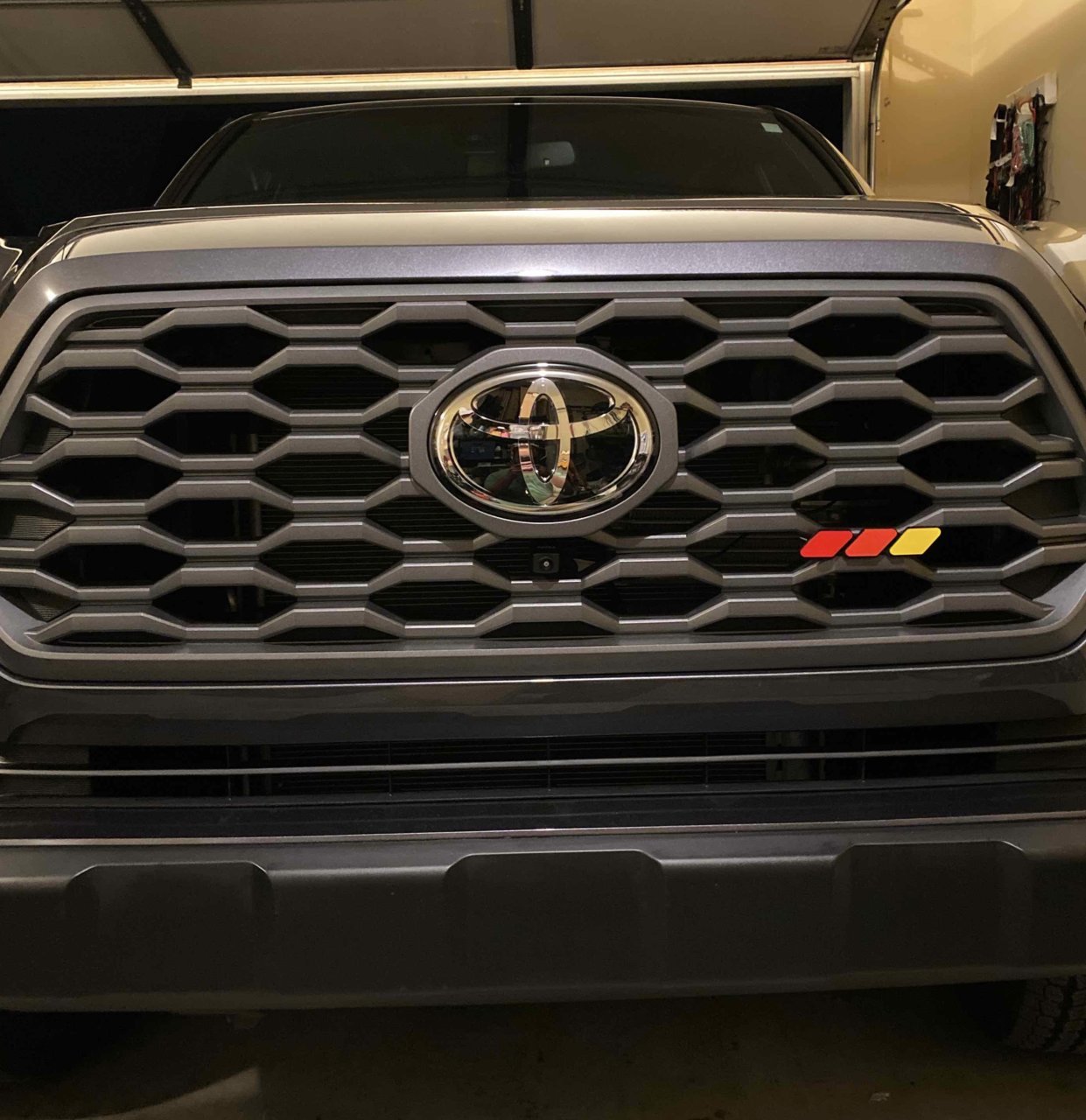

    Got mine installed today on a 2020 TRD grille, thanks to @Toyotako for the camera suggestion and was able to replicate the bracket he had made with a small strip of aluminum, with a little plastidip it looks great and nice and hidden.
