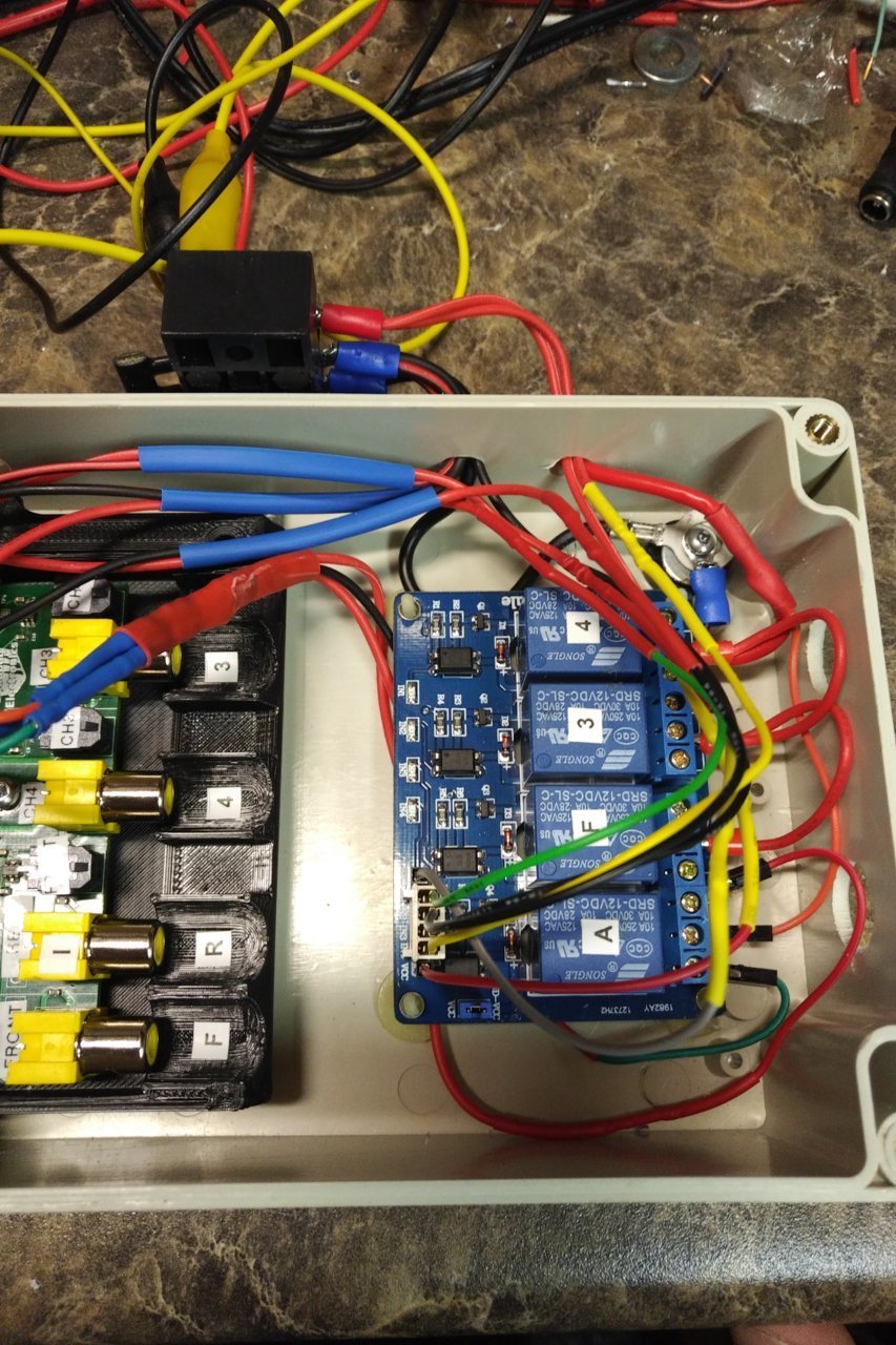

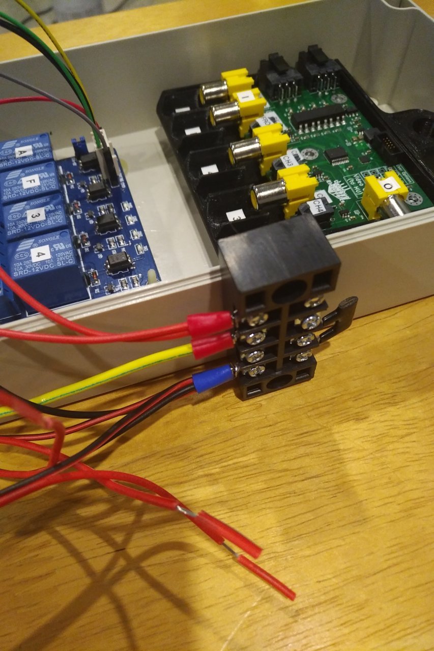

    I have it working on my bench. @empty_space and I designed an LED readout for each camera signal so the install was delayed until I implemented that as well. Hoping to get installed later in September when it is not so hot out during the day. This will involve pulling my front passenger seat to install the project box underneath it as well as running wires to the front and back of the truck. The 3rd and 4th cameras are mounted on the rear of my Billiebar and the rear of my pop-up camper respectively.

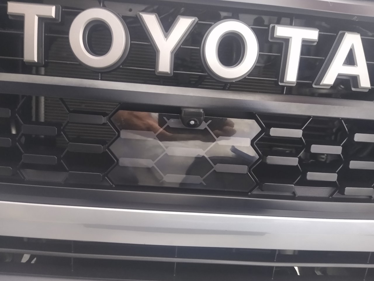

    Finished up on a camera mount that I’ve been working on. I didn’t want to drill my pro grille so I made this mount to fit the camera inside the “O” of Toyota. I used the Raayoo camera from Amazon and did not use the flush or bracket mounting trim pieces. The view just shows the edges of the bumper on the bottom left/right sides
    DEDE156B-C948-41A0-AC56-33C5CFA15083.jpg 88CF2320-6CB6-4FC5-B2CE-E70054642A97.jpg 0853B1A1-DA5E-4C8A-9AC9-D1860168B4D1.jpg BA6761CA-C4DB-47CC-BBC1-2F4635D9CCF0.jpg
    I used the ABC kit and didn’t have any open small switch spots so I also made a 3-switch panel to replace the cubby on the left side of the steering wheel. The small push button switch is for the nav override

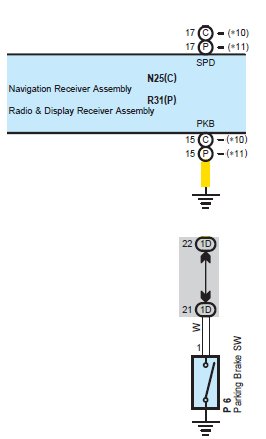

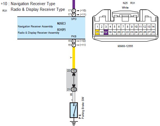

    What is the mod he has to overwrite the motion for the nav?
  17. Jun 10, 2022 at 6:55 PM
    #1177
    caribe makaira
    caribe makaira Well-Known Member
    Feb 13, 2011
    #51121
    11,811
    Caribbean, Puerto Rico
    05 PreRunner TRD Offroad AutoTrans
    Hood Struts, My version Fogs always ON, Map & Overhead Light Mod,
    Disconnecting the speed sense wire, insulate ends and grounding the parking brake sense of the head unit.
