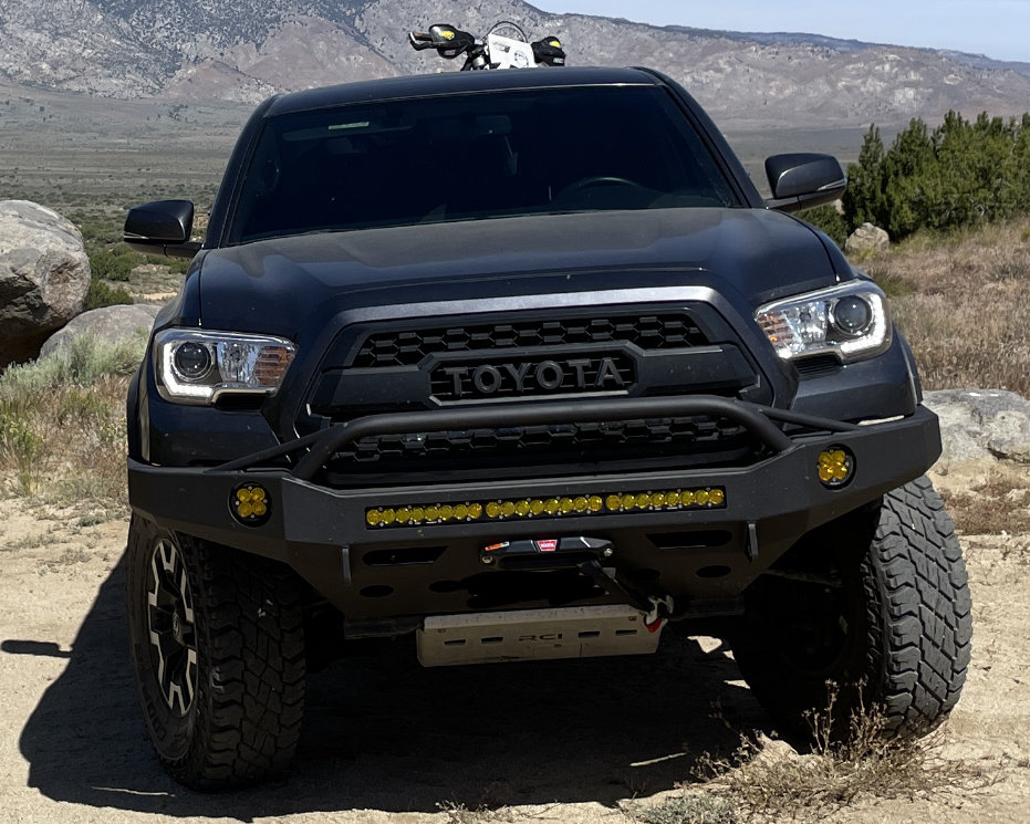

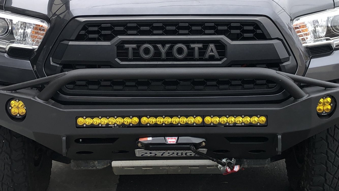

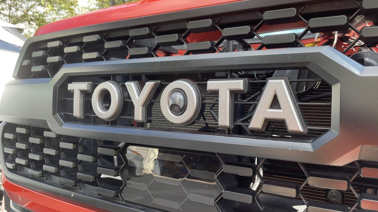

    Ok this is another thing I bought a few years ago and finally looking to install. Part of the delay is me avoiding the meso LSP7 install for this switch.
    I looked through this post and site and don’t really see any clean installs where the bull bar blocks the original location.
    The 3D printed mount in the O seems kind of slick…I don’t have a printer.
    Anyone mount the cam horizontally near the top of the grille?

    i have mine through a hole i drilled on my grill on the horizontal piece above the "toyota" logo. (my grill was cheap ebay knockoff so i didn't feel so bad). and it's held super well and gets great picture. granted, i think my camera burned out from getting constant power so I need to revise my system and get a new camera. lol.

    Any chance you could post a pic?
    My grille is a knockoff too in the bar made it almost impossible to remove.
    I thought that still might be blocked but maybe not.
    Do you know if the connector for the cam ends up in the engine bay?
    If it does then that’ll make it a lot easier to try different locations.
