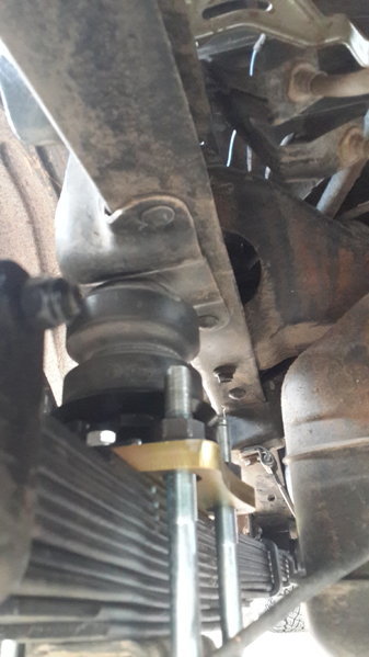

    Here is a photo of one of the stops.
    Biggest problem I have is the AP 1.5" Add a leafs handled better and gave more lift than the 3" standard pack with the same weight in the back. I've done a number of Tacoma lifts and this one just has me scratching my head.
    Pretty sure these leafs will be pulled here in the next week.

    The OP called in this morning. We asked him to send in pictures of the springs, like shown above, and also of a picture of the truck so we can see his set up and see what is going on. We do warranty springs that are not performing correctly.
