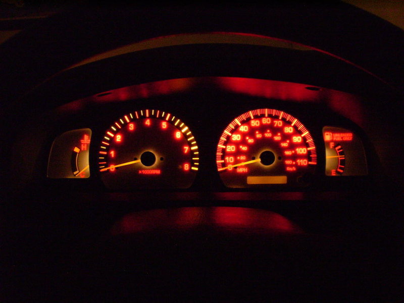

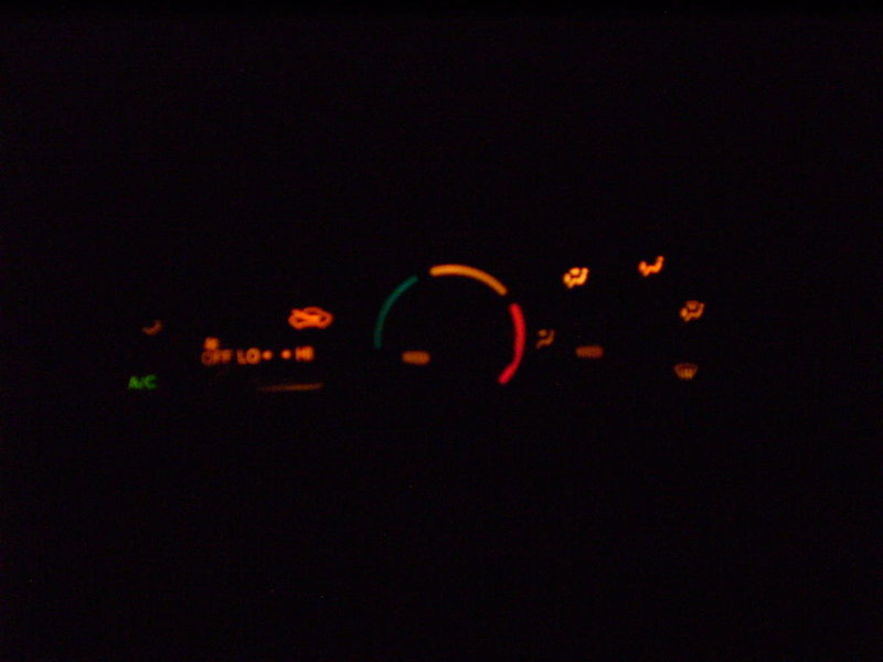

    No problem. Put mine in today. The red numbers look pretty cool. Don't forget to take the green rubbers off your your bulbs (the four 194's). I put some Sylvania Silverstars in as they are whiter and brighter ($5.99 @ Wal-Mart). There are 2 rubbers on the micro bulbs behind the climate controls as well. This will get rid of all the green glow and turn the A/C panel lights white to match the speedo, etc.
