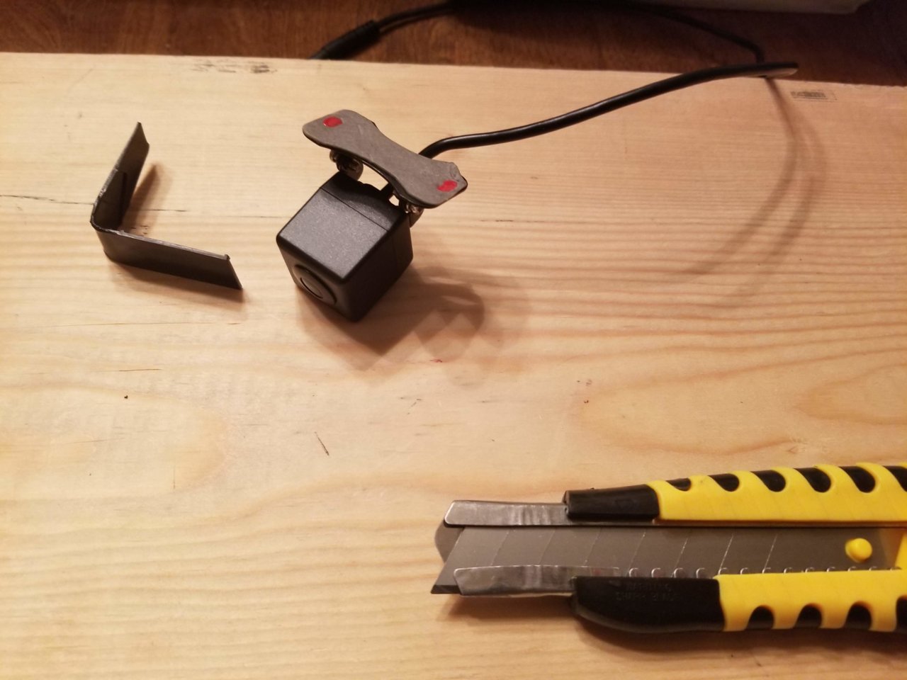

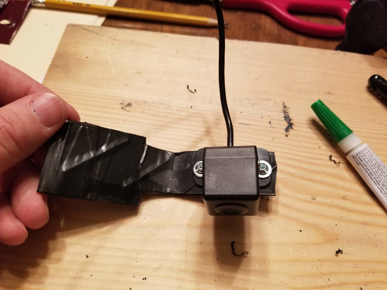

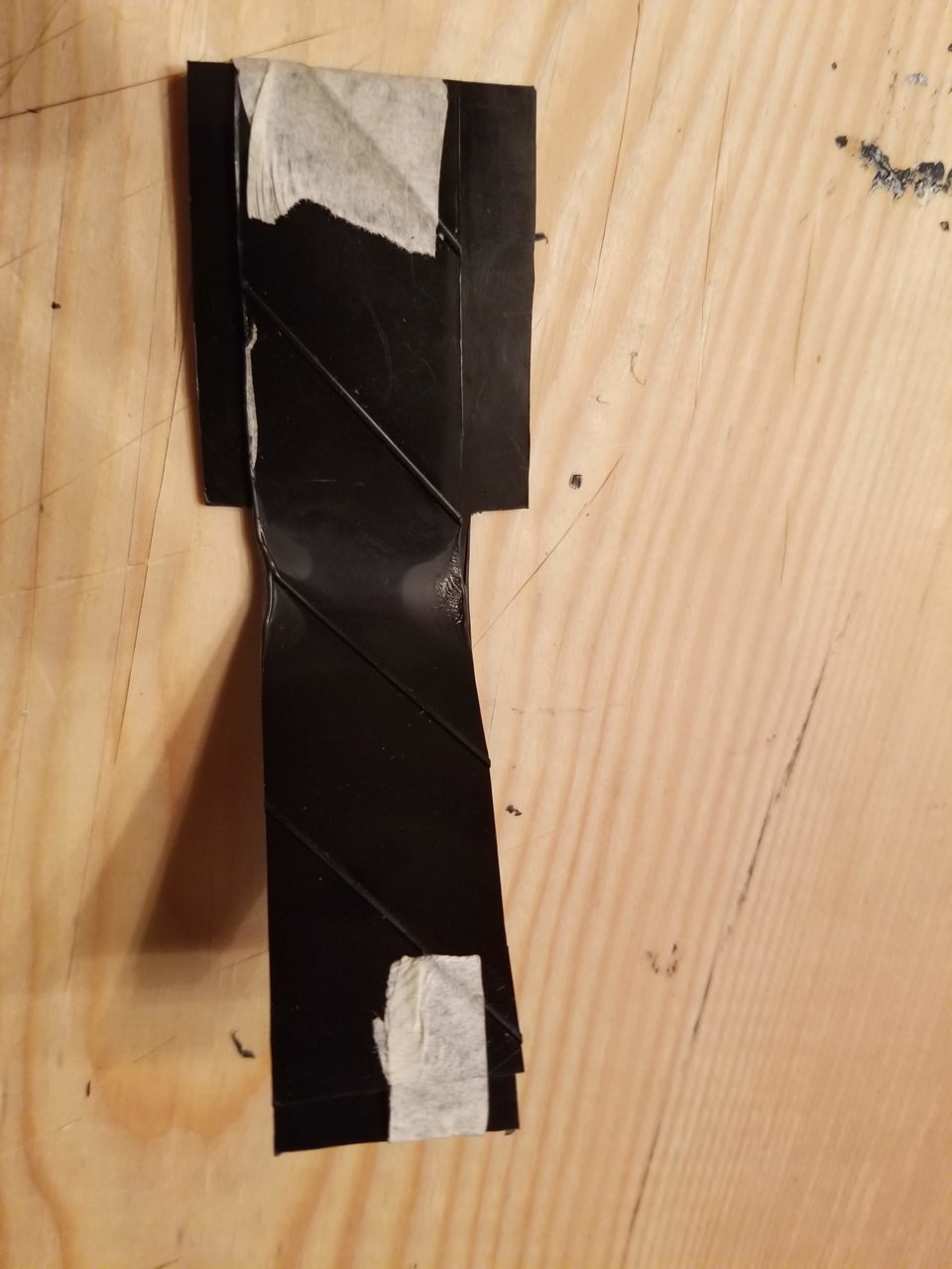

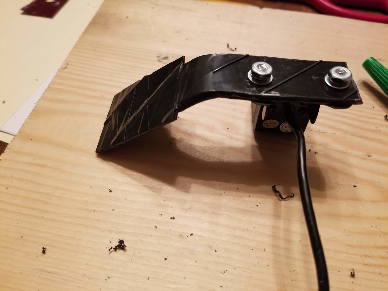

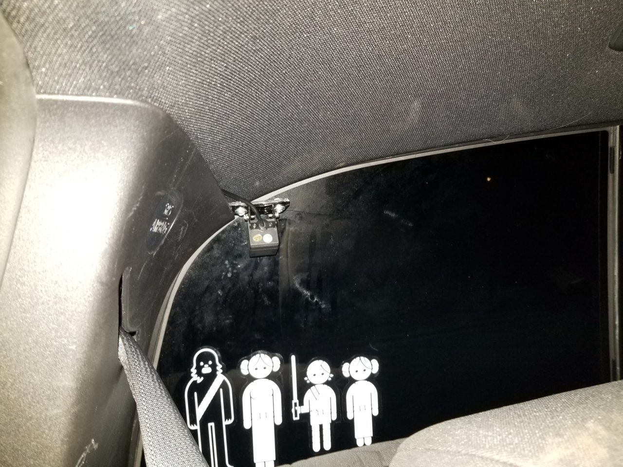

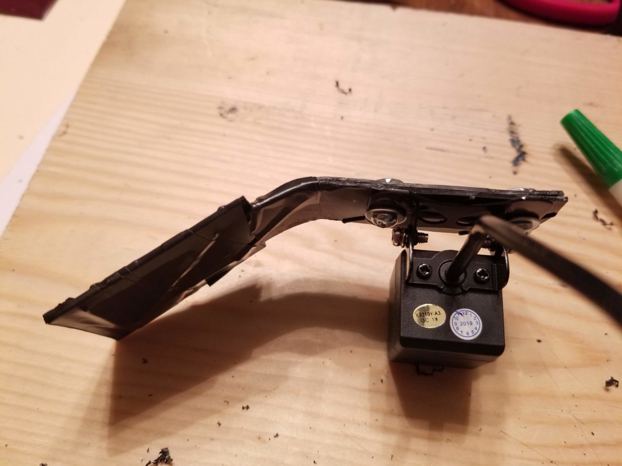

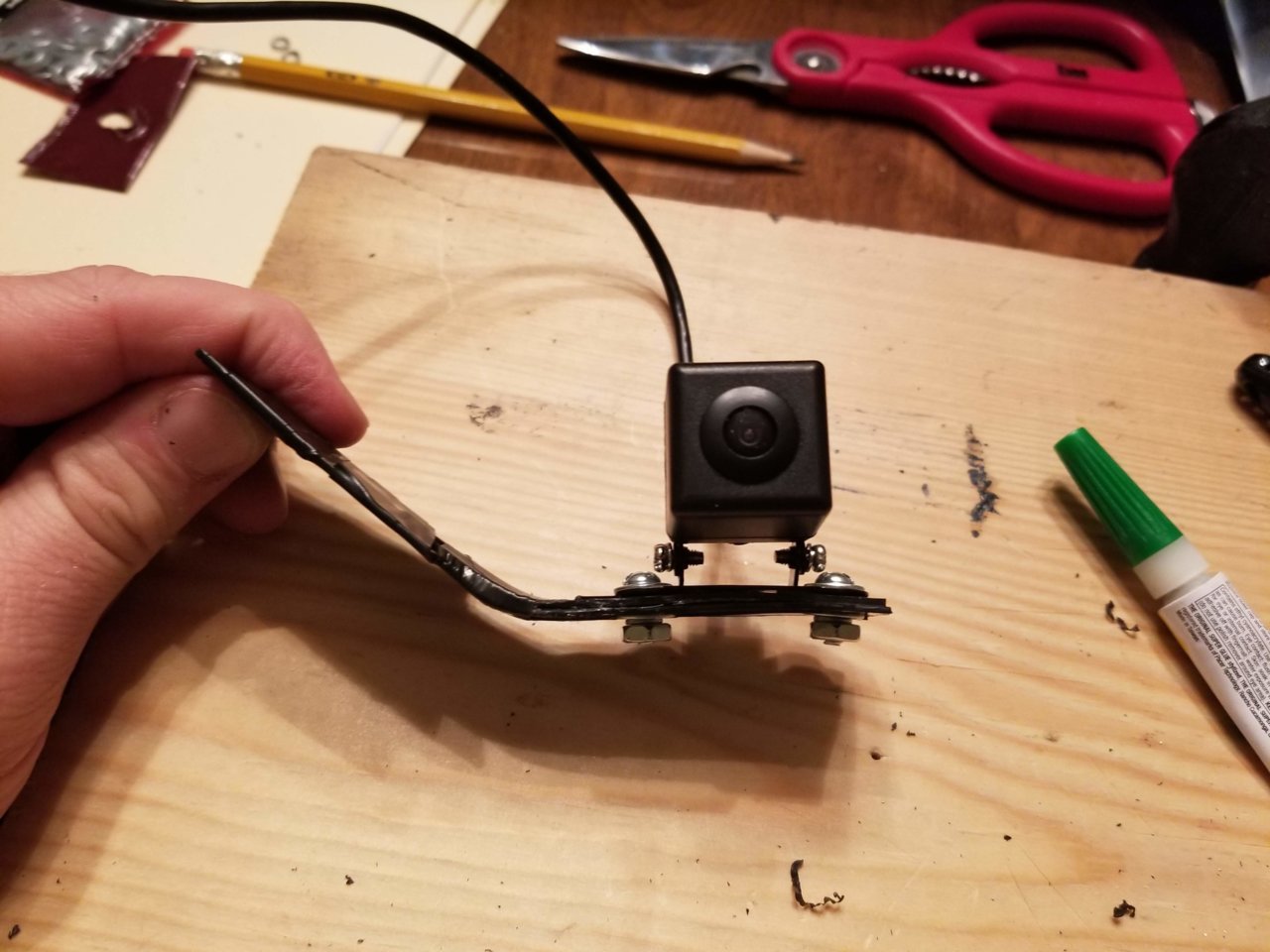

    The next problem was the rear camera mount. This model is setup to mount and hang or sit above the surface, like on a bumper or below an overhang. This does not mate well to the rear window. I tried just tucking it in to the trim with the 1/4 lip form the mount point, but this gave a VERY angled view that I did not care for.
    Tonight, I set out to build a mount for the rear camera.

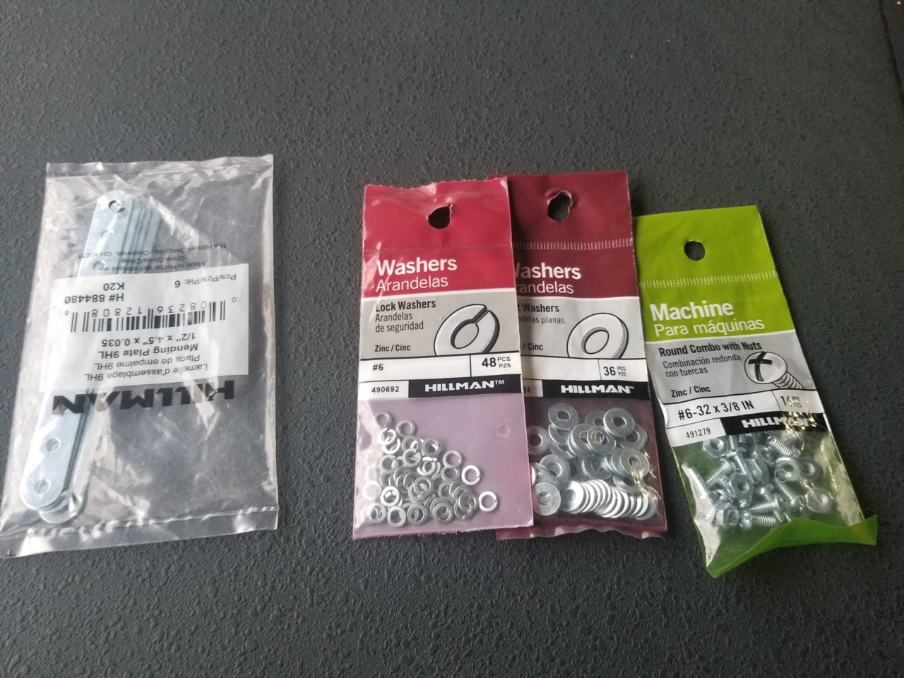

    I started with the idea of a hobby or angle bracket that I could bend and drill...This proved to be overkill. Angled brackets were too thick, while the hobby plate snapped when bent (pictured)
    I then headed to three hardware stores looking for plastic sheets or strips to bend and drill. I only found one option that was more than I wanted to spend for some plastic.

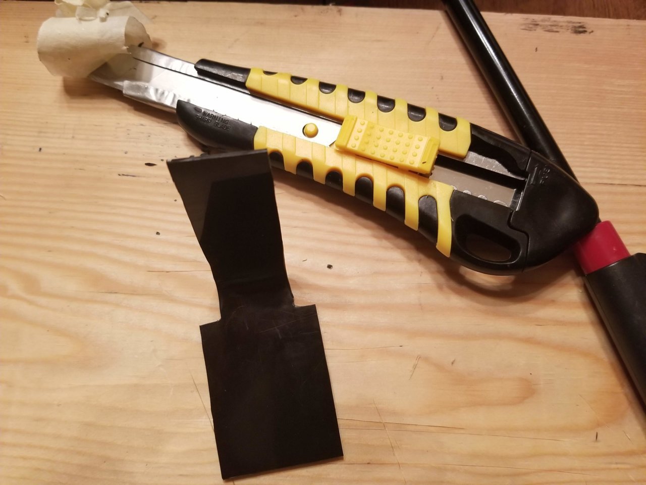

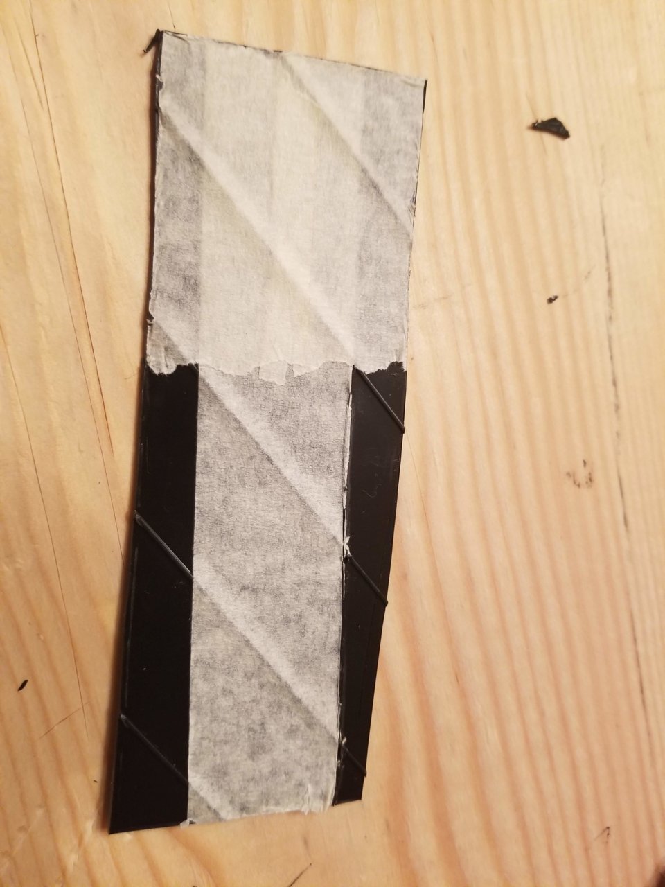

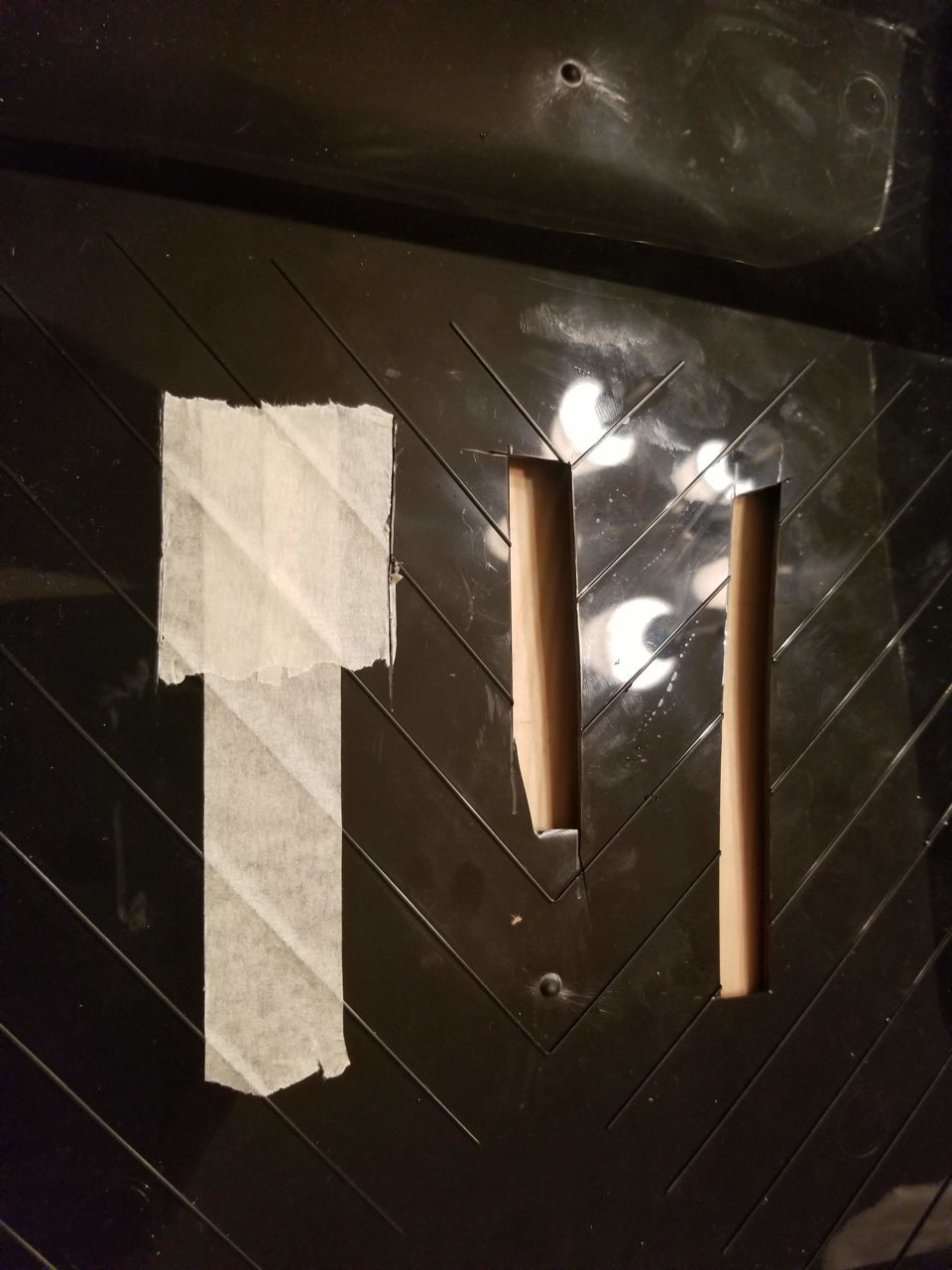

    I then, decided to go the dollar tree and find the largest, most durable hunk of plastic for a dollar!
    I found a black paint roller tray and decided to try to make a mount. My first one was too short, too narrow, and I bent it too far.

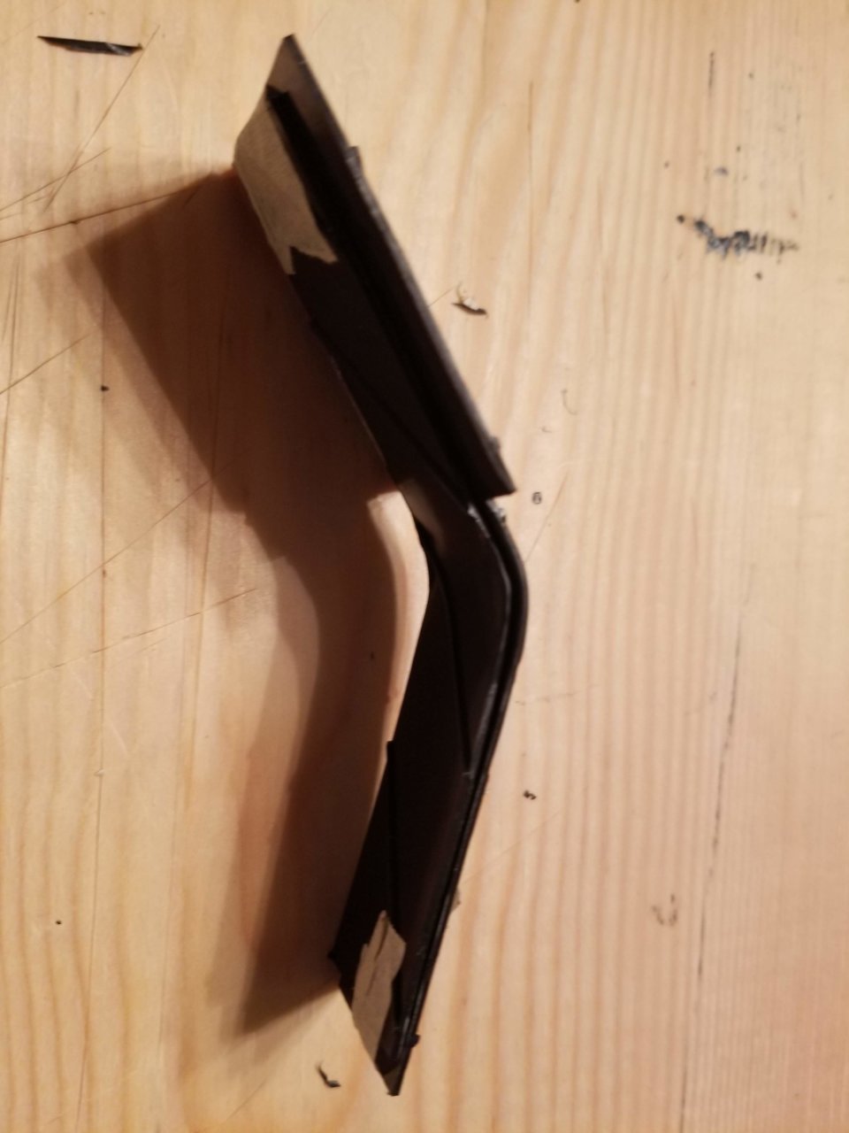

    I then decided to make a new cut out with two layers and wider base to tuck in to the trim.
    20200204_185457.jpg 20200204_191331.jpg 20200204_191327.jpg20200204_195459.jpg 20200204_195502.jpg 20200204_195507.jpg 20200204_195508.jpg
    With the right heated bend, and the proper alignment, the image is much straighter and seems secure.
