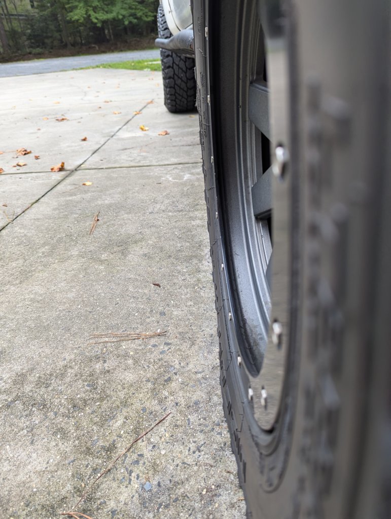

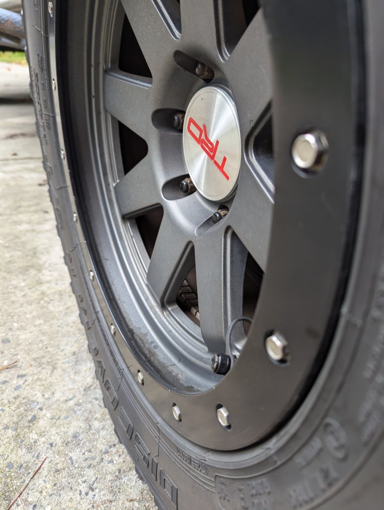

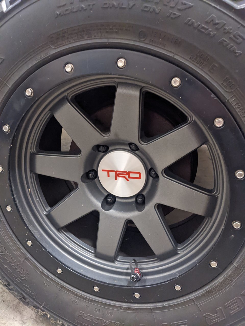

    I have Standard lengths on my SR8s

    Thanks. I ordered the standard length. Wheels look great.

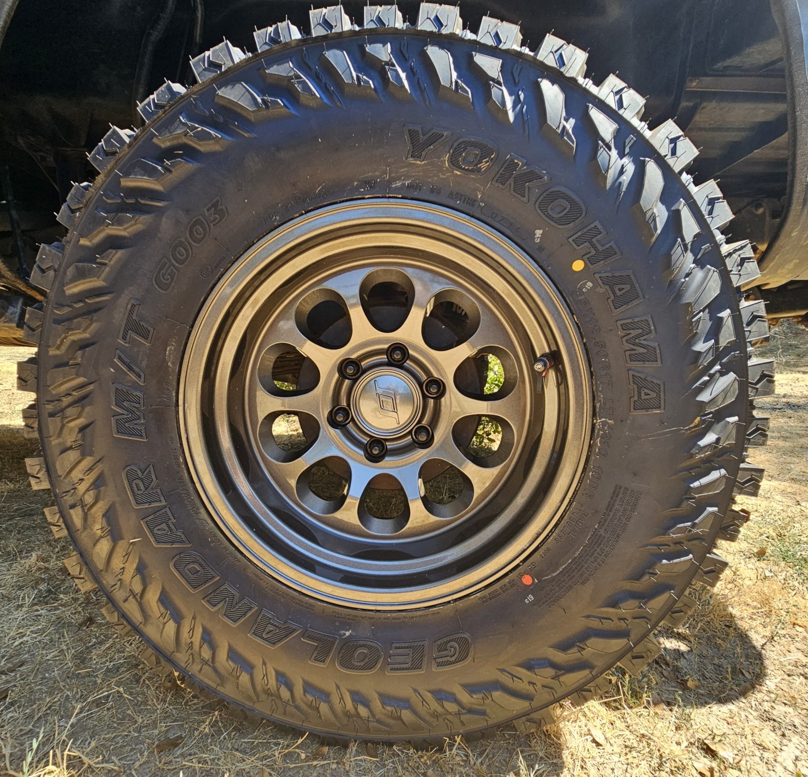

    I really like these valve stems because you can air down so fast but one downside is that they are a little on the long side. I have the regular size but depending upon where the hole is on your wheel they stick out slightly pass the edge of the wheel. At least they do on my SCS Wheels. I was doing some hard rock crawling and tight trails and I broke two of them off. I have since removed them from set of wheels that have 35 on them but will most likely use them on another set of BFG all terrains I have in a 34.

    Digging up an old post, but are those SCS wheels you’re running? Do the valves stick out past the outer lip of the wheel? I hope not. I run the BR6’s myself.

    Yes, they are SR8s and the valves don't stick past the outer lip.

    After looking closer the Apex stems don't stick past wheel but are about flush. I think scs wheels like ray 10 or BR that have the fake bead lock ring will provide more protection. However if you scrape rocks really hard I think a flexible valve stem is a safer bet. Also if you do break a Apex stem and need to do a quick trail fix with something like colby valve stems then you need a drill in or to remove the Apex stem without having to break bead of tire which would be a pain. When I broke the first stem I just swaped out the spare tire but the second one had to drill it out. I was very lucky someone with me was carrying extra valve stems and a drill. If you break a cheap rubber valve stem you can just yank it out with pliers put a new Colby stem in. Much easier.
    One more thing. I did have an Apex stem malfunction where I could not get the lever to pull. It was super tight and would not release. I do miss the 12 sec air down...
