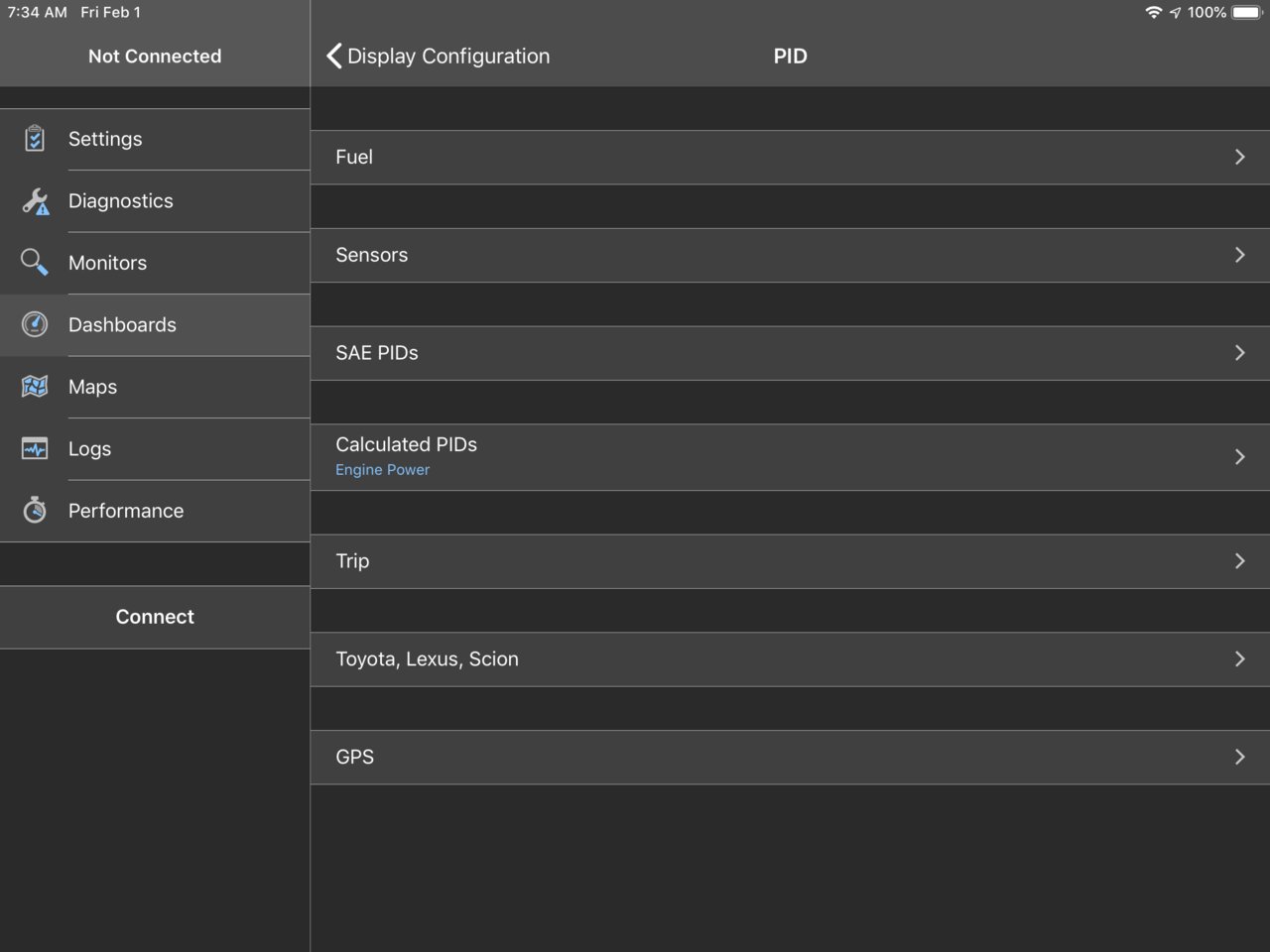

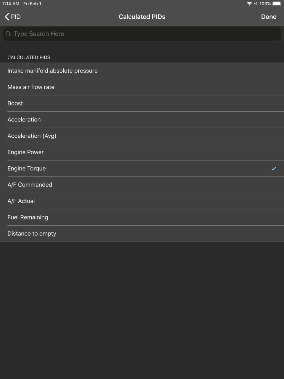

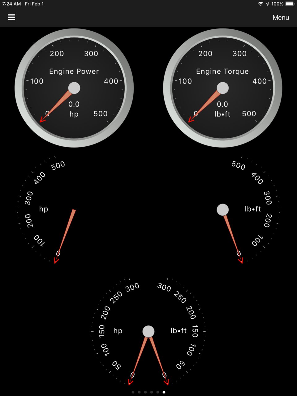

    I used two separate PIDs and merged two gauges together to make that one combined display. Both PIDs come from the “Calculated PIDs” selection within Dashboards Menu -> Add Display, Display Configuration... see below:
    I made two radial gauges, modified the gauges from the ”Edit Display” page, and finally merged the two gauges into one using size and position:

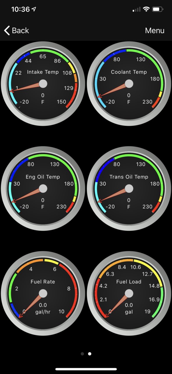

    I run a Bluetooth dongle off of Amazon that I think was about $10, then the OBD Fusion. My gauges indicate intake air temp, coolant temp, engine oil temp, AT oil temp, fuel rate, and fuel on board. Those are available through the Toyota sensor purchase option, which I think was $20 but I might be wrong on that.
    Eventually I would like to get my gauges tuned to the extent that Tacoma3rdGen has his with the color arcs, but I haven't sat down and looked at how to do this yet.

    I would love to eventually go through and customize my gauges similar to yours with some of those nominal and warning band colors.

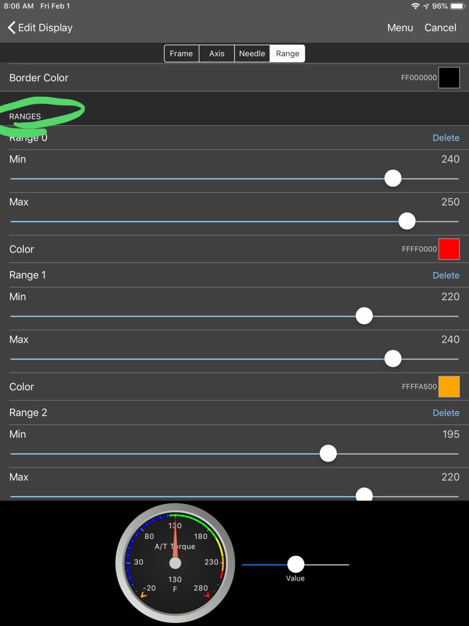

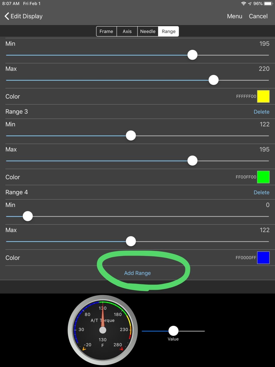

    Easy, let me get ya started...
    On the dashboard you made, touch and hold the gauge to begin “edit” function, then select “style”
    Then select “range” from the top of the page:
    Scroll down to ranges, and build as many as you like... note; you set the values to the warnings you prefer... customize as much as you like!
