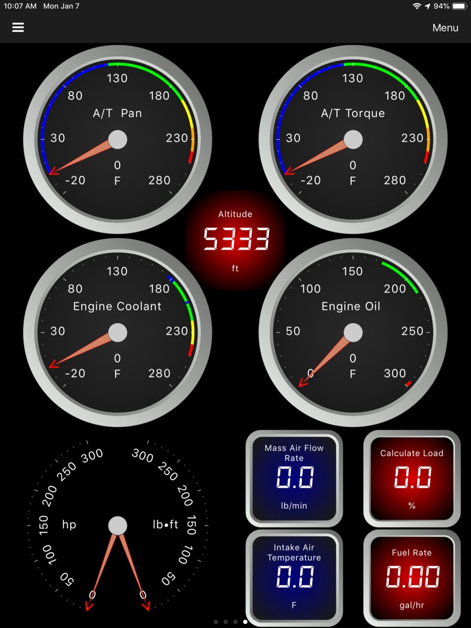

    I’m use with iOS (also has Toyota expanded info available) and KIWI reader over WiFi connection... many options, just read the website completely to verify best configuration for your hardware. Below example of custom dashboard that I use for towing:

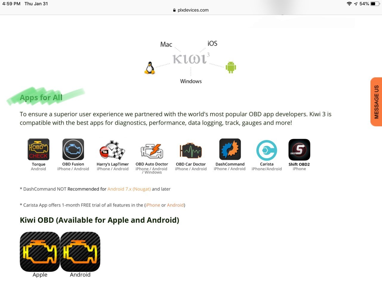

    I’m using the PLX Kiwi 3, a little pricey but was selectable by make/model in the software and has been excellent so far (stays connected during drive). Can be left in the vehicle OBD port full time without issue as well, see below:

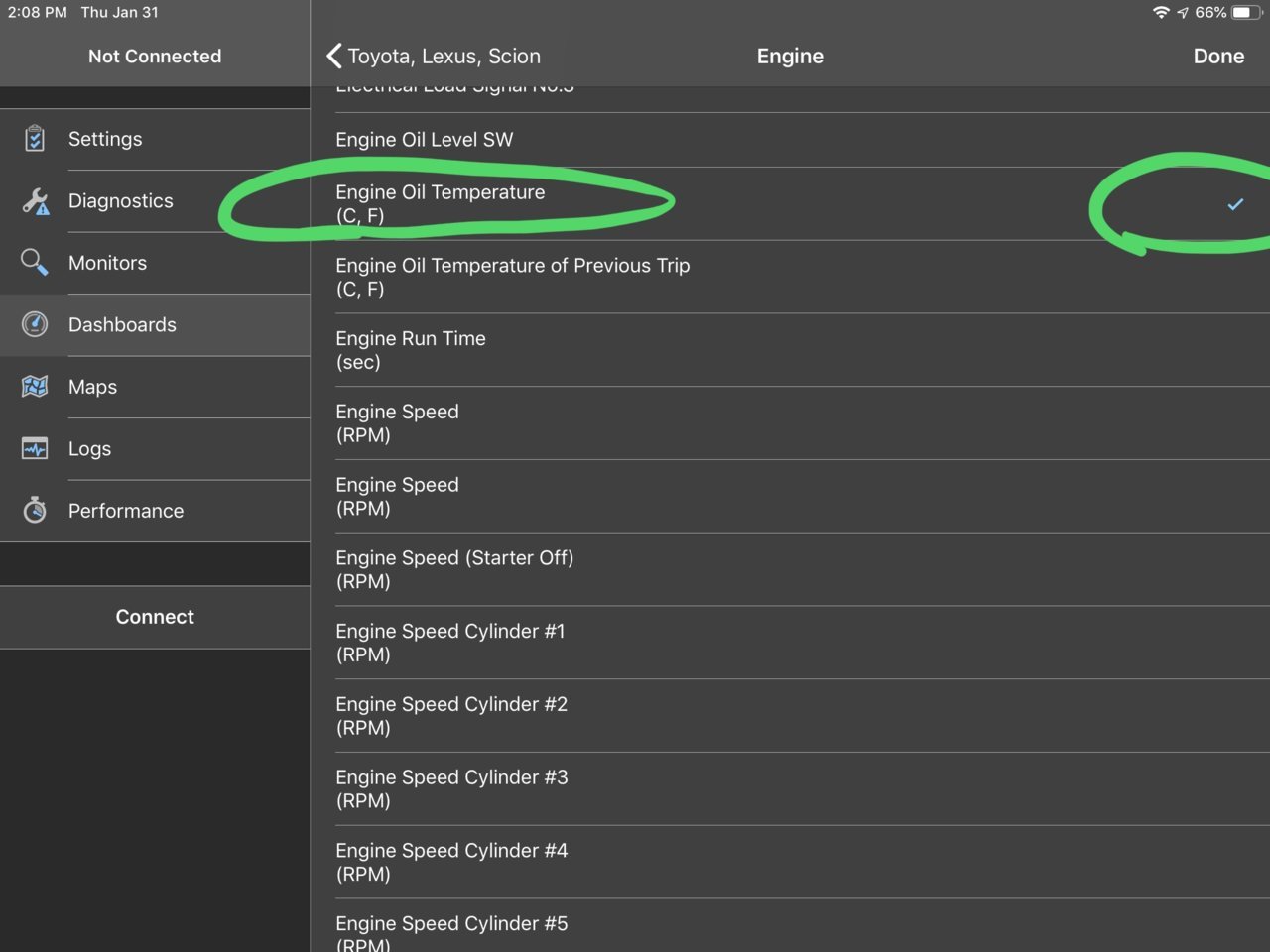

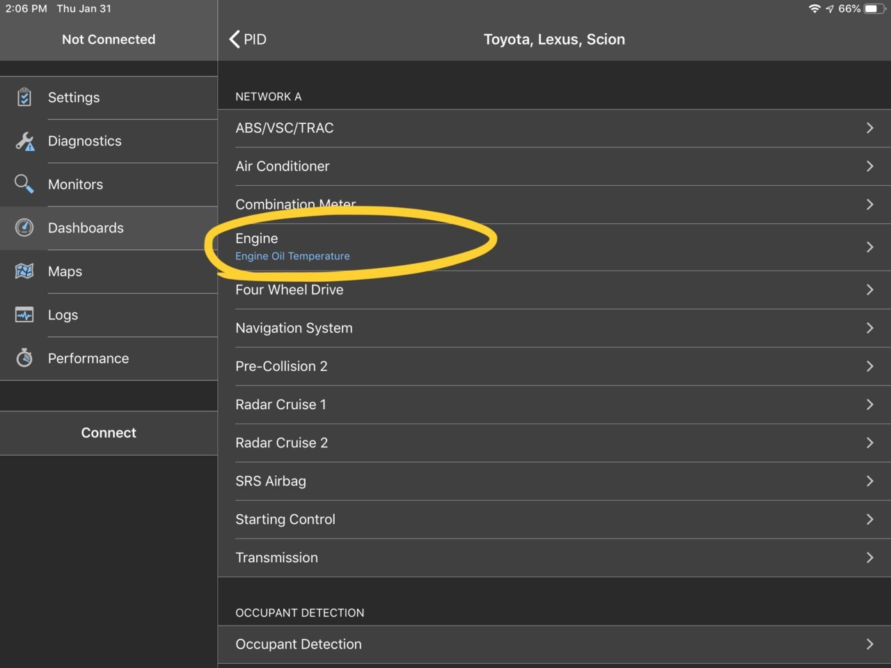

    Yes... you can find that pid in the Toyota specific section (in app purchase)

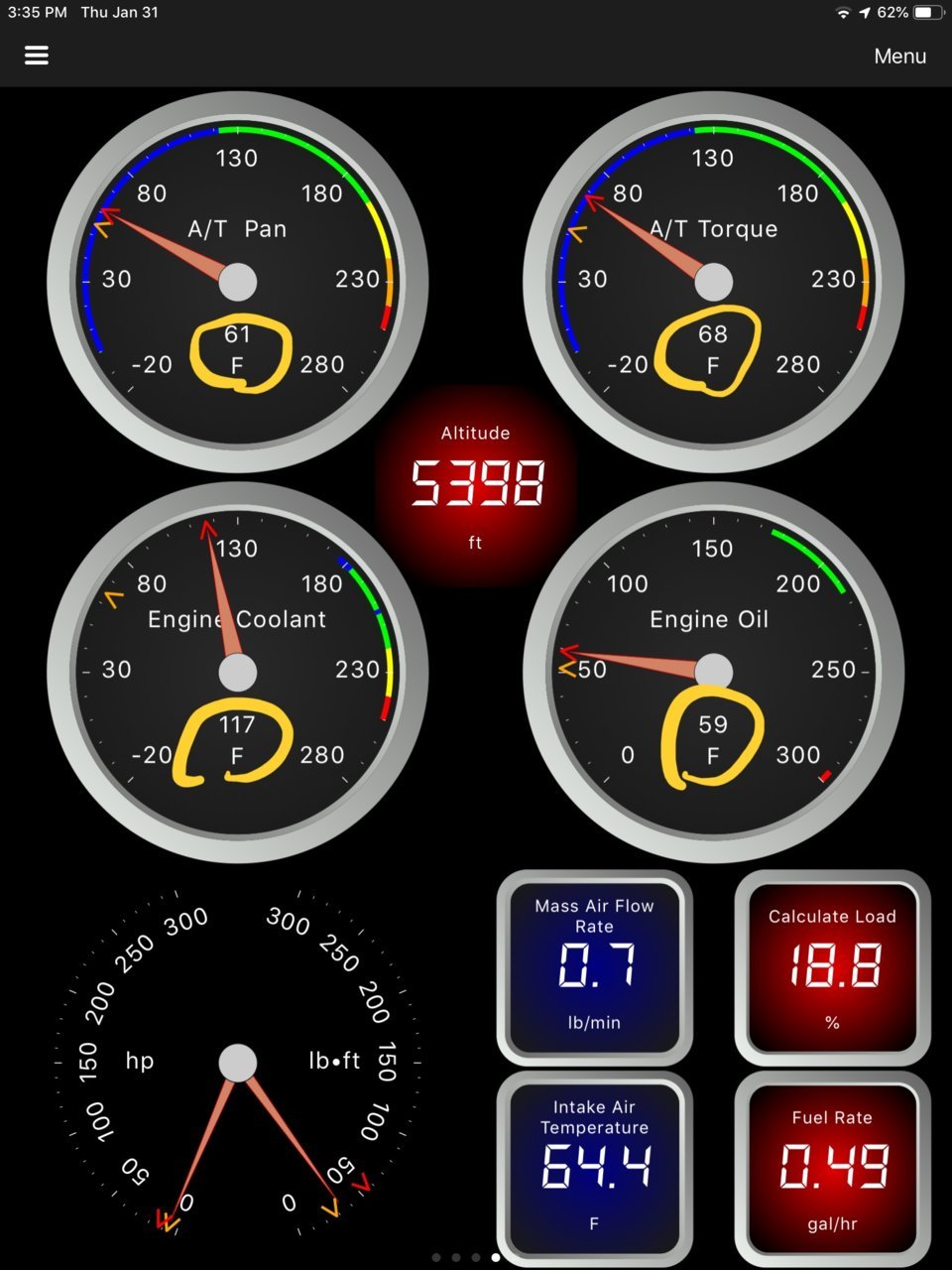

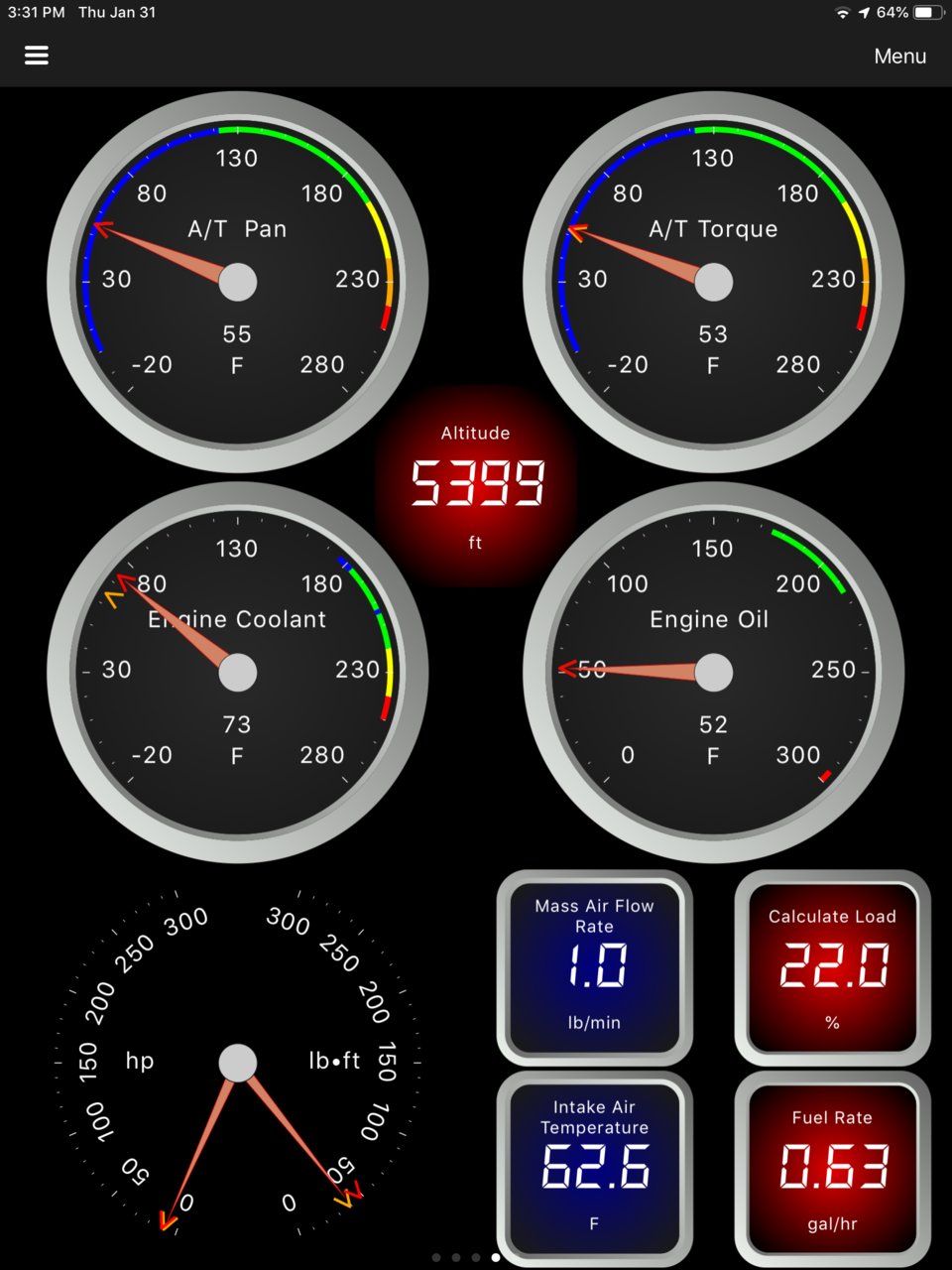

    Sure... 1st screen shot at engine start, 2nd after 5 minutes of warm up. Note: orange caret on arc is start point, and red is highest that cycle:

    Thank you. Are you able to read the PID number and what module it's coming from?
