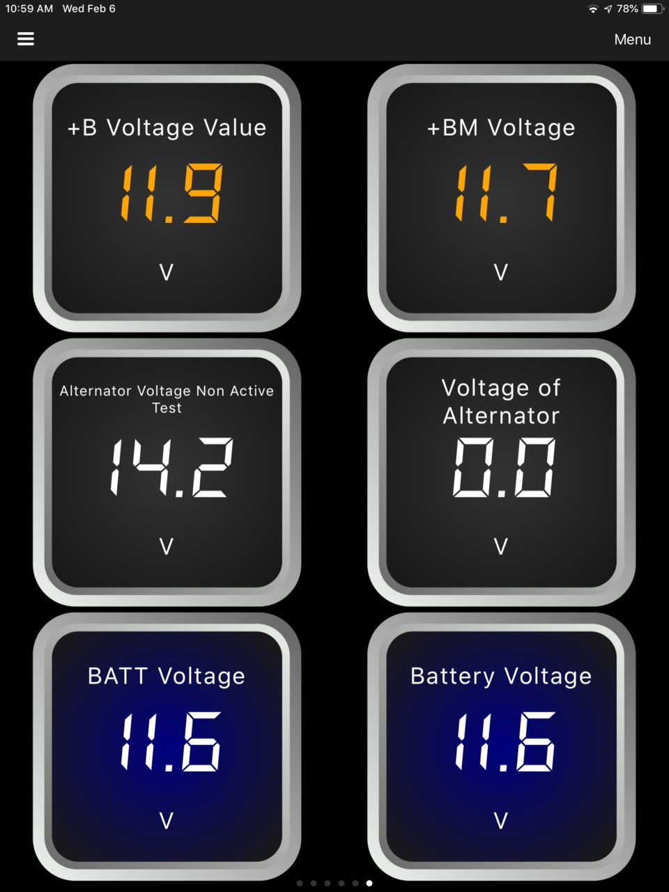

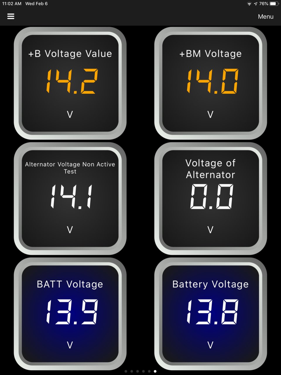

    So I made a dashboard with all of the battery and alternator output PID displays for the Toyota specific pack; from left to right, and top to bottom (no edits made to labels):
    +B Voltage Value (from Network A Combination meter menu)
    +BM Voltage (from Engine menu)
    Alternator Voltage - Non Active Test (from Engine menu)
    Voltage of Alternator (from Engine menu)
    BATT Voltage (from Engine Menu)
    Battery Voltage (from Engine Menu)
    Below screen shot after connection to OBD2 and BEFORE engine start:
    Next screen shot after start, and at idle for 3 minutes
    Notes:
    All values changed during the run time +/- a few decimal points, except “Voltage of Alternator” which never registered a value other than 0
    “BATT Voltage” and “Battery Voltage” are two separate selectable PIDs, and show different values at times... but may be the same sensor, just software responding/displaying slowly during refresh of values (not 100% on that).
    “Alternator Voltage Non Active Test” displayed 14.2 BEFORE engine start, but did fluctuate +/- 0.1 on occasion during run time
    I’m not an expert on PIDs like some of our other TW members, so I’ll need to do some homework on what these specific ones are actually measuring... not sure if this helps your “never over 13.0 volts” concern, as I’m not sure I’m getting an alternator output either, although I believe the +B and +BM values are alternator related based on displayed value of over 14v. Therefore, I will continue working towards a better answer...

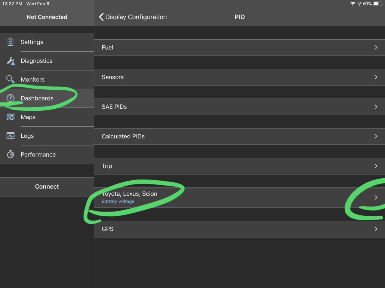

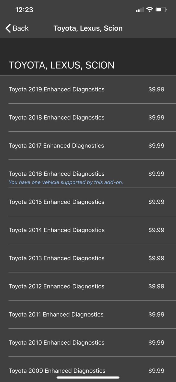

    I checked that one just now... got an average of 13.7v. The other PIDs use are from the Toyota specific “enhanced diagnostics” for a $9.99 in app purchase (must have pack, based on your model year).
    Settings -> Purchase Extras -> Toyota, Lexus, Scion -> then select your model year

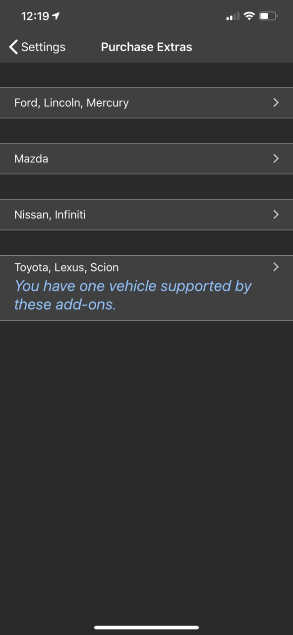

    I thought that I had that. When I go to purchase extras, it just says I have one vehicle supported by these “extras”. I do have the paid version on the app.

    Check here:

    Kiwi 3 OBD2 reader (Bluetooth and WiFi capable)
    OBD Fusion app on iOS
    Toyota 2018 add on

    Sweet! I guess I didnt have that add on. I found one and got the gauge set up. When I get to go home this afternoon I will see if it gives me a more realistic value.

    Also, it may be easier if you build a gauge, and enter the Toyota specific PIDs, Engine PIDS, and at the top (hard to see search box) enter voltage... then scroll down while looking for the ones I used.

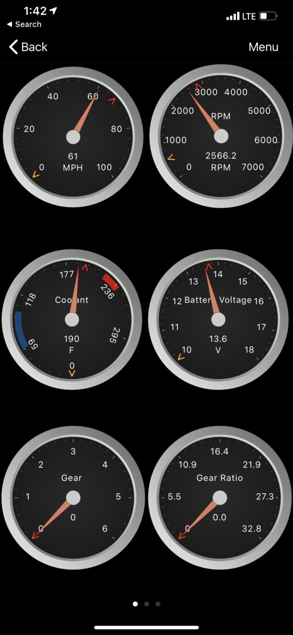

    P.S. I was hoping the “what gear am I in” would work. No dice.

    Look in the Toyota add-in, Engine section, Status of the Shift Status / 1st,2nd,3rd,4th,5th,6th,7th, or 8th
