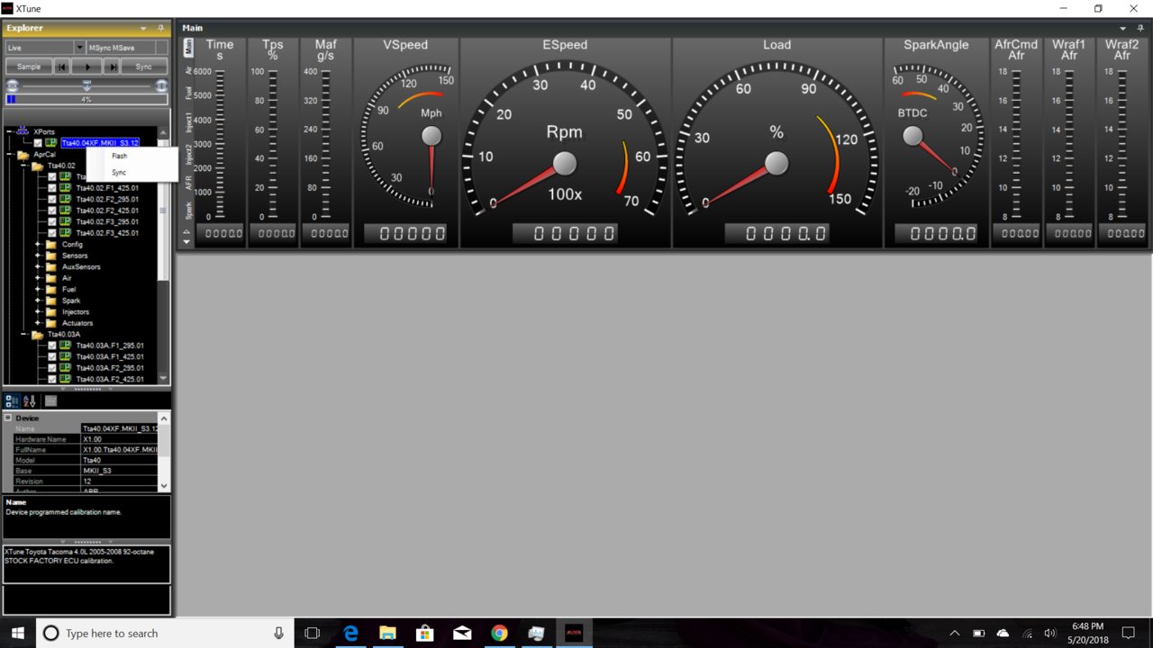

    Okay how do I get the file that is on my x-1 (Tta40.04xf.MK2_s3_12.aprCal) ( wrong file i need) to my desktop?
    I'm trying to install file Tta40.03A.MK2_s2.03.AprCal ( F3)
    Also I do not see a MRK2 kit on URD web page, only MRK3 now. How do I determine what MRK I have ?

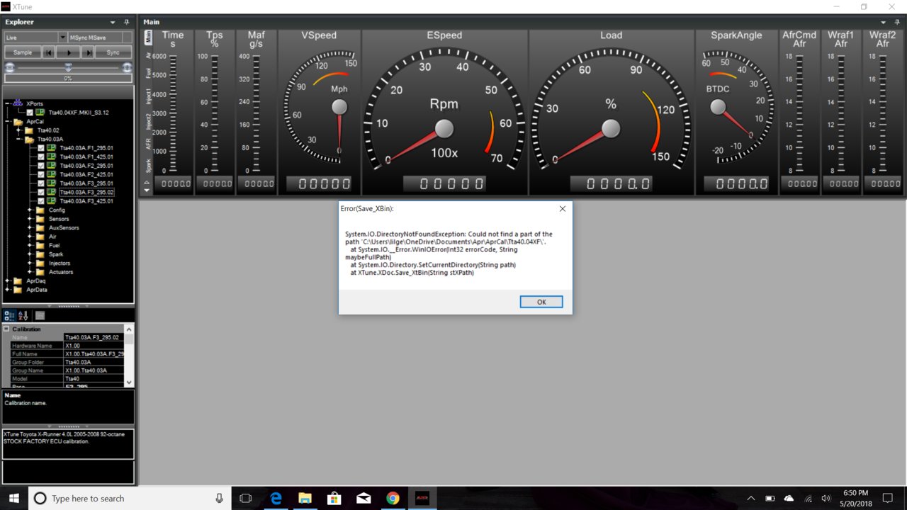

    I try to flash it and it shows 4 percent then freezes every time.

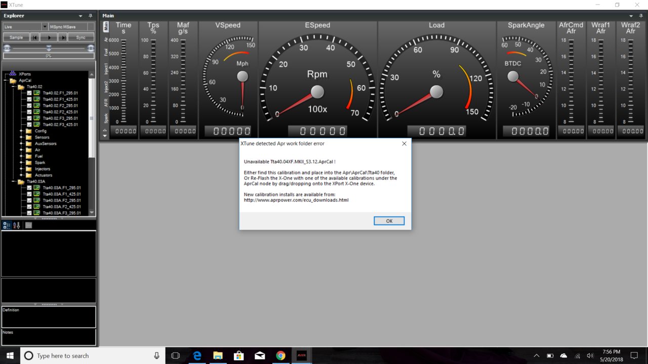

    When i try to re flash the X-1 with an available calibration under the AprCal node by drag/dropping onto the Xport X-one device I get this error :

    Do you have a USB stick? If so, add it to the USB stick. Then plug the USB in. Whenever a USB is plugged in, the X-1 goes off of that file.
    Then make sure you have the appropriate file on your X-1 program, on the laptop.

    I do have a thumb drive, I cleared the USB drive and added the file to the USB. This error it still shows, after i click okay it will show that file Tta40.04xf.MK2_s3_12.aprCal in the X port.

    I believe the USB thumb drive map/file is working. My truck is running alot smoother with it plugged in. Although when i plug in the laptop along with the USB thumb drive it wont cooperate with Xtune for live data. I'm thinking this is because of the installed map on the
    X-1 . I think I need to have a hard copy of the map/file on my computer, that is on the unit in order to change to another map/file.
