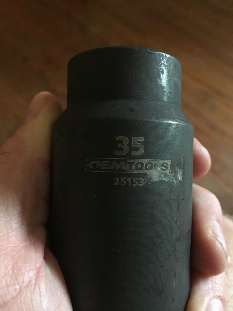

    The store i am in has 32, 34, 36, and 1” 5/8
    The 1” 5/8 is what fits the napa nut.
    So 35mm is what should fit the one thats on there?

    I guess it’s been a couple of years but I had to buy that 35 to do it
    AR15xAR10[OP] likes this.

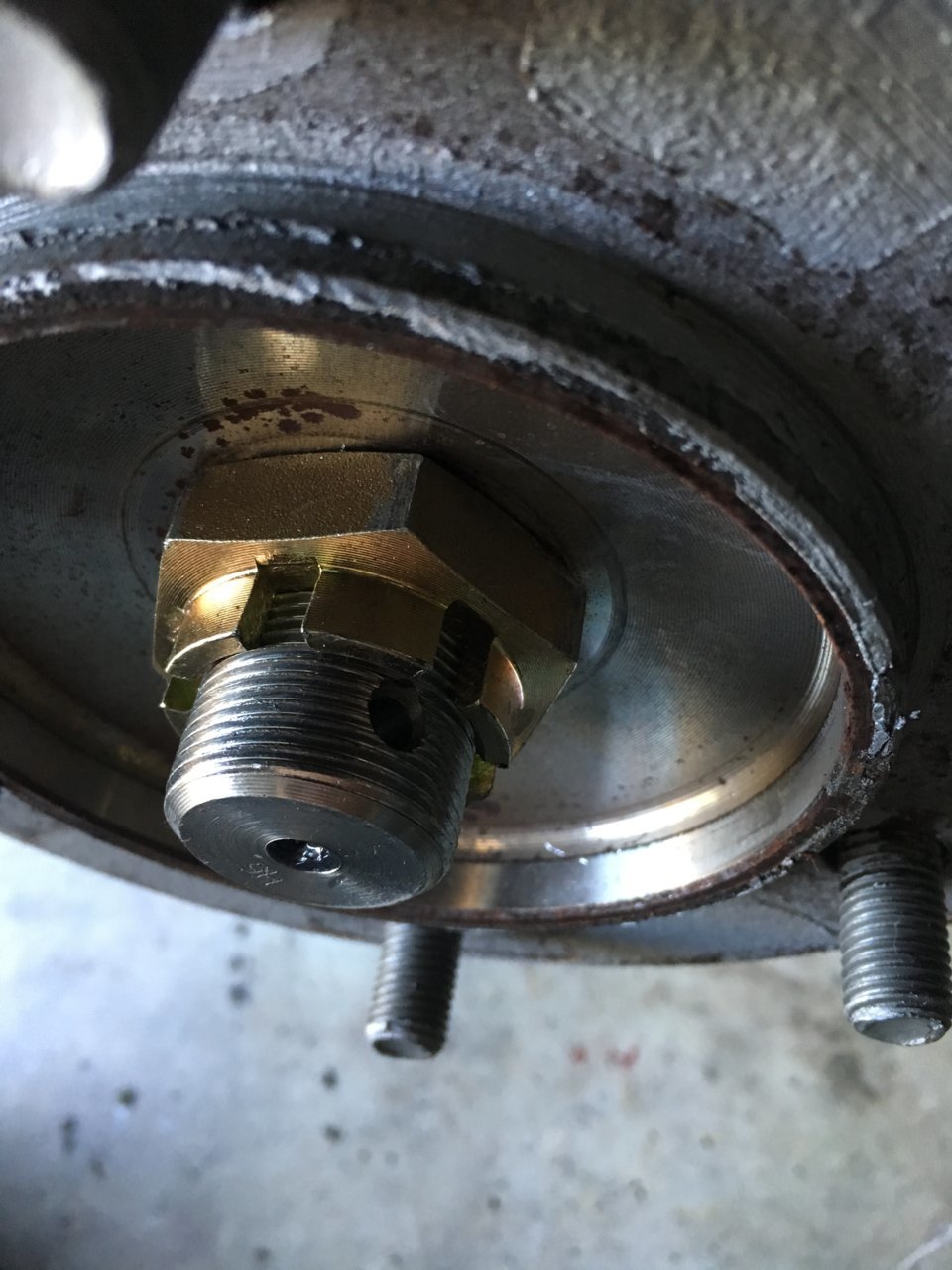

    I made a 36mm work. Did you put new cotter keys on? @68dave
    Because they won’t line up....like at all...

  17. Sep 14, 2019 at 2:34 PM
    #197
    AR15xAR10
    AR15xAR10 [OP] AR10 is 5 ARs better
    Apr 13, 2013
    #102024
    57,015
    2013 TRD Sport 4x4 V6 ACLBFTMFW

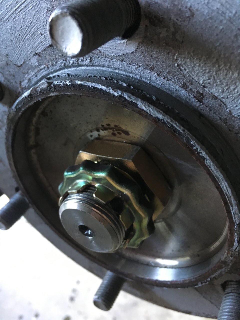

    No washer here. Only way it’ll take a key is like this:

    Sorry for late response was that at torque specs or just cranked down as tight as possible.I know I put cotter pin in
    AR15xAR10[QUOTED][OP] likes this.
  19. Sep 14, 2019 at 8:01 PM
    #199
    AR15xAR10
    Apr 13, 2013
    #102024
    57,015
    I torqued to 140ftlbs as spec designated
    greengen1[QUOTED] likes this.
