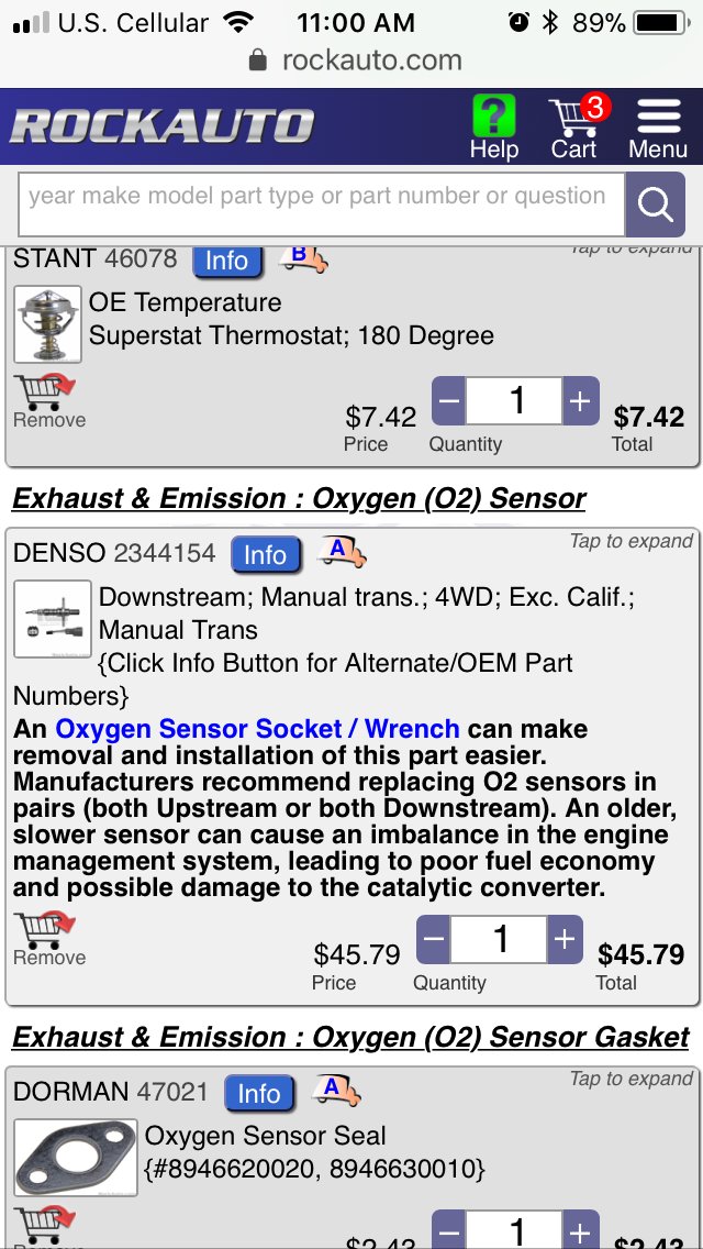

    The one i found is $45
    @Unchained 5150
    I’ll order it and a new thermostat since the temp sensor in it could also be bad.
    As for right now, i’m just going to get new nuts, stick the old sensor back in and seal the hole so i can at least drive it. I’d like to haul my dog to the groomers in this tomorrow

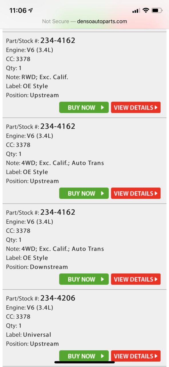

    That says excludes California so it’s for the federal emission exhaust. It also says downstream.
    I think you’re looking for upstream (was the one hanging down in the picture above both cats?)

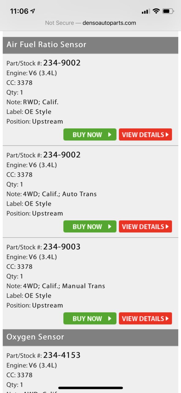

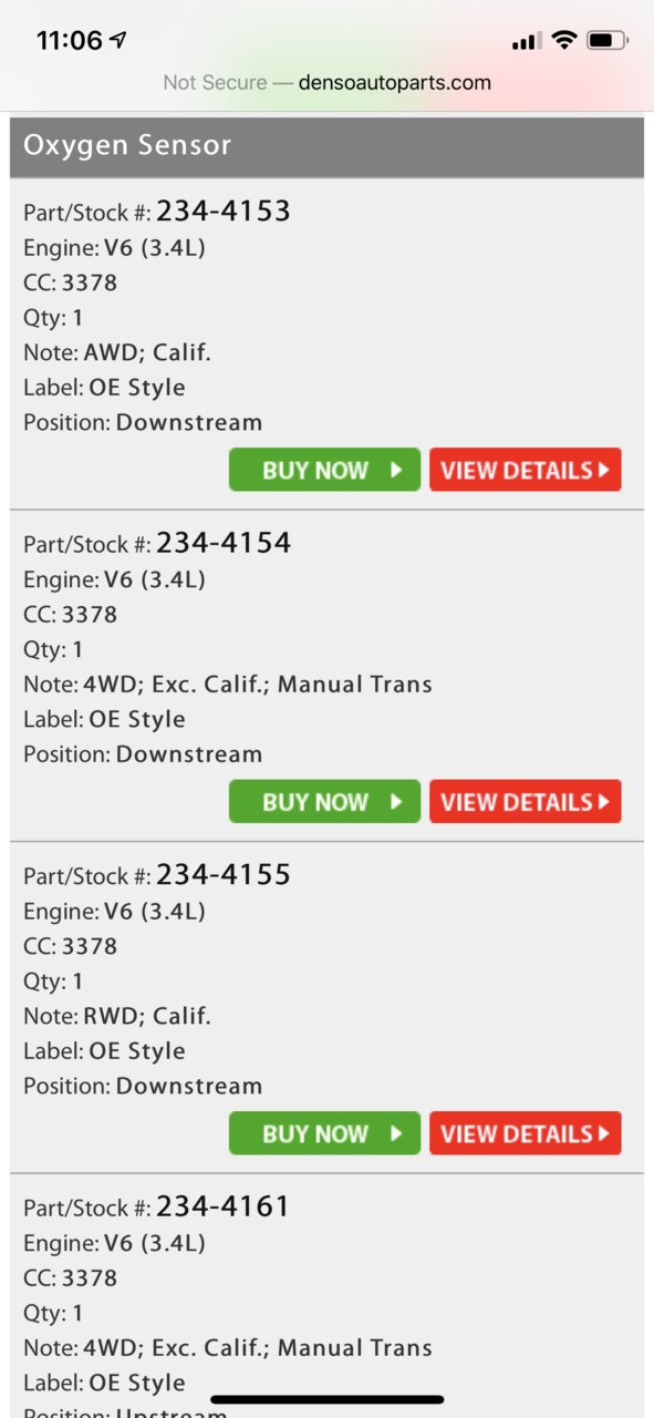

    Direct from DENSO:

    I need 2349003
    2000 calf 3.4 5spd manual 4x4

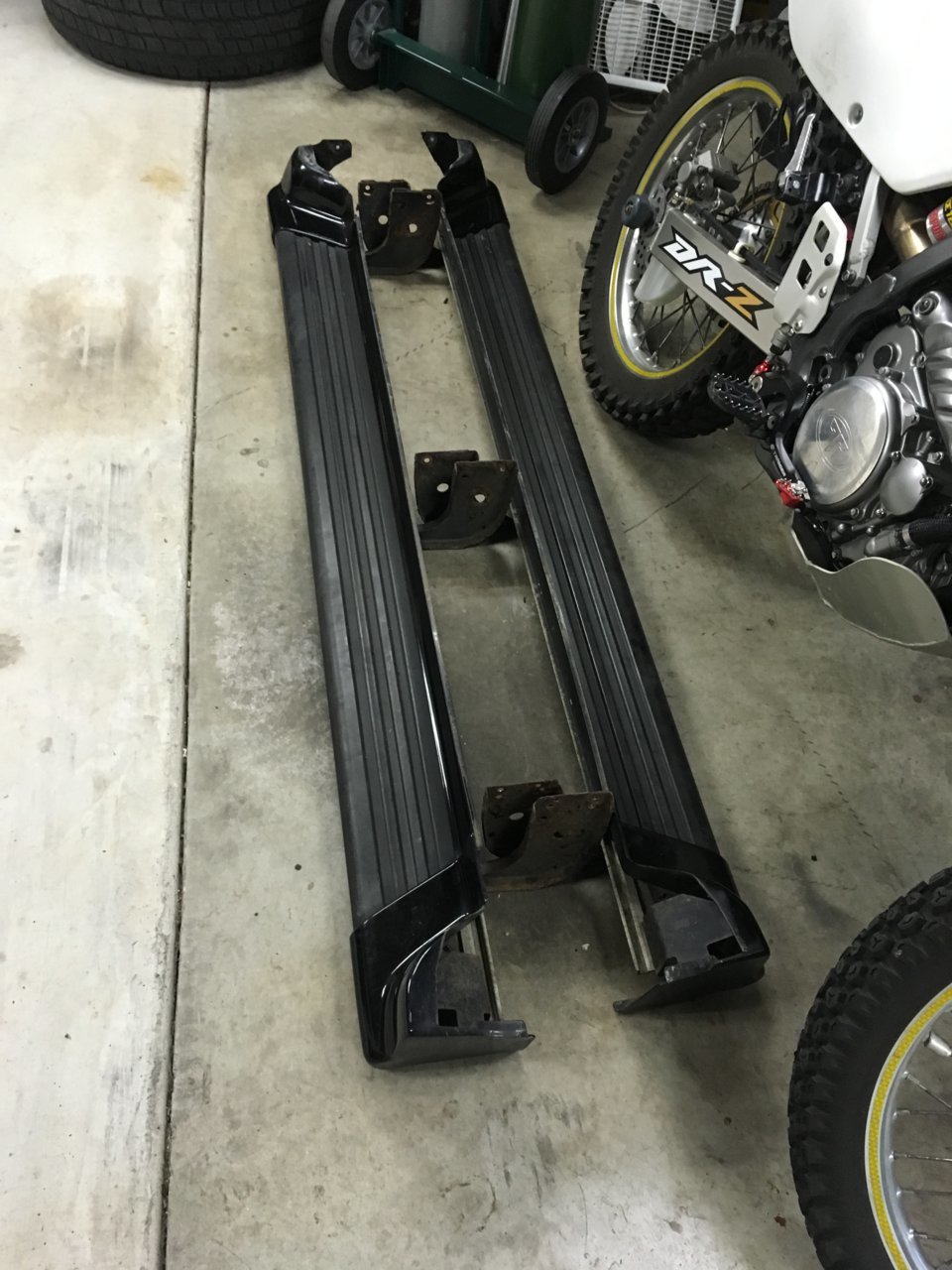

    57,015
    2013 TRD Sport 4x4 V6 ACLBFTMFW
    Also did another thing....
    Clark27 likes this.
  15. Sep 27, 2019 at 9:11 AM
    #315
    AR15xAR10
    AR15xAR10 [OP] AR10 is 5 ARs better
    Apr 13, 2013
    #102024
    57,015
  16. Sep 27, 2019 at 10:01 AM
