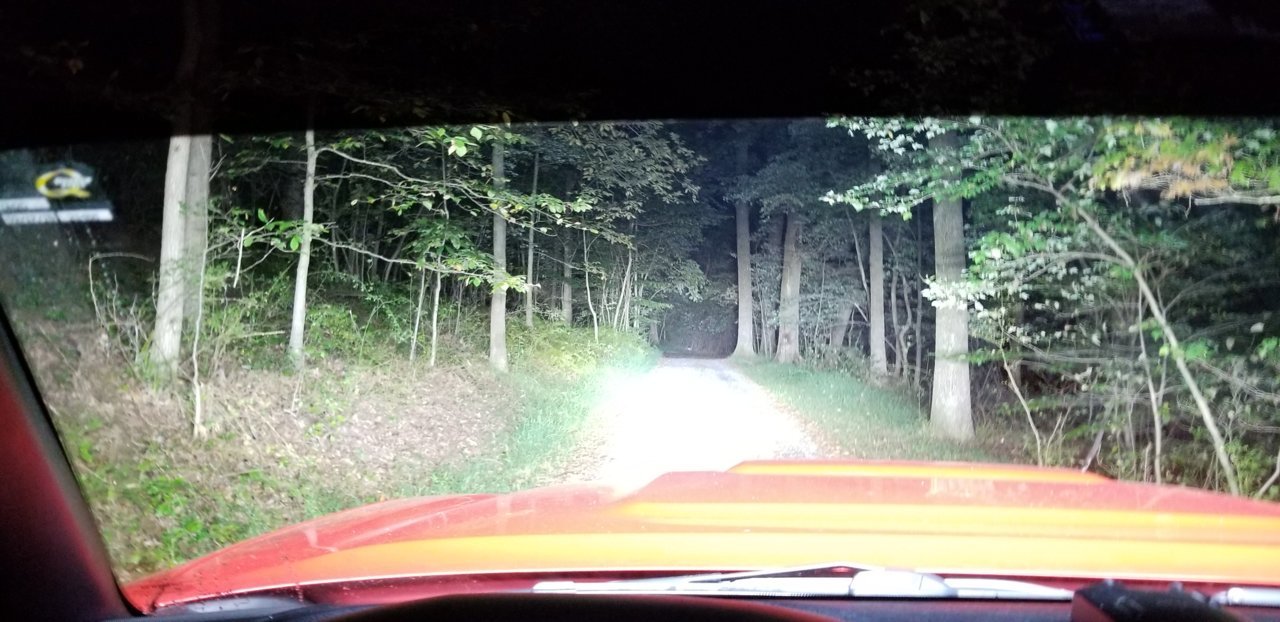

    Well, if you want value, you can't go wrong. For my money, those will be what I put on whatever I buy to replace my Taco. Sure, I'd like to be able to afford those expensive brands but I'm beyond name recognition, and just don't have that kind of money.
    You can buy two light bars and side shooters for what one high end light bar costs.
    Will those high dollar versions perform better? Probably. They better. Will the Auxbeams perform poorly and be inadequate? Absolutely not! None of us desert race and if you, or I did, then I'd say spare no expense. But for trail driving, there just isn't any need for that.
    This is pitch black, no moon, both Auxbeam light bars and my high output led headlight leds from @XenonDepot . You decide. :cool:
