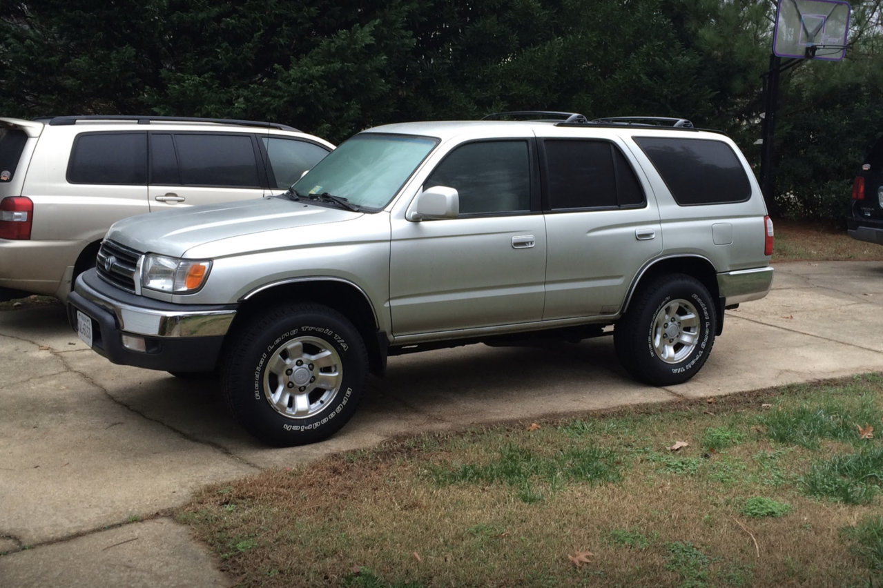

    She’s definitely a little saggy in the booty department:

    I have not read thru the entire 27 pages. Why the Moog springs on the rear, it did not appear to be sagging.
    Are you happy with the KYBs? Here’s my 2000, pretty much mint but need new shocks. I did just dodge a pink milkshake, radiator water pumped into the tranny. I caught it within in minutes and saved the tranny. Will be adding and external tranny cooler in the spring, bypassing the radiator.

    The moog springs were $36 a set. Cant beat it. The KYBs in the rear are great. No complaints. Thing rides like a dream for its age and mileage. The springs and shocks i replaced were the originals at 230k and they bounced bad enough to make the vehicle lose control at any kind of speed. So they were replaced for safety
    i highly recommend by passing the radiator.
    on my tacoma, i continued my tranny cooler in series with my radiator and the aftermarket cooler so that i’d still have the warming of the trans fluid by the engine coolant in the winter, and the additional cooling capacity in the summer. But second gen tacoma radiators are almost bullet proof compared to 3rd gen 4runner radiators. So i dont blame you.
    fortunately, my 4runner is a manual and cant have any milkshake problems :anonymous:
